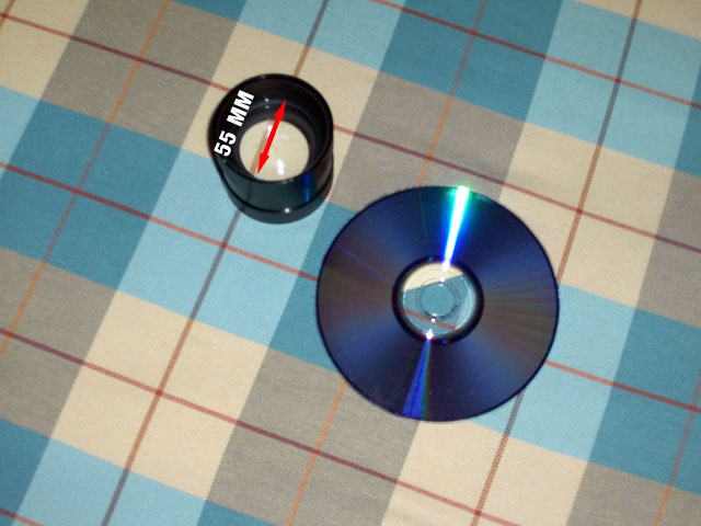

I bought this objective / lens for $2 lol few months ago... It is projecting the pictures on 5" Psone screen very sharply, however I' m not sure, if it will project 7" Lilliput.
I mean can I get sharp edges when using this objective and 7" screen.
Actually I will try to understand via acetate paper but I don' t have time to find acetate printing paper until weekend. So I need your opinions / inputs 😉
Also, is there any way to understand / find its focal length ? ( there is no info / text on it... )
You can find its dimensions on the attached photos.

ok guys I think I found some useful info. Mine is probably same with this one;
http://www.braun-phototechnik.de/E/Products/Accessories/objektive.htm
So I am very very very very lol happy. Because I saved some $$

BRAUN Ultralit PL 2,8 / 55 mm MC
A wide-angle lens for the projection of miniature format and half-frame slides or for cases where a large projected picture has to be achieved at a short projection distance.

IMO, if my calculations are correct, either
this lens has a very wide field angle (in
your case of projecting of 5" Psone screen
it will be at least 96 deg.) or you got its focal wrong.

thanx jolly for the info, I' m thinking this lens is a bargain 🙂 and it is probably a triplet lens. btw how did you calculate its focal length ? I did a research on google but I couldn' t understand those numbers 😛
