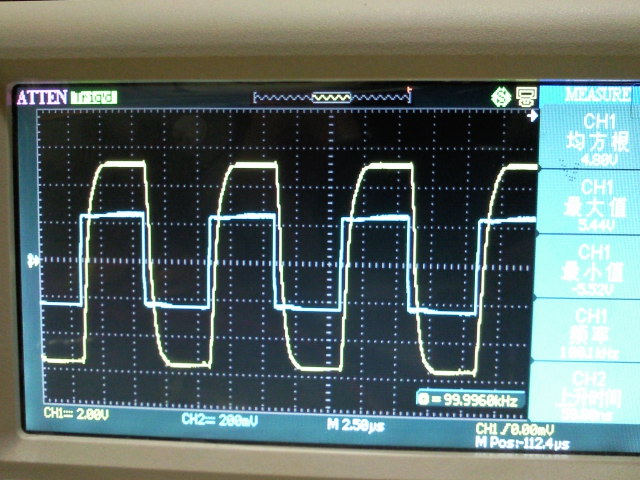

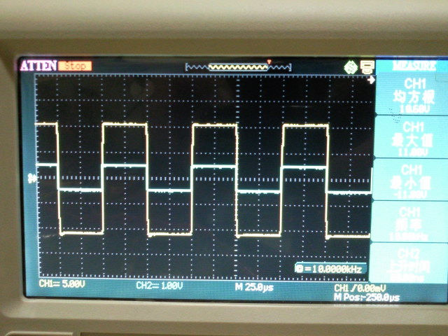

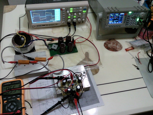

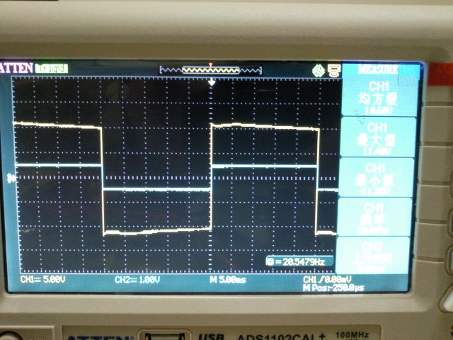

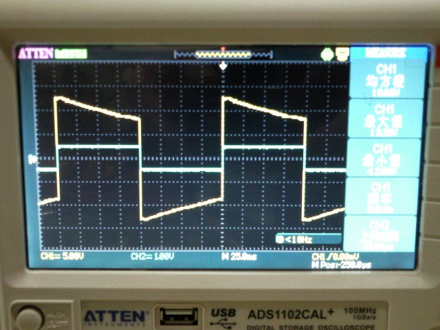

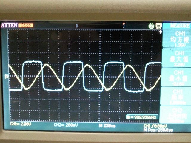

As I have wrote previously, the problem has been fixed with a low hfe B649AC as the lower half driver transistor. The amp has a gain close to 20x, it maintains the gain 10x at 1MHz.
Attached are the photos.
Set up
Low Freq Square Wave
High Freq Square Wave
Set up
