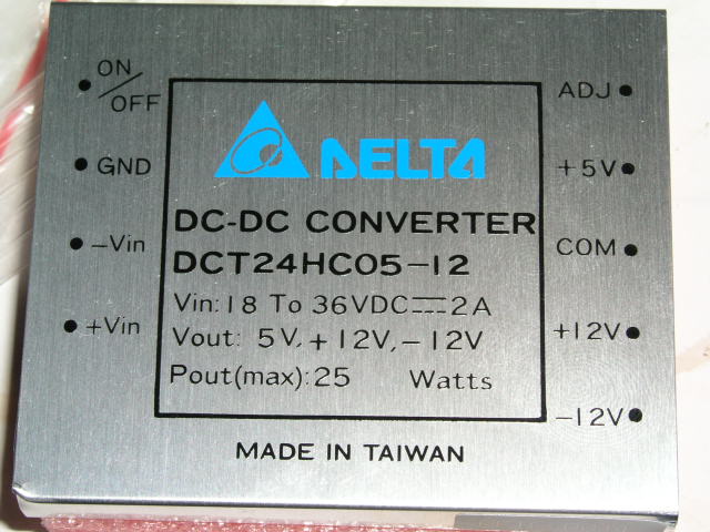

Dear all,
today my friend sent me one DC to DC power supply.
It had 25watts power output. will really enough for DAC use.
They said that use in the DAC was quite good.
Can anyone had experience!
pls advise!!!!
thx
thomas
The DC-DC converters I have used are mostly for digital circuits. I really can not see they will be any good for analog audio stuff; they are designed mainly with high efficiency and high power density in mind. Similar to switching power supplies problem, those high frequency switching elements inside can be a headache for audio circuits.
Delta is a very famous company for switching power supply, UPS, etc.
