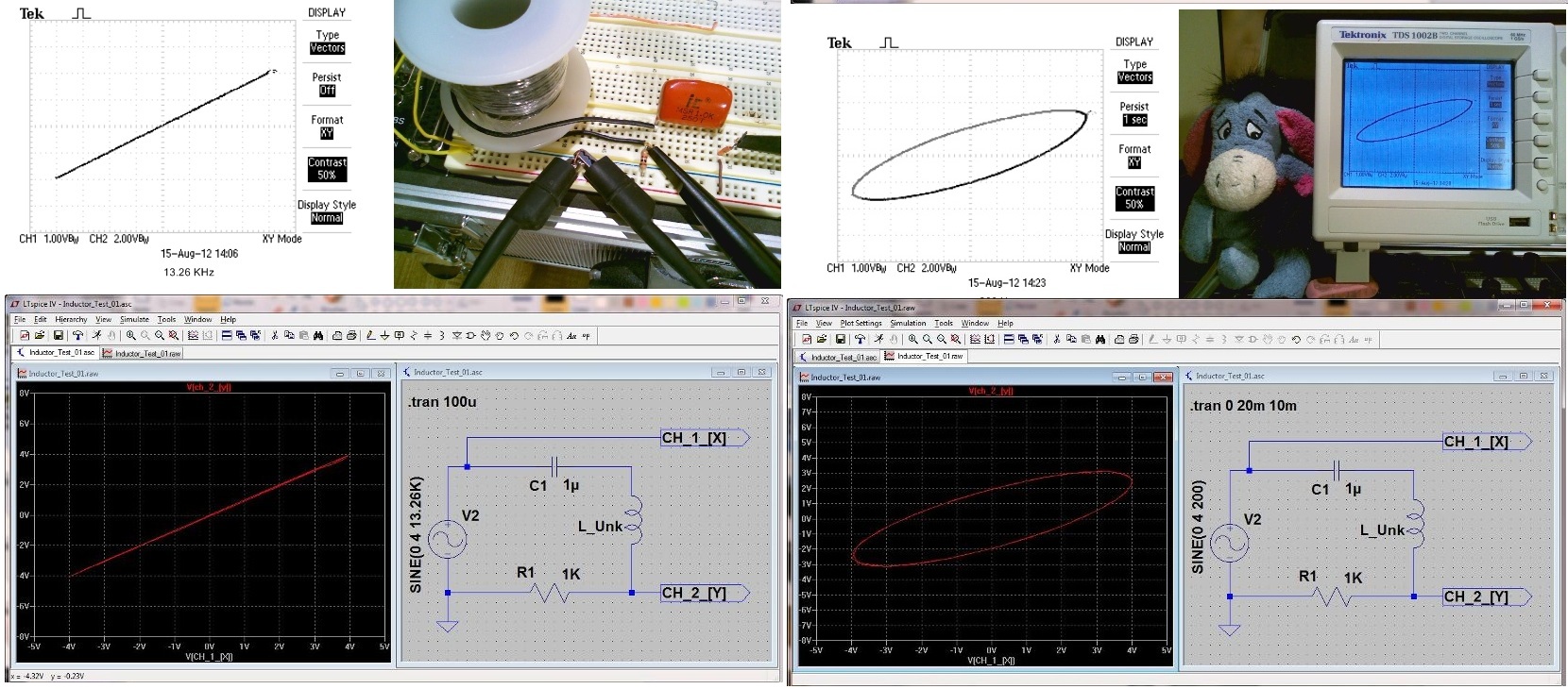

My trusty Lab Assistant used the X-Y mode on the Tek TDS 1002B to plot the V-I characteristic of a series RLC circuit at two different frequencies . . . and determined that the roll of black hookup wire has an inductance of about 49 uHy.
Other comments:
  • The "MEASURE" feature on the TDS 1002 doesn't work with X-Y mode so you can't show frequency on the X-Y display;
  • The Tek "OpenChoice Desktop" program is a nice way to grab an image of the 'scope display;
  • The Windows "Snipping Tool" is an easy-to-use screen-capture program;
  • The IPEVO P2V webcam can focus down close enough to inspect the plating on an IC pin.
