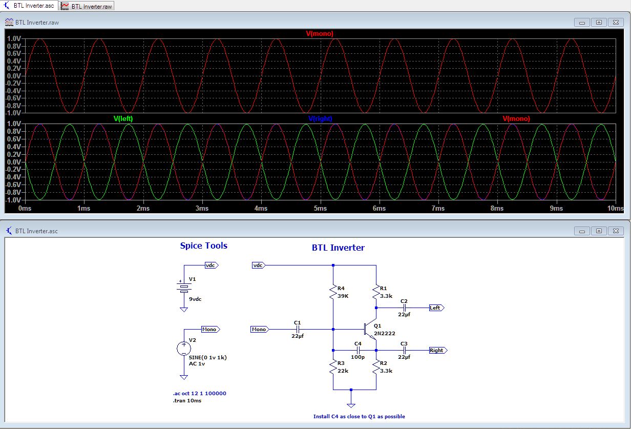

Simplest Ever Bridging Adapter for Amplifiers
  • BTL Inverter.asc
    BTL Inverter.asc
