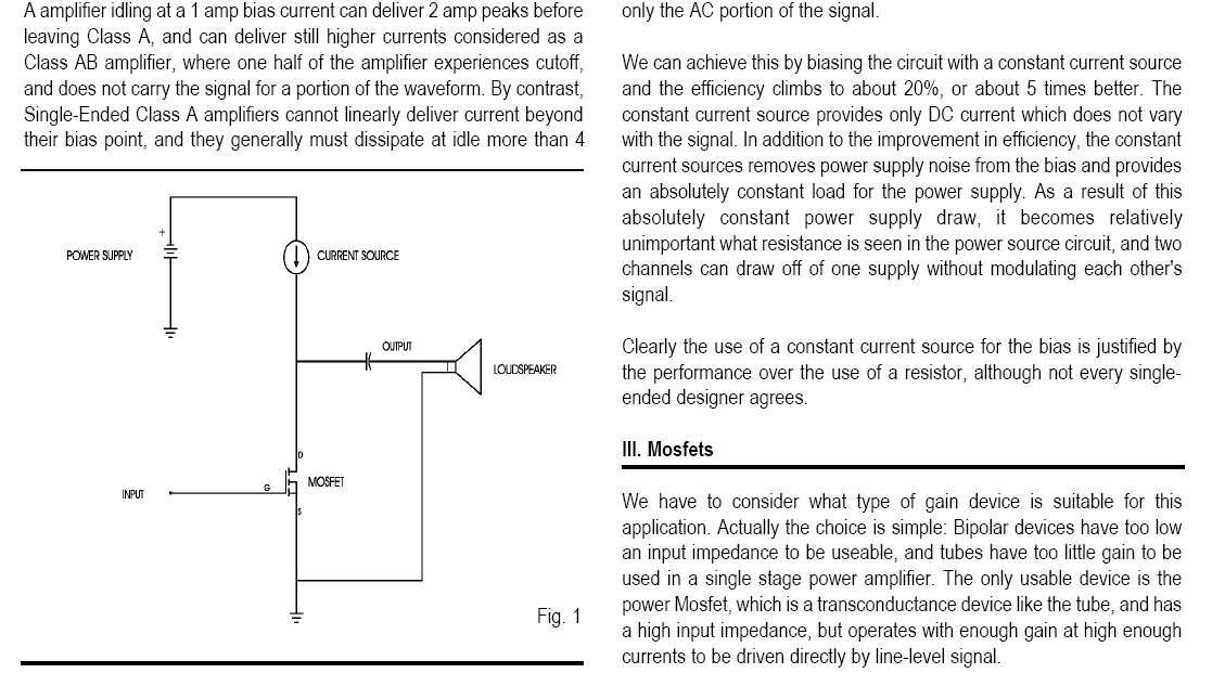

About an op-amp as an input stage. If the feedback is taken from the output of the amp, won't then the op-amp try to compensate for some of the distortion then?
I'm hoping for an oscilloscope for christmas so I can finally start looking at the output of my amps and getting some THD values 😀 If I make an amp like this on a breadboard, will measuring distortion give an accurate value? Or do I have to solder it in order to get valid measurements?
If you try to drive an ordinary 8ohms speaker at -20dB (average level ref maximum power) to avoid clipping then you will just about have to clamp the speaker to your ear to hear it. Am I allowed to exaggerate slightly?

Thank you for the replys, I have a better understanding now 😀
I haven't learned about fourier analysis and calculating THD values yet so I don't know the math behind it, but are you saying that "tuby sound" and "micro sound picture" can't be expressed mathematically? I found it really attractive to think of a distortion meter that could directly and mathematically compare one amp to another 🙁
A little off topic here. Could any of you link a class AB design that is allmost as simple as the class A design I linked in the opening post? An op-amp input stage would be preferable and I really like mosfets. As much as I found class A design fancy, the power dissipation and extra demand on the transformer isn't that appealing 🙁 I was thinking of looking into class AB designs.
I would say, math reflects general features, macro picture, but not the complete truth. Math is based on the model, and the model is definitely simplified compared to all details of the phenomenon (sound reproduction).
Additional advances in math is possible, but, again, up to definite point only, it will not explain all the details again.
I'm really curious about having an op-amp as an input stage with it's feedback taken form the output of the amp. I was under the impression that op-amps usually have great specs (PSRR, CMRR etc) compared to many descrete amplifier designs. Also with the feedback taken from the output of the amp I can't understand why this won't greatly reduce distortion.
Another question. In my next design I wan't to use a voltage regulator to reduce humming. If I then connect the gate bias resistor directly to the output of the regulator, won't this greatly increase the gain aswell? I remember doing this the first time I made the amp and the gain was insane compaired to after I connected the resistors to drain instead. One problam was that the operating point would shift dramaticly if the voltage or the bias current would shift, but with a regulator the voltage shouldnt change and neither should the current.

Does LM317 have enough bandwidth?
You said don't mind component value so I wont, but in my experience those switching MOSFETs have horrible non-linear gate capacitance, making simple circuit difficult to sound good.
Not sure about the LM317's bandwidth. It doesn't have to be a switching mosfet. The circuit drawing just showed the design not saying anything about what kind of components that are used, the LM317 represents an adjustable regulator. I later got that a regulator might not be the ideal current source so I then wanted to assume an ideal current source instead just so I could understand what was "flawed" about the actual one-stage mosfet output. But I understand now that it is the unlinearity of the mosfet that's the bottle neck, but that's why I'm wondering how a op-amp input stage with the feedback taken from the output of the amp won't fix a lot of this.

I've been wondering about this. I've been reading about mosfets at university and I think I have a decent understanding of them. Take this class A amp circuit as an example:
http://i50.tinypic.com/10hugp5.png
Don't mind any of the component values. When I look at many class A amp designs out there they seemed to be littered with components and I often see a minimum of 5 transistors used in all sorts of ways, but I'm wondering why? I can see some problems with the circuit I linked though like the output cap and current source, but if we assume an ideal output cap and an ideal current source, what is flawed with this design? What kind be done to further increase the quality of the sound?
