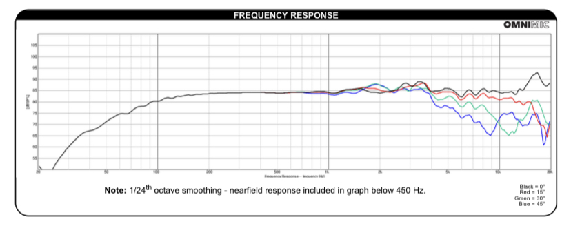

Btw, from what I recall, the RS100 is a fine driver that reaches just as high as the TC9 but being aluminum has a bit of tizz sound - some people may like it as more “airy” sounding. It was the RS100 P (paper cone) that did not go as high as the TC9 I think. RS100 works well in a 0.4x Karlsonator or an XKi.
RS100-8 FR curves:
