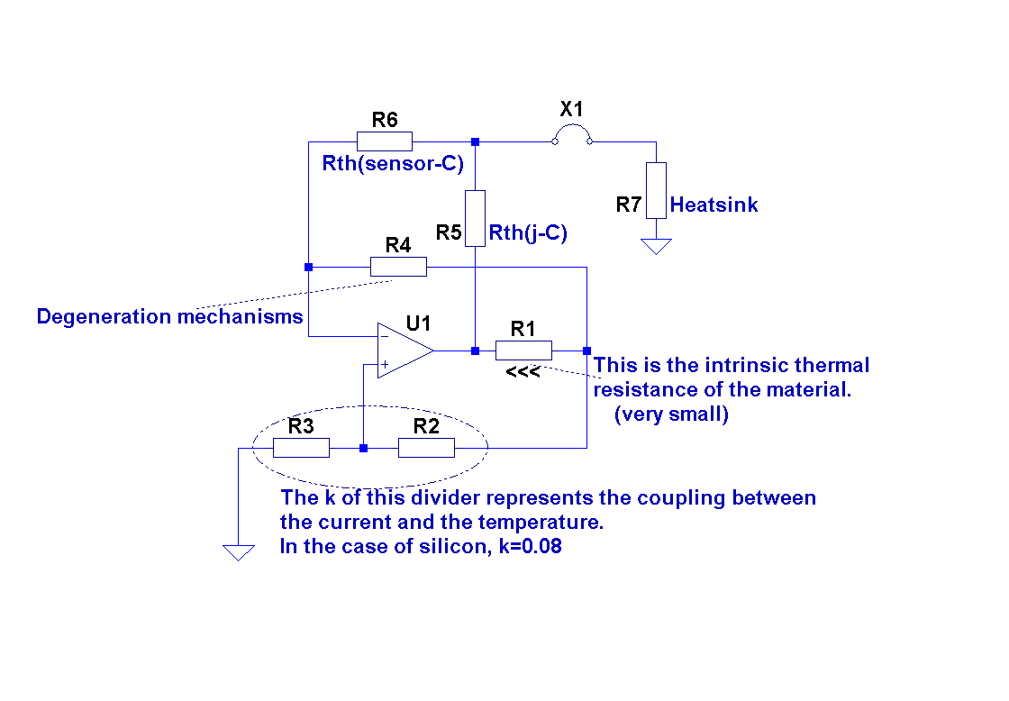

Here is a simplified static model of the situation:
When X1 is closed, the NFB of the system is decreased, and if it falls under 0.08, the positive feedback inherent in the transistor dominates, and the system becomes unstable, unless there are other means of adding NFB, like degeneration resistors.
This means that a system stable with a small heatsink could go into thermal runaway with a larger heatsink.

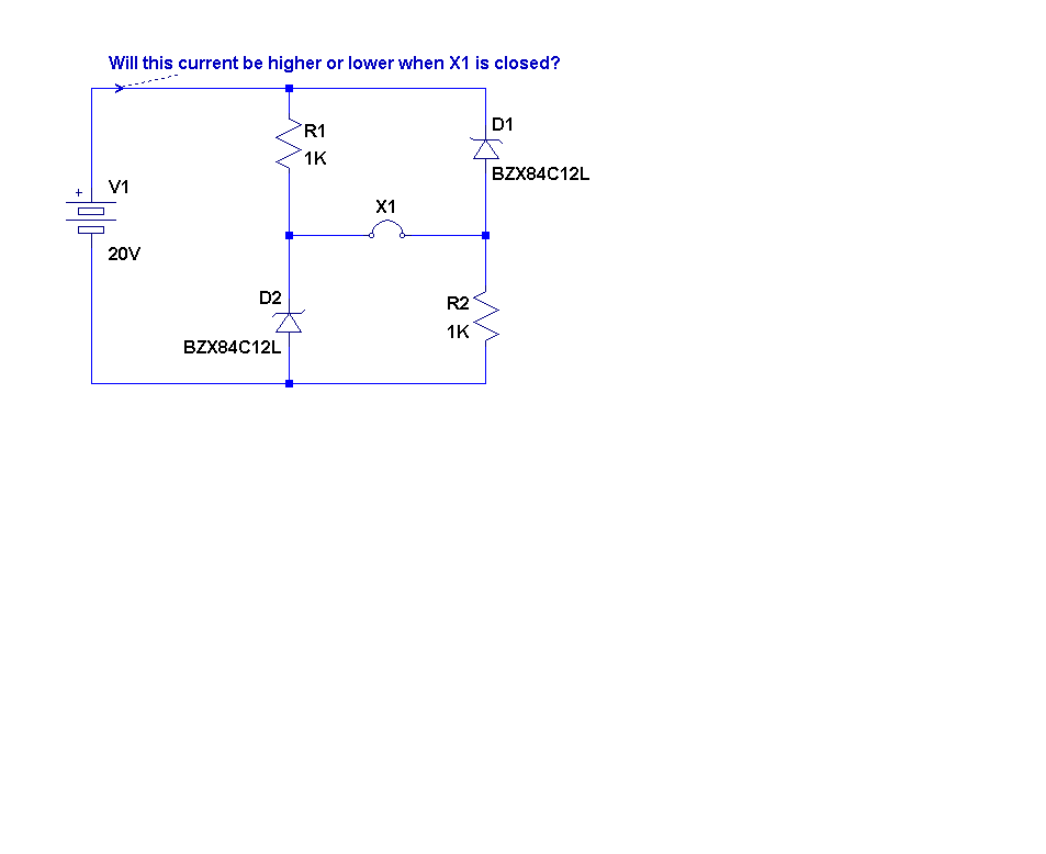

Here is some training "à la Lewis Caroll", to try to believe impossible things:
It is.
Intuition is a good guide.
Sometimes.
Yes, Elvee has put his finger on the problem.
There are two mechanisms at work.
One is the internal thermal resistance which becomes dominant if the heatsink is too big. The other is the problem of practical thermal compensation. This problem is really simple to visualize - the definition of an 'infinite heatsink' is that the heatsink temperature does not rise no matter how much power is dissipated. By definition, this means that any rise in die temperature casuses NO rise in heatsink temperature. If so, an external thermal compensation element looking at heatsink temperature as an indication of die temperature will of course see no difference in temperature to compensate, hence result = thermal runaway.
In practice, this will occur with quite realistic sized heatsinks if the thermal resitances from die (of transistor) to die (of the thermal sensor) is sufficiently different at any given boundary. Example which is close to the 'infinite heatsink' thought experiment, is a huge heatsink on which you have a active element and compensation element, with Rth high with respect to Rth of the heatsink to air. The heatsink will be an attenuator and inertia component from active element to NFB element. While you can battle attenuation with gain, you cant make time go backwards - the heatsink imposes a time constant into the control loop which may be longer than is required for destruction by runaway at some operating point- hence, there is danger of destruction.
