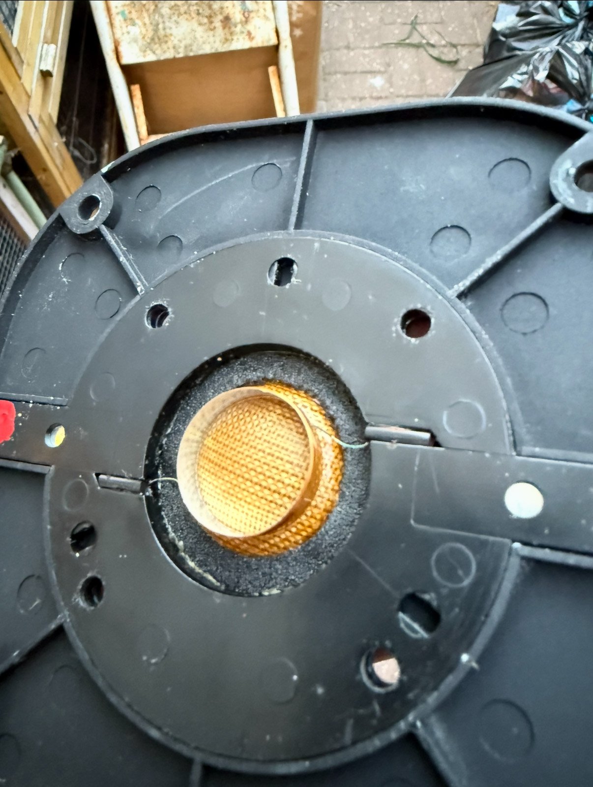

So the bottom line is that I'm out of luck. However, I'm also not entirely sure what's wrong with them. People go straight to trying to source a replacement when a tweeter 'blows', but I was wondering if there's a way to trouble shoot what's actually gone wrong with them, and possibly to repair them?
I have managed to locate this spec sheet for the tweeter: http://www.acoustica.org.uk/impulse/images/TC90K.PDF
I should also add that it presumably isn't the crossover and is the tweeter, because I swapped the faulty one(s) to the other cabinet, and the problem followed.

Absolutely a blown tweeter can often be repaired. I've done it many, many times. Everything from Yamaha NS-1000M beryllium tweeters to random Wharfedale domes.
Unless you have a long-term thermal failure (too much power on a consistent basis which truly 'cooks' a VC), tweeters usually fail for transient events, where the lead-in wire vaporizes leaving the VC (voice coil) intact. Such failures can be repaired with a bit of microsurgery- either unwinding one turn or carefully re-attaching and soldering a new lead-in wire.
check for continuity, around 6 ohms.
remove 4 screws holding faceplate to magnet, then inspect tags, voicecoil etc.
post pictues.

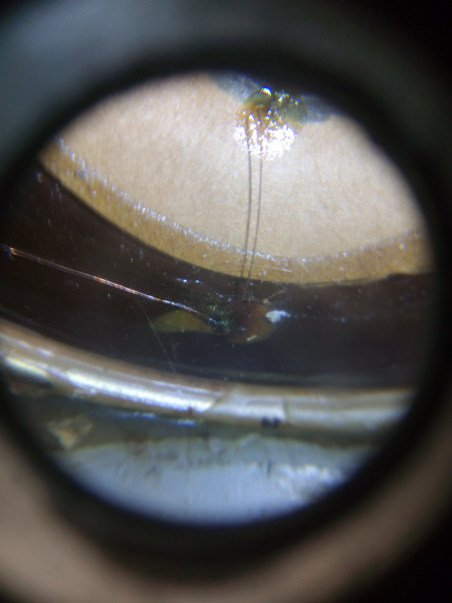

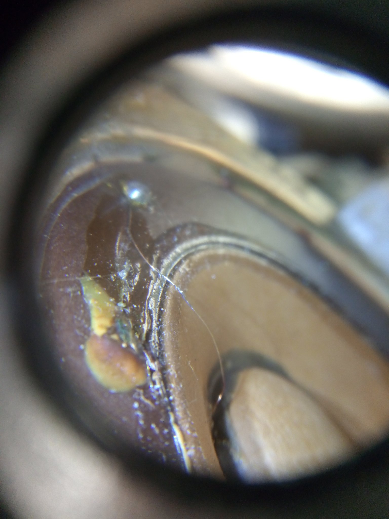

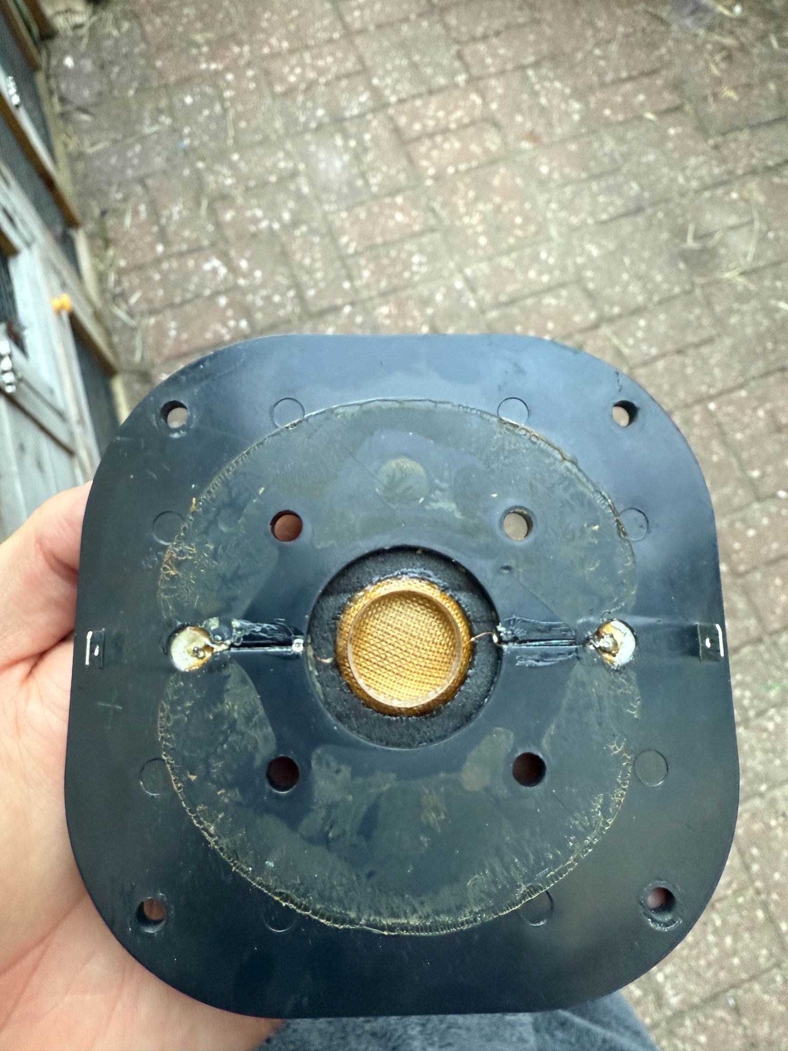

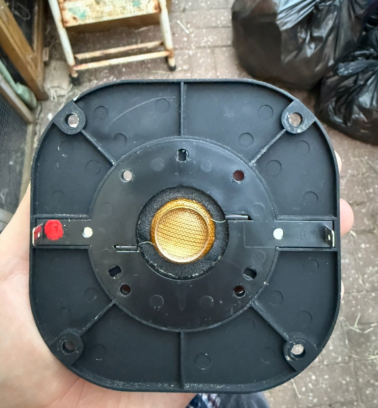

I've ordered a multimeter. In the meantime, here are some pictures. Having taken a look, the one that's not working seems to be missing a plastic plate that goes over the wires compared to the working one, and it also appears to have already been repaired in the past.
As I say, there is also a spare with a tweeter that isn't working; I can't currently get the screws off of that one because two of them have stripped, so will have to find a work around.

Exactly as you would expect. That reading (OL=over limit) means that there is an open that you must find to repair. For me, this is surgical stuff but with care, can be done. You have nothing to lose, I'd say. You might even try probing in a few spots around those lead in wires with a toothpick and see if you get lucky. Magnifiers help me a lot with such stuff, and of course great lighting.
I'm pretty sure Focal still repairs these TC90Ks, but you'd have to contact them to find out for sure. The surrounds love to disintegrate on these tweeters. That's another issue to expect.
It would be wise trying to find a used donor so you have something to fall back on. Just make sure the flat surround is in good shape and doesn't sit tilted in the gap. This is another common failure on these tweeters.
Doing this type of surgery on any tweeter isn't for the inexperienced. The VC gap is very tight on these things. You have to get the dome placement just right in terms of height and radial center. Making sure the VC isn't out of round is yet another challenge if you decide to only replace the VC itself.
I managed to repair a TC120K for someone by making a fixture that locates the VC accurately for somewhat of a guaranteed outcome.
Reactions: LMT50
I recently repaired a tweeter from a vintage KLH Model 6 that produced no sound yet measured close to 900ohms. Intrigued, I pried away the protective screen to examine the lead-in wires and found an attachment point that had annealed or carbonized producing the high resistance. It looked very much like instance in picture 3 above....the blackening under the adhesive that secures the wire. This may be where the open is, and not the VC. I was able to affect a repair through cutting the wire on either side of the damage and splicing them together. No idea what kind of power it can handle but at least it's working again.
It might be worthwhile to check the continuity on either side of these points by gently scraping away a bit of the enamel and measuring before giving up on them.

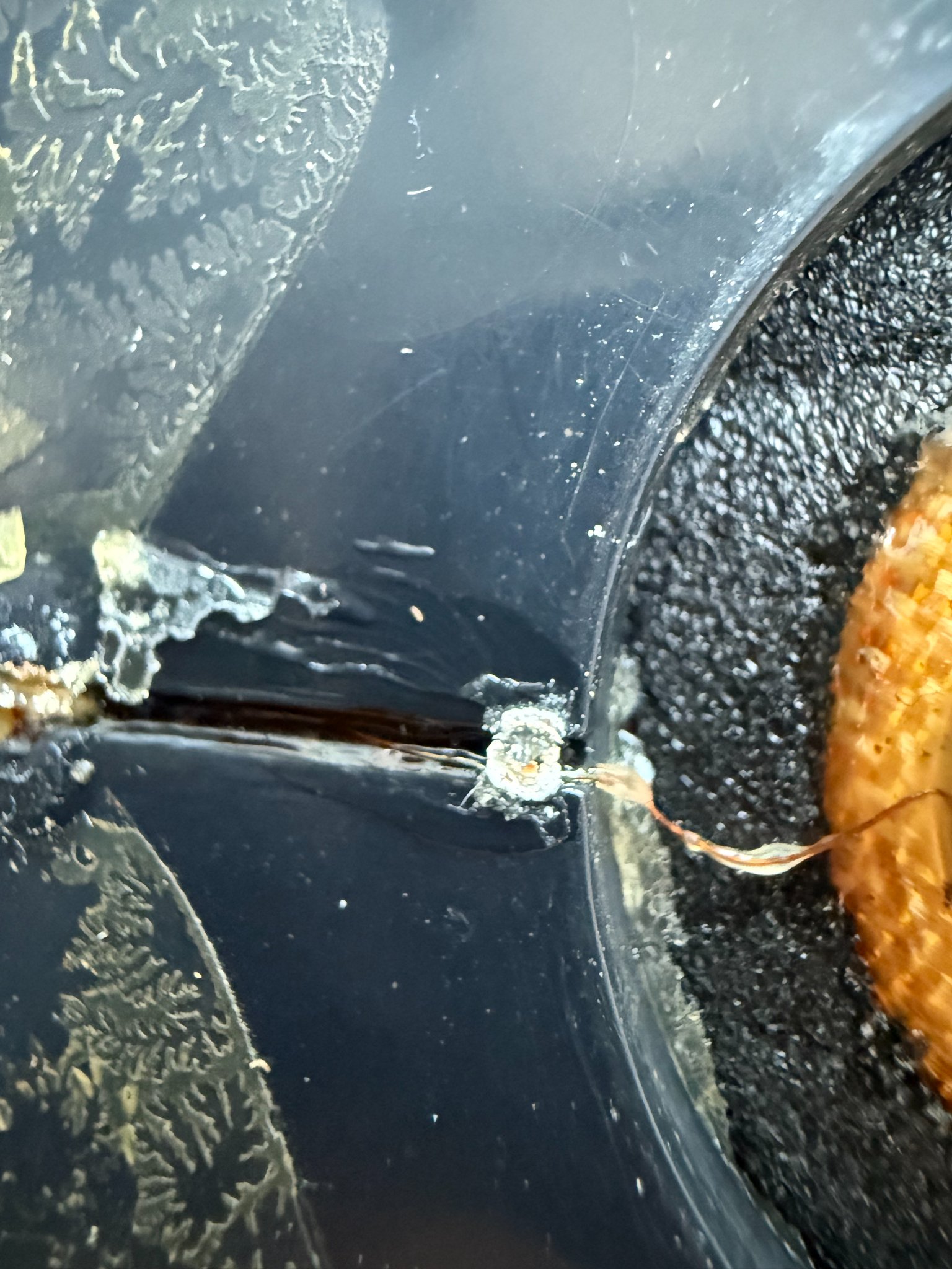

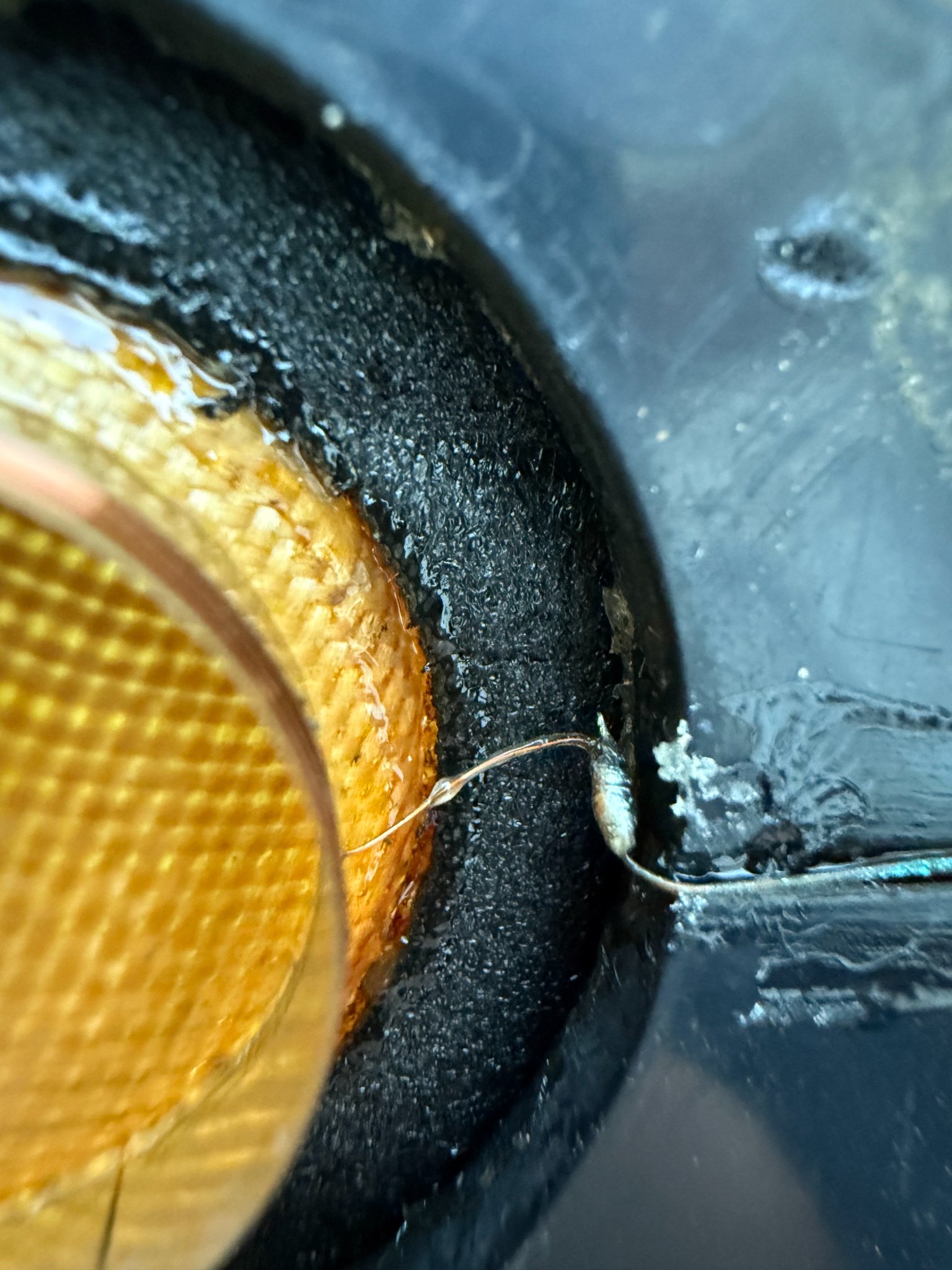

View attachment 1460306View attachment 1460307
This is interesting, thanks!
Can you explain again where I should be testing continuity? Which part of the enamel should I be scraping away? Do you mean within the valley leading to the connectors?
