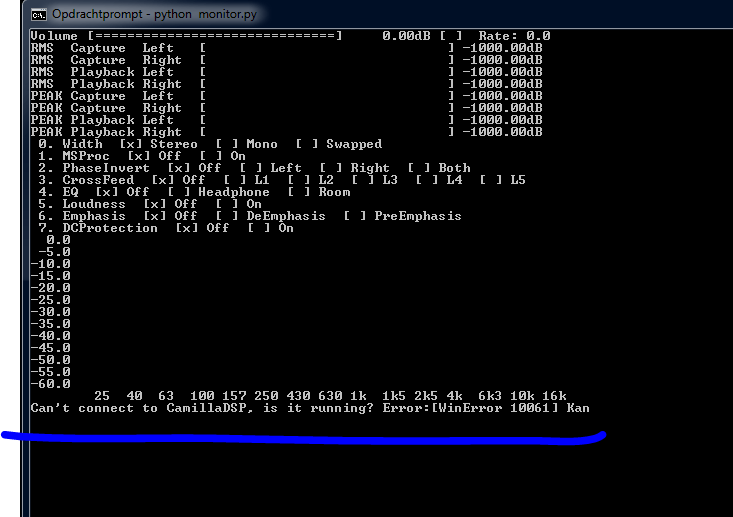

I am trying to run it from a windows machine. The first error was about the missing module curses. I think a replace the with a
windows pip install windows-curses.
No i am getting a error with the following traceback;
C:\Users\Marcel\CamillaDSP-Monitor-main\CamillaDSP-Monitor-main>python processing.py
Traceback (most recent call last):
File "processing.py", line 12, in <module>
proc = subprocess.Popen(cmd, stdout=subprocess.PIPE, stderr=subprocess.STDOUT)
File "C:\Users\Marcel\AppData\Local\Programs\Python\Python36\lib\subprocess.py", line 709, in init
restore_signals, start_new_session)
File "C:\Users\Marcel\AppData\Local\Programs\Python\Python36\lib\subprocess.py", line 997, in _execute_child
startupinfo)
FileNotFoundError: [WinError 2] Het systeem kan het opgegeven bestand niet vinden
Do you have any clue?

Thank you for trying!
I don't know Dutch but seems the error is related to subprocess.
You need to replace this line with the actual command on Windows.
So on windows it it not "./camilladsp" but something like "camilladsp.exe".
After all my script assumes a Unix-like environment (I developed it on Mac. Some user reported it works nicely on Linux), and to make it runs on Windows requires some (minor) tweaking.
Hi i managed to get the wright screen.
I had to reply it with camilladsp and using a double backslashes in the line.
When it is starting up, it is showing websocket not connect and with the following error.
I suppose i dont have to manually start a websocket .py programm and that camilladsp i automatically started
by your script? Maybe i am wrong.

Did you setup your audio device correctly? If you run "camilladsp.exe setting.yml" and "camilladsp.exe spectrum.yml", what happens?Hi i managed to get the wright screen.
Remember you have to set up input/output device in those two files --- the readme mentioned that step.
To learn how to setup camilladsp input out device, refer to official docs (links in the readme as well).
Once you can successfully run those two files, You should be able to run the program. If it still has issues, follow the following steps:
1. in task manager make sure you don't have camilladsp running when running the script
2. execute the script, and check if you see two camilladsp tasks in the task manager
3. check and see if your windows firewall block the network connection of camilladsp or the script. unblock them if that's the case.

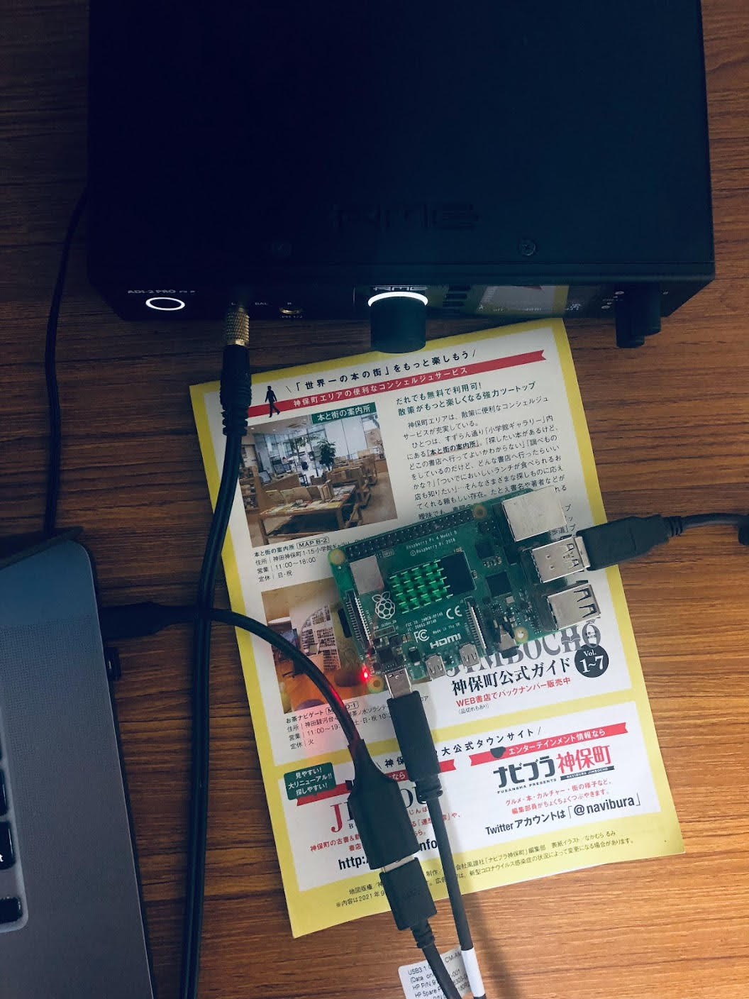

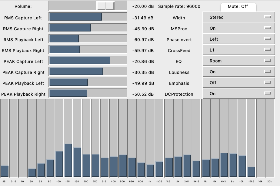

We now have a sister project, CamillaDSP-Gadget, available from https://github.com/Wang-Yue/CamillaDSP-Gadget.
You can now turn your Raspberry Pi 4 as a UAC2 gadget, and use it as a DSP processor. When connecting your Raspberry Pi to your computer, it shows itself as a USB audio device. You can then play your music from your computer through the Raspberry Pi, who processes the audio, and sends it to your DAC finally. The RPi4 is powerful enough to be fully able to process audio realtime in 768kHz/64bits!
Both projects also include a new GUI program!
Now you can watch the spectrum bar dancing for hours while appreciating your music!
See how it runs with a RME ADI-2 side by side:
