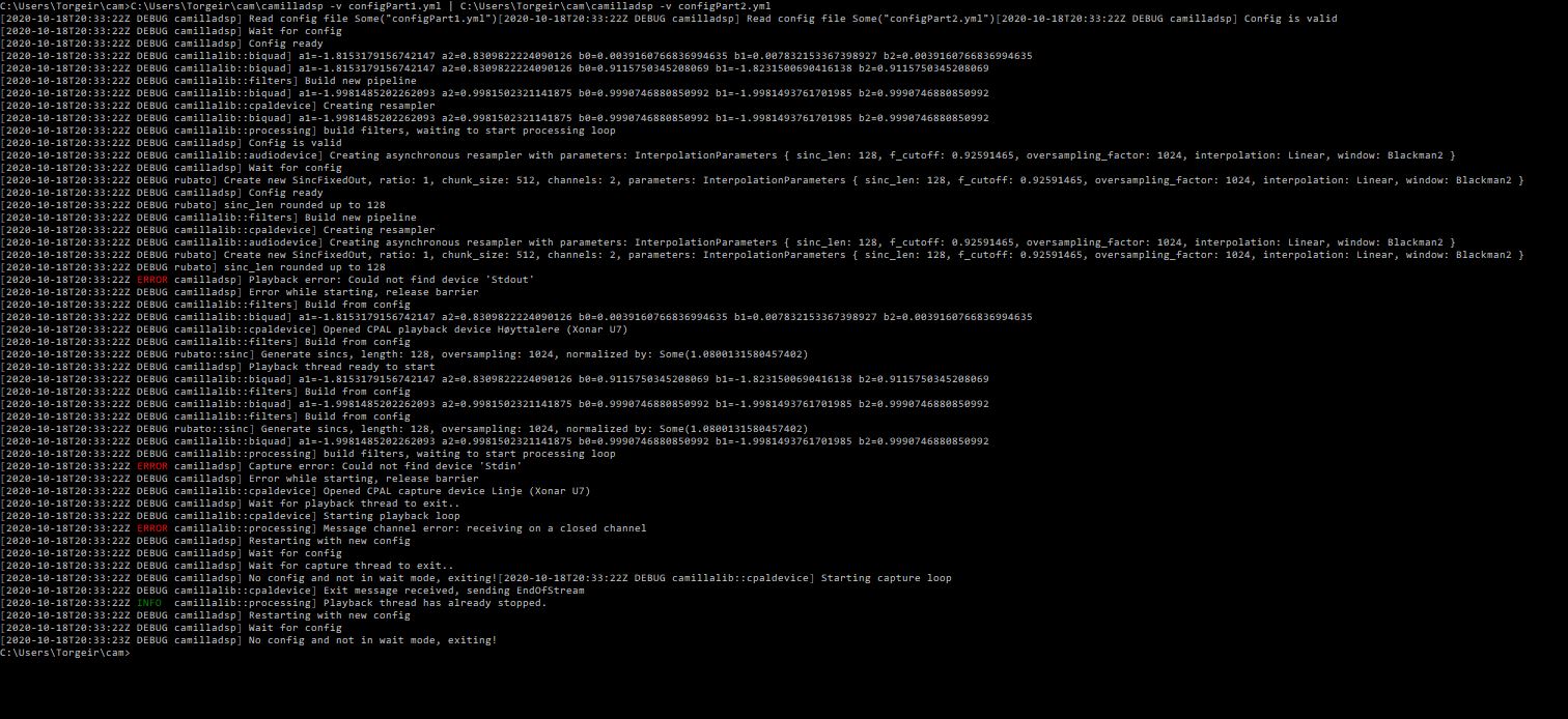

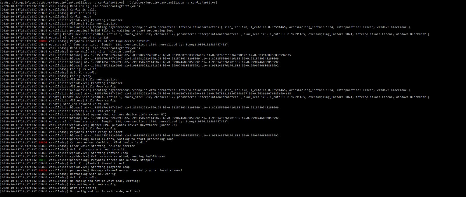

Yes! Managed to start to instansesUse the Stdout playback device on the first instance, and Stdin capture device on the second. Then in the terminal window you connect them with a pipe character, |.
Code:camilladsp config1.yml | camilladsp config2.yml
C:\Users\Torgeir\cam\camilladsp -v configPart1.yml | C:\Users\Torgeir\cam\camilladsp -v configPart2.yml
But Stdout and Stdin not found.
Example:"ERROR Playback error: could not find device"
Don't have virtual sound card. Is it needed?
You don't need a virtual sound card for this. Can you attach the two config files?Yes! Managed to start to instanses

Did you use that Capitalisation? I think windows wants it all as lower case, just in case that makes a difference (no pun intended)But Stdout and Stdin not found.
On part1, change to:See enclosed files.

Code:
enable_rate_adjust: false
enable_resampling: false
playback:
type: Stdout
channels: 2
format: FLOAT32LE
and on part2, change to:
Code:
capture:
type: Stdin
channels: 2
format: FLOAT32LE
The Stdout device can't send the commands for rate adjust, so you can just as well disable that on part1.

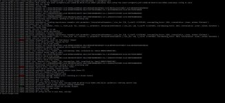

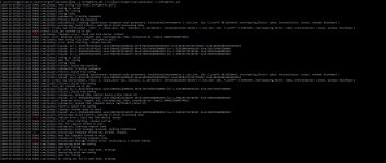

Tried lower case also. Same Error.
(May still be the case that lower case is needed)
There are no log messages on stdout, all logging is printed to stderr. Would it be useful to be able to silence also stderr? A --quiet option would be easy to add.Henrik.
