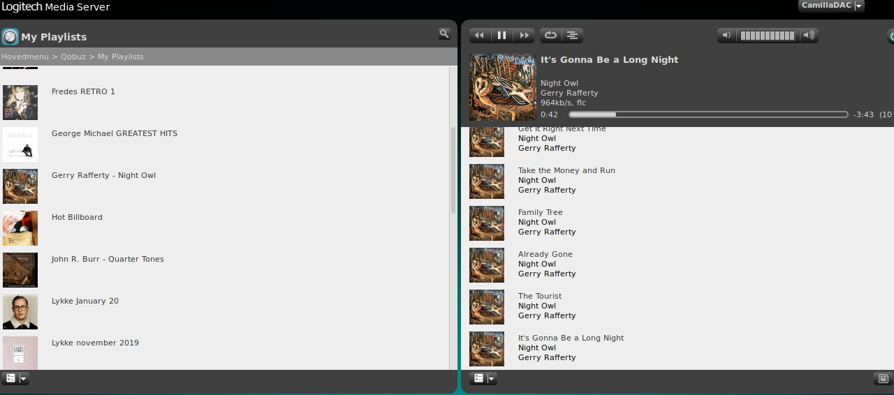

I hooked up the RPI4 to my DAC (Dac shows samplerate btw.. just to tell)
After loading snd-aloop (with the aloop.conf) i got this with aplay -l :
Starting squeezelite on the RPI4 :
I also copied the asound.conf to /etc/asound.conf
So now i have to figure out howto chain it together, and put in the right parameters in the config files.

I stopped squeezelite and started it with the loopback :
But i'am having trouble figuring out howto start camilladsp with the right parameters and plugins configured right and filters (filter.txt)...

Bingo
Camilla consumes 2-3% for this filter
Playing 44.1KhZ is working
Trying 192KhZ is also playing but slooooooW (sounds funny), DAC is not changing samplerate when playing other than 44.1KhZ as expected ofcause
Thanks both
pi@SuperLMS:~/camilladsp/exampleconfigs $ camilladsp /home/pi/camilladsp/exampleconfigs/pass.yml
