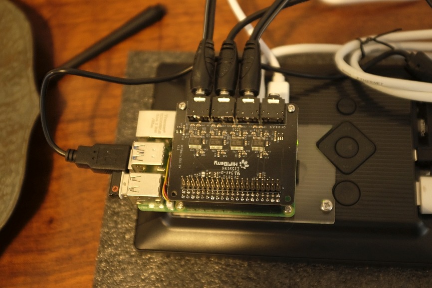

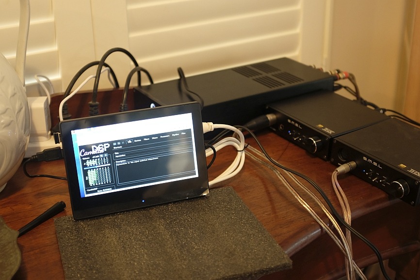

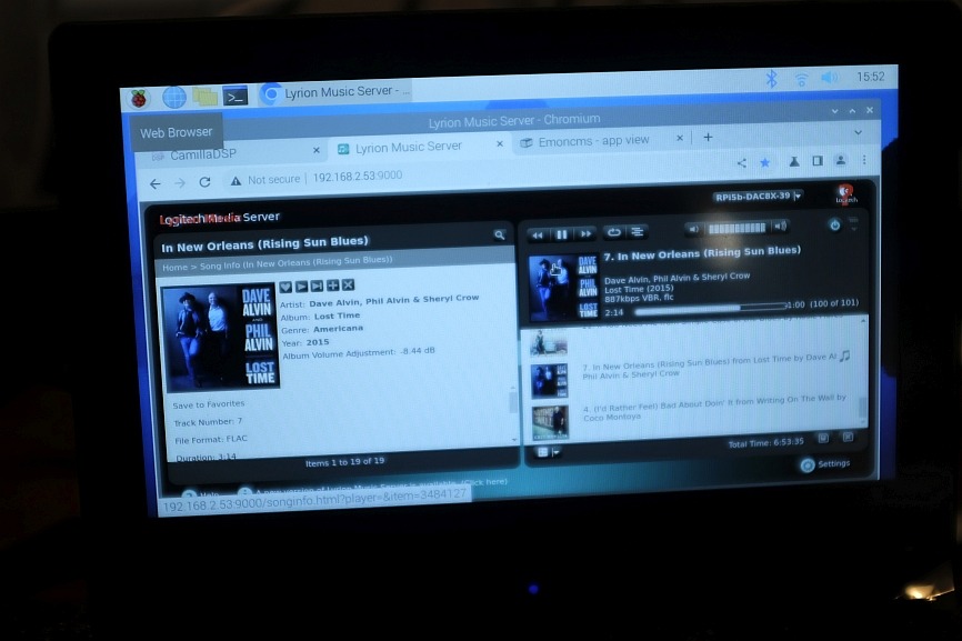

HiFiBerry DAC8X on Raspberry Pi 5 with CamillaDSP and touchscreen.
I put this together as an experiment to show that a full DSP could be homebuilt with a Raspberry Pi mounted to a touchscreen for control.
This shows the DAC8X mounted on the RPi5. The screen is an Elecrow 7" (I need to invert the RPi so the cables come out the top. I will hunt down some right angled 3.5mm plugs). Screen works like a phone screen, pinch out to zoom expand, pinch in to shrink, drag with finger etc.

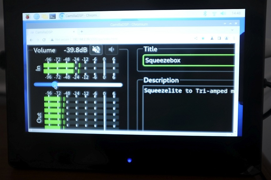

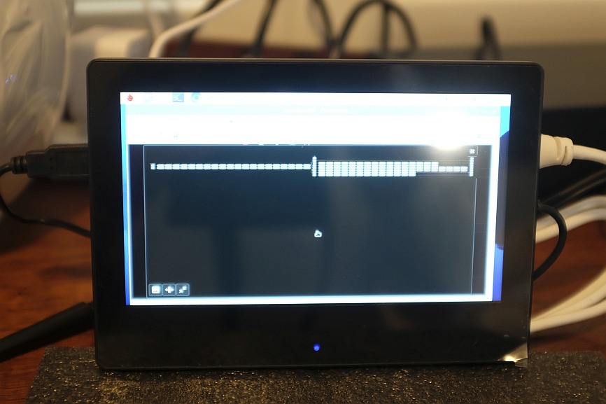

Screen pinched out to show volume control slider.
The zoom controls make the slider easy to control. Selection of other configs is also easy after selecting the Files tab and zoom.

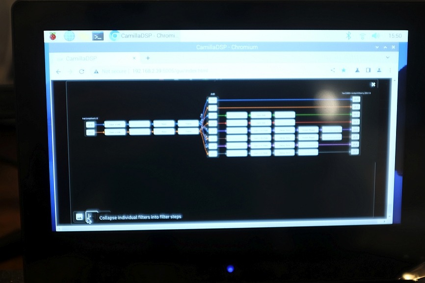

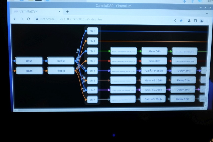

These pics are the Pipeline, pipeline collapsed and the pinched out.
For setup I used a Logitech K400r keyboard, and bookmarked the web addresses I use frequently in the browser. I have not bothered with a "virtual" keyboard yet.
This demo was using Squeezelite as a streamer. A USB audio interface such as a Motu M4 could be added to provide analog input.

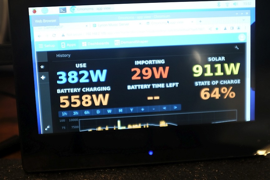

The Pi is running Raspberry Pi OS Lite 64bit and the Chromium browser, so with a couple of bookmarks I can run the Squeezebox server or check the state of my Solar PV system.
The K-Horn speakers are very sensitive (110db/W for mid & hi) but I could not hear any hiss even with the volume right up and my ear in the mid horn mouth, the DAC8X does not add any noise. The first pic shows the amps, an N-Core from Audiophonics for bass and a pair of SMSL SP200 THX headphone amps for the mid and hi.
