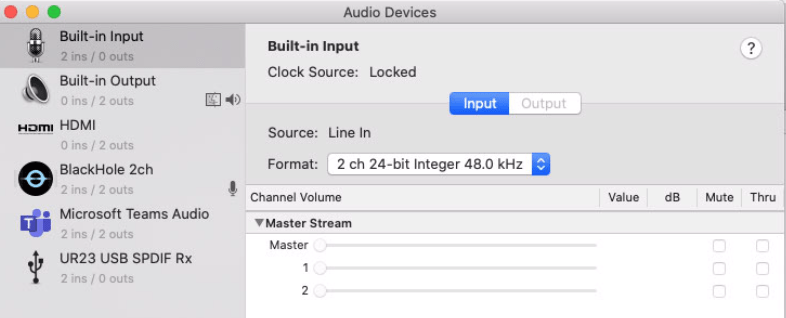

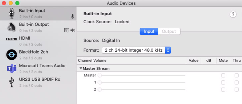

@HenrikEnquist has the change_format option been removed from CoreAudio type devices?
I was playing around with a TOSLINK I/O configuration on a mac mini 2012 and could not get it to run on V2.0.1 as I was getting the error "Capture error: Failed to find matching physical capture format". This happened regardless of capture format and also occurred if I omitted capture format.
V1.0.3 worked OK, but only if I had change_format set to false on the capture device. If change_format was set to true I received the same matching physical format error. Interestingly enough, I could set change_format to true on the playback device without issue.
Michael
Michael

Yes, this just uses the format parameter now. Setting it to null means don't change format.has the change_format option been removed from CoreAudio type devices?
Thanks for the info. For some reason setting format: null gives a segmentation fault. Here are the two logs from V2.0.1 and the successful log from 1.03.
1) format: FLOAT32LE
Code:
michaeldsimon@michaelmini2012 camilladsp % camilladsp ~/camilladsp/configs/toslink2.yml -p 1234 -v
2024-01-17 18:29:28.746462 INFO [src/bin.rs:683] CamillaDSP version 2.0.1
2024-01-17 18:29:28.746505 INFO [src/bin.rs:684] Running on macos, x86_64
2024-01-17 18:29:28.746531 DEBUG [src/bin.rs:728] Loaded state: None
2024-01-17 18:29:28.746537 DEBUG [src/bin.rs:738] Using default initial volume
2024-01-17 18:29:28.746540 DEBUG [src/bin.rs:755] Using default initial mute
2024-01-17 18:29:28.746543 DEBUG [src/bin.rs:765] Initial mute: [false, false, false, false, false]
2024-01-17 18:29:28.746549 DEBUG [src/bin.rs:766] Initial volume: [0.0, 0.0, 0.0, 0.0, 0.0]
2024-01-17 18:29:28.746555 DEBUG [src/bin.rs:768] Read config file Some("/Users/michaeldsimon/camilladsp/configs/toslink2.yml")

Michael
Looks like it fails when reading the name of the clock source. It never reached this point in the first run, where it failed on setting the format.
What system is this? Does it happen with all capture devices?
It is a Mac mini 2012, running Catalina 10.15.7. It has built in TOSLINK input and output, which I am attempting to use as capture and playback devices. I tried using a hifime UR23 which is a cheap TOSLINK to USB device as a capture device on this machine and it works fine with V2.0.1.
I wonder if the issue has something to do with the dual nature of the TOSLINK input which can also act as an ADC. As a default Audio MIDI Settings will report the built in input as "Line In" but if a mini TOSLINK is inserted it will report as "Digital Input". However, V2.0.1 fails whether the source is reported as "Digital In" or "Line In".
Audio MIDI Settings - TOSLINK input
List Devices - TOSLINK Input
Audio MIDI Settings - Line In
List Devices - Line In
Michael

Michael
I just checked on my MacBook pro from 2012. It runs the same system but it doesn't have the same built-in audio device. I can't get it to misbehave with any of the devices I have available.
Looking at the camilladsp code, I am quite sure that the crash happens when it tries read the names of the available clock sources. There is probably something different about the Mac mini here, but no idea what.
An easy fix could be to simply skip that if there is only one source available. There isn't much point in doing it since it won't be possible to switch anyway.
