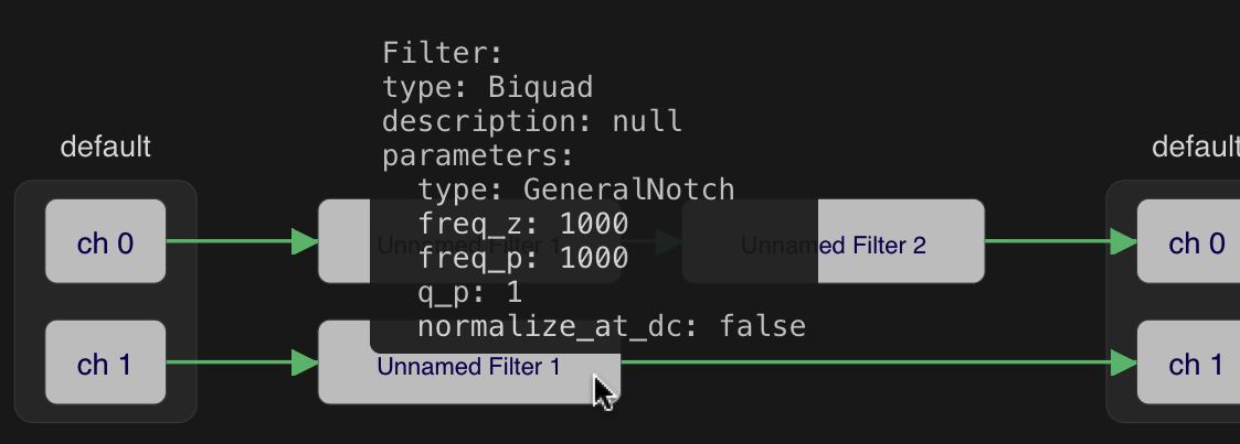

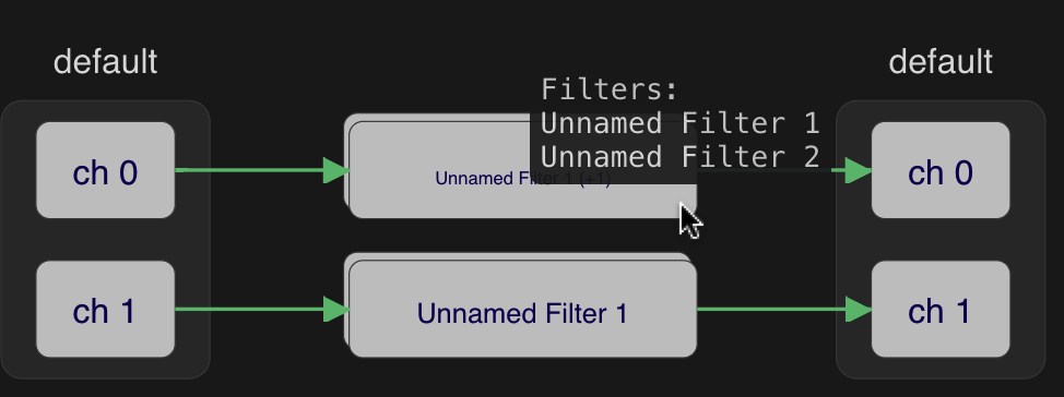

I'm playing a bit with this, and it's not as difficult as I feared to add tooltips to an svg.Henrik, a low priority suggestion for the pipeline display to use the Filter Step Description as the text in the box for the collapsed display view.
This is how it looks at the moment, normal view:
and collapsed view:
