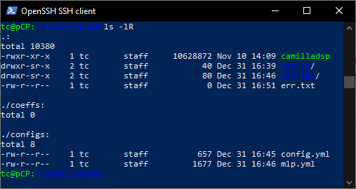

@HenrikEnquist, I'm trying to get CDSP installed on PiCorePlayer (RPi4) and I've run into some issues.
I followed the instructions from Lykkedk's github page and can get the GUI running, but CDSP remains offline.
I have tried extracting your v1.0.3 file and running it, but I can't get it to start. I don't get any errors but nothing happens. Also, I get "-sh: camilladsp: not found" unless I prefix sudo. I tried piping to an err log file but it is empty. Switches -c -h -v don't help.
If you have any ideas I'd be greatfull.

@chuckt62 PiCorePlayer (or rather TinyCoreLinux that it's based on) works a little different than normal Linux systems. I have never used it so I can't help you with where to place binaries etc, but others here should be able to help with that. If you need to use sudo to run camilladsp, then you have some permission issue.
Is it a 32 or 64-bit system? You need to get the matching camilladsp build. Running "camilladsp --help" must print the help text. Before that works, there is no point in trying anything else

I somehow ended up bricking that SD card and started over w/32bit pCP. I'll try again w/64bit if I can get it running.

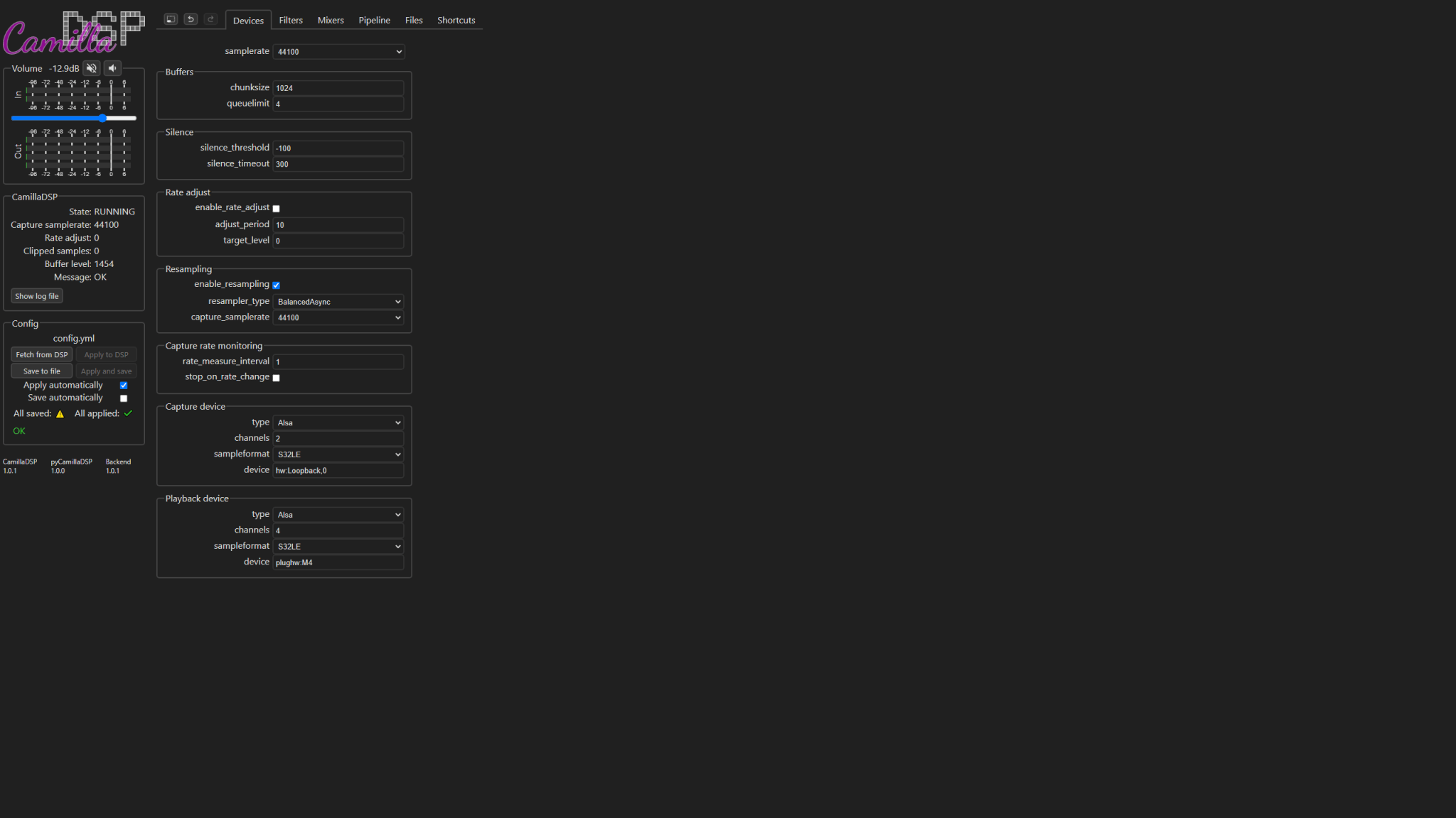

Some progress has been made though. I can run CDSP from cli and gen the log file. It might be failing from the loopback device, I can't figure out how to create it in pCP as it doesn't use module.d (I used 'snd-aloop' in the file snd-aloop.conf and placed it in /etc/modules.d on ubuntu).
config.yml:
devices:
capture_samplerate: 44100
chunksize: 4096
enable_rate_adjust: true
enable_resampling: true
resampler_type: BalancedAsync
samplerate: 96000
silence_threshold: -100
silence_timeout: 300
capture:
channels: 2
device: hw:Loopback,0
format: S32LE
type: Alsa
playback:
channels: 4
device: hw:M4
format: S32LE
type: Alsa

I created the loopback device and get a little further, "sudo modprobe snd-aloop", but I don't know how to make it persistent yet.
It's probably failing on the playback device now, MOTU M4. I have only been able make it work with plughw:CARD=M4,DEV=0 on pCP. It worked with hw:CARD=M4,DEV=0 on ubuntu... Or, maybe it's because I'm listening to it while trying to start CDSP?

If I pause the player and click the 'Power' button (it's not setup to actually kill the player), it goes further but it seems to have failed and I need to Ctrl-C out of it.
EDIT: well it looks like CDSP is actually running, no need to Ctrl-C out.
I just don't get any sound when I start the layer.

It's running now. Camillagui somehow picked up the plughw:M4 from the Squeezlite setup, even though my config file had hw:M4.
I added the plug prefix to the loopback device and boom... it works.
Now to figure out persistent snd-aloop, running cdsp at startup and why pCP needs the plug hw :scratch2:.
chuckt62
2022-11-10 1:01 am
I put 'modprobe snd-aloop' in /opt/bootlocal.sh to get a persistent loopback device.
