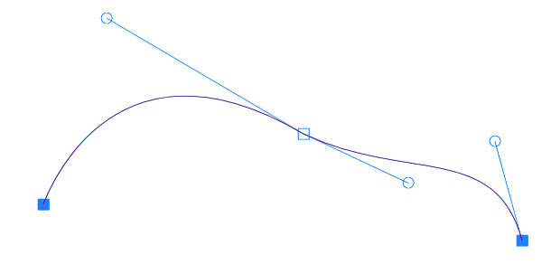

A more interactive way via GUI perhaps? I envision a (one?) spline representing the correction curve where a constant pink noise is played and at the same time observing the system with a RTA FFT (both by e.g. REW) - and in CDSP being able to add points and handles to interactivly manipulate the "curve" - in the background Camilla creates the necessary IIR (FIR?) filters and adds them to the processing as soon as finished indicating with progressive feedback.
After a more scientific approach to fixing the room curve this "tuning tool" could be a very nice way of finishing off the job via a combo of "by ear" and measurement.
There's no need to do this interactively. If you have a system's impulse response saved to a file, you can simulate all kinds of processing with very high accuracy without exposing yourself to constant white or pink noise. The constant noise gets really annoying really fast 😉I envision a (one?) spline representing the correction curve where a constant pink noise is played and at the same time observing the system with a RTA FFT (both by e.g. REW) - and in CDSP being able to add points and handles to interactivly manipulate the "curve" - in the background Camilla creates the necessary IIR (FIR?) filters and adds them to the processing as soon as finished indicating with progressive feedback.

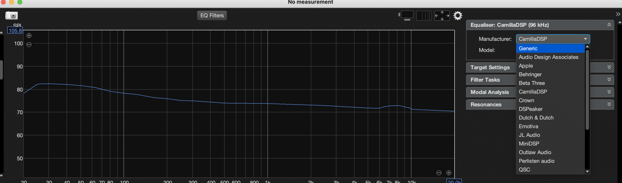

I recently used Open Sound Meter on one laptop while I used a second laptop to make Rephase phase adjustments and apply them to the CamillaDSP config. Open Sound Meter realtime display eliminated the taking of measurements for each change. Open Sound Meter uses pink noise but thankfully it is one click to turn it off while going through the 'Rephase adjust / copy to CamillaDSP config / apply config to DSP' cycle.
A similar technique could be used to adjust the room curve, but good luck automating it.

How did you get the Equaliser at 96kHz ? On win 11 I can only get it at 48kHz.Seen this in the latest version of REW (beta) ?
Creating filters that fit a spline (or any other free-form curve) like that is quite a big project, not likely something I would ever find the time to implement. But in practice, wouldn't a graphic equaliser give you nearly the same functionality? That's something I have been thinking about adding, a normal graphic equaliser where you just tell how many bands it should have. In the background it gets built from Peaking filters with suitable q-values.A more interactive way via GUI perhaps? I envision a (one?) spline representing the correction curve where a constant pink noise is played and at the same time observing the system with a RTA FFT (both by e.g. REW) - and in CDSP being able to add points and handles to interactivly manipulate the "curve" - in the background Camilla creates the necessary IIR (FIR?) filters and adds them to the processing as soon as finished indicating with progressive feedback.
That would come a long way yes! The spline thing was just a funny idea on a UI for doing the same thing.
