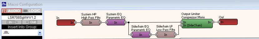

@HenrikEnquist , mind taking a look at the compressor-related section of my config file (attached here as a txt file)? This is for my JBL 708i speakers that I had mentioned earlier in this thread. This is the process flow (updated since my last post regarding this. Just look at the sidechain -> output part):

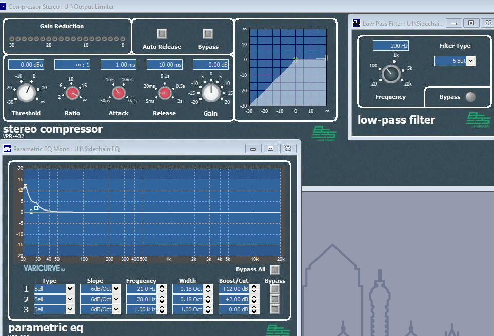

And these are the settings I need to replicate:

As I understand it, the compressor uses the side chain as a control signal that determines how the normal input should be compressed. I suppose you want the compression to act on both channels equally, so the balance isn't screwed up?@HenrikEnquist , mind taking a look at the compressor-related section of my config file
In that case, make the first mixer output 3 channels, where channel 2 is the sum of 0 and 1.
Add the low pass and peaking filters on channel 2.
Then in the compressor, set this:
Code:
monitor_channels: [2]
process_channels: [0, 1]
Then after the compressor, add a mixer 3->2 channels that discards channel 2. And that should be it.
