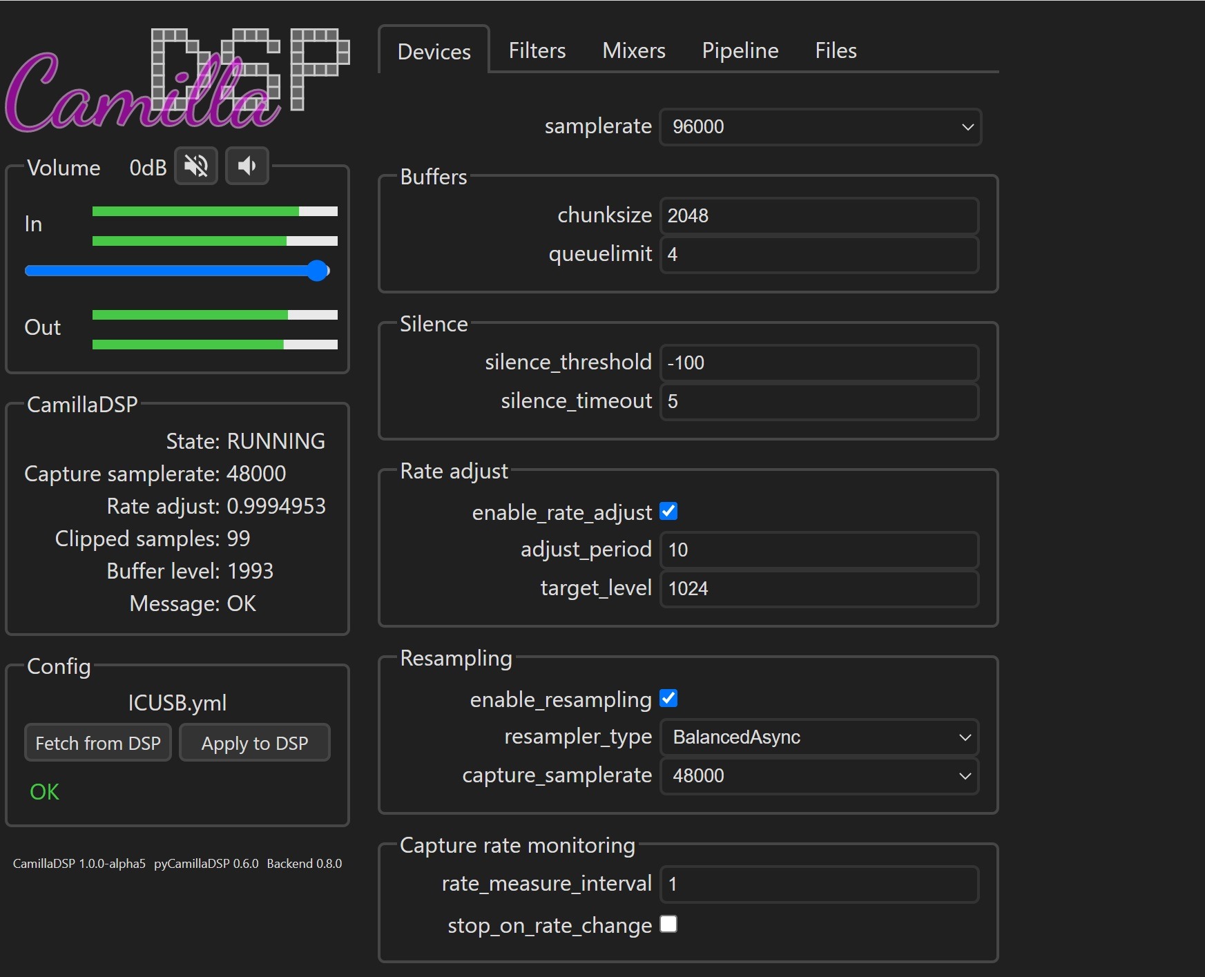

Ok.. but that counter should not be able to tell if the incoming spdif signal is clipped. The input is integer numbers, and all the possible values are vaild. This is caused by something else. Can you post your config?
hello and sorry for the late reply, needed to find the occasion to do this.
Really, this is a non issue for me, posting per your request in case you are curious.
Attached a screenshot showing the cippled samples counter (it is really difficult to take the screenshot right when the bars are red, but you can see the counter). Attached as well my config. As you can see, the resample is enabled. The song playing was "I didn't change my number" by Billie Eilish.
will try to observe if without resampling also clips. cheers.

I would guess your convolution filters have boost and that is why your -3 dB gain in your mixer is not enough to prevent clipping. What does the convolution filter response look like?
