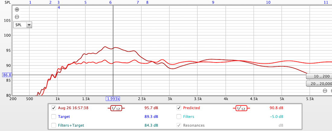

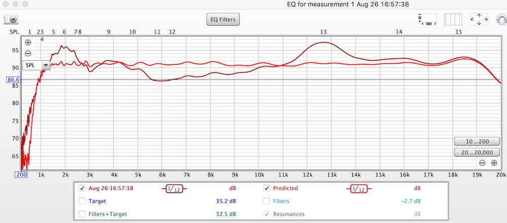

A more direct integration with REW and its EQ filter section would be wonderful. You stare in awe at the result of an auto EQ optimisation result from REW but hesitate due to the typing effort... If Camilla could import the results coming out of REW would be wonderful... but we have been given so much already so can we ask for more really...

REW seems to create a bit more brutal filters than seemingly needed in order to match the requested target curve. Some 15 dB here and there... For this reason it might be good if one could control the execution order of the filters in order to not clip the signal - this depending a bit on the internal implementation scheme... but it would be wise to executed the damping before the gain filters in general - would it not?

You can use rephase to import the EQ's from REW and generate an FIR filter which Camilla can play. No typing effort required. The only issue would be that it would be sample rate dependant.A more direct integration with REW and its EQ filter section would be wonderful. You stare in awe at the result of an auto EQ optimisation result from REW but hesitate due to the typing effort... If Camilla could import the results coming out of REW would be wonderful... but we have been given so much already so can we ask for more really...
Henrik might be able to leverage the xml output to use with Camilla but there is the option to use FIR's now.
