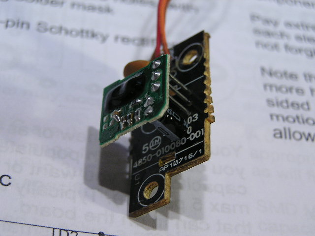

Well I went ahead and removed the module's shielding, does not look like a TSOP18. I had gotten that info from another CA schematic. Is this a custom module? There is no info on the diode board itself, but the lower board has the following markings:
HF-03
94V0
4850-010080-001
AP10716/1
I might as well replace the board and see what happens, perhaps things have drifted a bit. The cap's esr is about 3 ohms and measures 42uf (47uf/6.3V), the esr is slightly higher than expected of 1 ohm, but probably not enough to be concerned about.

Not seen one exactly like that, however any standard type should work OK... if it's faulty, it may not be of course. You need to know the carrier frequency... if it's near enough it probably will work OK.
The supply will be across the electroylitic, and the wire that's left is the output.
A 'scope check is absolutely conclusive.
I can only find the service manual for the 640C and it does not identify the TSOP18 part enough to determine the carrier frequency. AP Part Number PY054. Anything here to indicate what the carrier frequency would be for mine? I'm guessing manufacturers would use the same carrier frequency to ensure interoperability of remotes?
