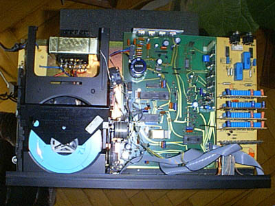

To buy diagram hard to CD2 . I am CD2 in track of repair.
Mechanism and electronic engineer CDM2/29 will be exchanged .
Clock will be new and TDA 1541 replace will become TDA1541A/S1 of 4 art .
Operating amplifiers will become put new.
Which I do not know still , I begin projectjust.
I can look and to say how to connect clock in cd 2

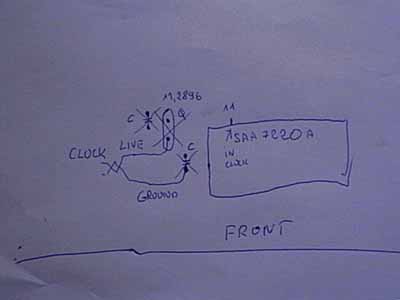

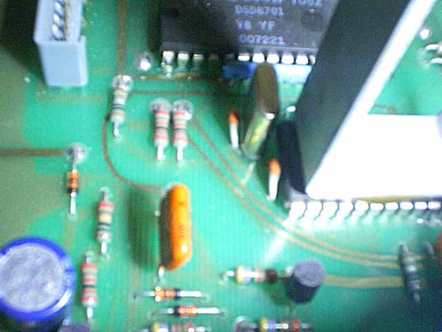

Instruction how to put clock .
Clock 11,2896 Mhz.
To remove quartz 11,2896 and two ceramic .
Hot line of clock to connect resonator leg from front side instead of ; in the place .
Ground to connect instead of ; in the place ceramic theses closest front side
Clock 11,2896 Mhz.
