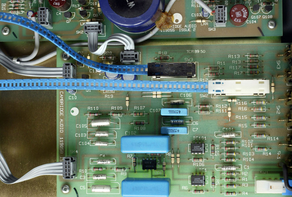

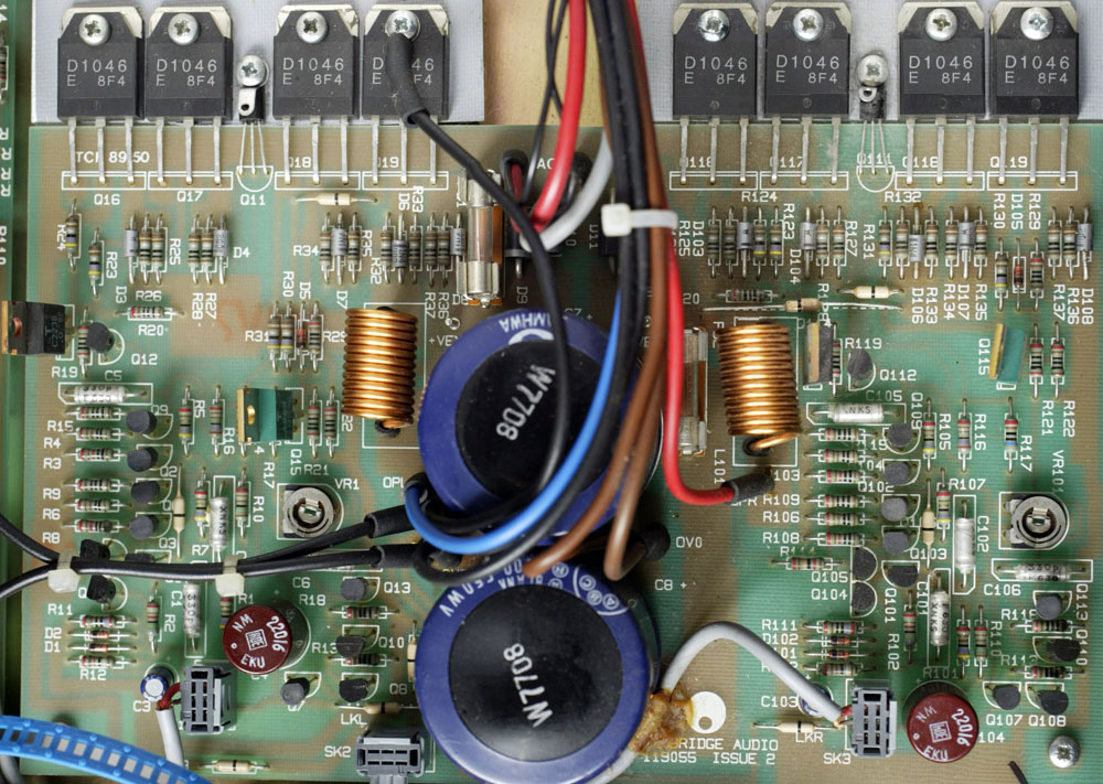

Thanx Sakis.. 🙂 Well.. That's just it.. Amp never get hot anywhere. Even at all day work temperature is just above room temperature. I bought that amp from a older guy and he said that he wasn't using it for years. I don't even think it ever was open I'll have look at link you gave me and post some pics tomorrow..
Pics from power and pre section..

all axial electrolytics are to be trushed ... in similar units i ha ve seen issuel like that but also resitirs that have drifted values ... around output and driver stage red electrolytics are to be trushed also /
i dont remember the selector switch configuration but notice that problems could lay there also

Those capacitors with ROE on them are suspect IIRC, they fail quite easily. They are 220uF 6V capacitors I think. 220uF 16v electrolytics will do to replace them.
It sounds to me like you've got a dry joint and when it warms up the circuit board expands very slightly and closes the joint. When you first switch on try tapping around the circiut board with something plastic, you'll probably notice some part is sensitive and that's where the dry joint is. Just dab a soldering iron around that area melting the solder making sure you don't short anything. you just need to melt the offending joint to cure it.
