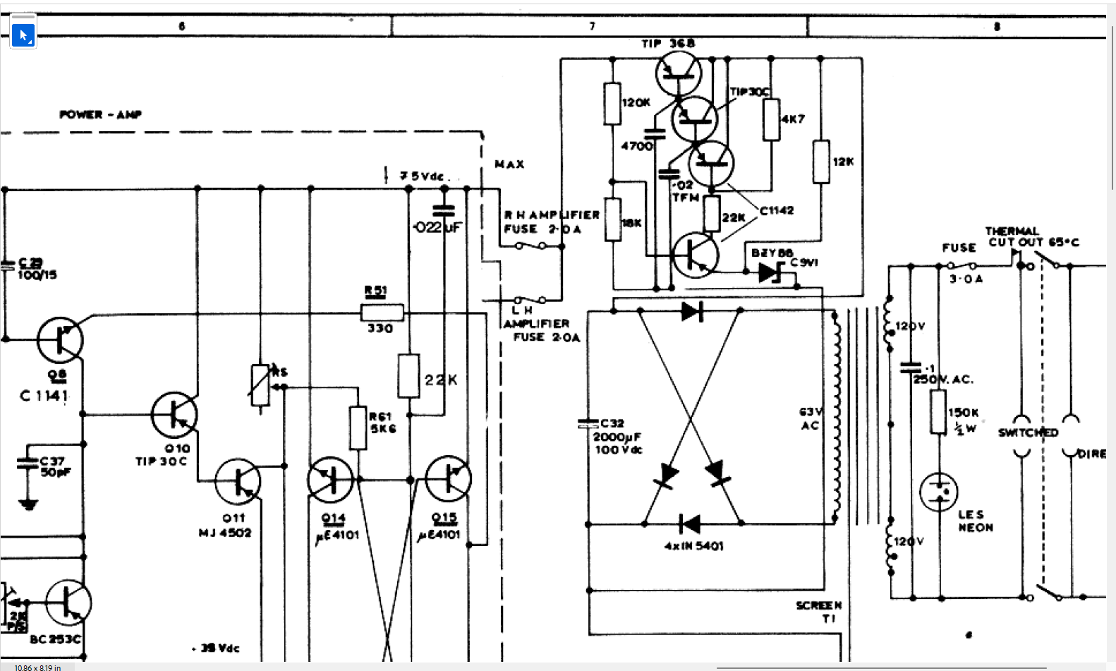

Hi, all. Just bought a very clean and presentable Cambridge audio P40. Bought as spares repair. Plugged it into the lamp limiter and all was good so braved it at plugged it in and hooked up some speakers. Basically, it's working but there's an issue with the sound balance between left and right channel.
The first thing I noticed was that the volume pot seems way to sensitive. By this I mean that from 0, it goes really loud as soon as you turn it. It is graduated though. Second thing I noticed is that the right channel doesn't become audible until volume is turned up a bit. This is regardless of which position the mono/stereo selector switch is in.
Next thing to note is that's the balance pot doesn't seem to do much at all. I can hear a shift it left /right bias when I turn it fully either way but it's barely noticeable and when turned all the way, it doesn't mute the opposite channel.
Other than that, it actually sounds pretty good. Only paid £30 and it's in lovely cosmetic condition. In my opinion it's a lovely looking amp and it seems very well made. it's really heavy for the size. Looking inside it doesn't appear to have messed about with.
I believe it's from the late 60's/early 70's which would make this the mk1.
Any pointers would be greatly appreciated. Haven't been able to find a wiring diagram either so if anyone has one that might be handy.

This one perhaps ?

Yeah I've used contact cleaner in everything I can access. Might need to dismantle and clean them more thoroughly though.
Leaky electrolytic caps allow DC to pass through some controls and this also results in noisy operation. As this model is quite old and lubricant can't fix electrical faults, I would be replacing all the electrolytics with standard, known quality parts, not expensive boutique types. If you haven't done this already, good luck with your restoration. Do it right first time and you'll be much happier than having to open it up again again to iron out such faults that have developed over time.
BTW, the narrow operation range of the balance balance pot was not unusual in 60's -70's British designs. Typical DIY designs were also like this until Japanese products swept all aside and showed how more flexible features were possible and at lower cost too.
The volume control having little range might have a lot to do with the input sensitivity, especially if you are feeding it from a CD player or a PC. The line input is apparently 250mV sensitivity, whereas that would be more like 1-2V on a modern amp
edit: According to the manual, the Radio input is 250mV into 180 ohms impedance. The Aux input is 50mV! into 100K. If you were using the Aux input, that would certainly explain why it's so loud!
Thanks for the advice. That would definitely explain why it's so loud! I am planning on doing a recap on this amp when I get some time. In the meantime, is there anything I can do to make it a bit easier to live with with regards to the input sensitivity? At the moment the only thing I have plugged into it is a DAC (raspberry pi).

The level adjust pot on the back matches the tape out level to the tape playback level,
so that the tape monitor switch has equal levels in both positions.
Sounds like the volume pot is the likely cause of the channel imbalance.
