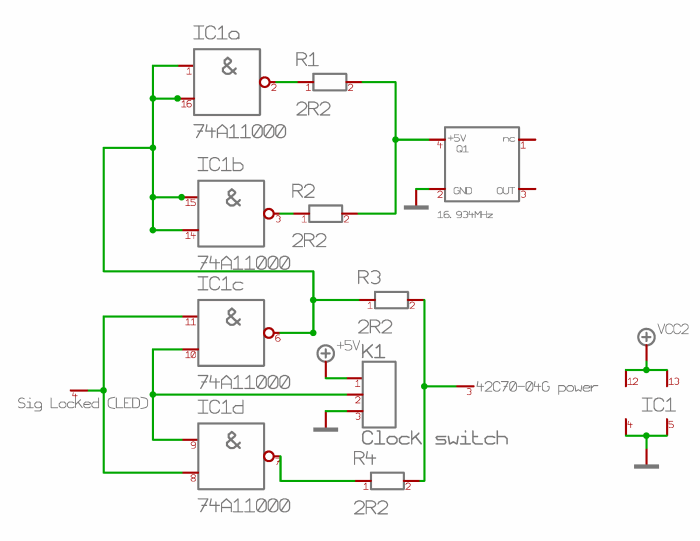

I've spent some time tracing out the Iso board to try and figure out what is going on. I discovered that the oscillator is powered via. two outputs in parallel of an AC11000 NAND logic chip, and when there is no signal lock, the oscillator power is switched off.
Attached is the schematic I've managed to come up with through probing. No idea what the 42C70 is... small EEPROM?
The logic appears to be working as designed... or at least as the PCB has wired it! According to the truth table I just wrote out, only with a signal lock and the locked LED turned on (by whatever is responsible for that) will the oscillator be powered.
- Tom.

Tom,
Are you sure - thats not what I designed? - so unless Cambridge Audio changed the design for some reason - I cannot comment -
My design was Rev 1.0 - Copywrite 1996
the 42C70 is a PLL Multiplier x 1.5 I seem to recall (256fs from 8412 to 384FS for SAA7350 - thats why clock-lock is so much better - the 7350 operates directly from XO without the need for PLL.
Are you sure you have the correct pinouts for the 74AC11000? I cannot believe CA changed the design...
John

John,
Yes... I've just re-checked the wiring with my DMM again, and they are connected as shown in the diagram.
It does look that way. Someone who never bothered to check the implications of the changes, I suspect... either that or there's a PCB error...

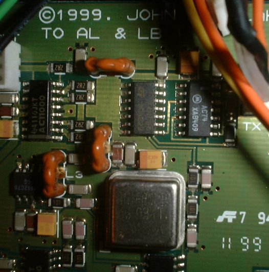

This is a PCB from an "S700" labelled Isomagic. It is marked "ISO REV 2.1", and the text at the top reads...
(C)1999. JOHN WESTLAKE
TO AL & LB
Straight from the TI PDF, downloaded a few days ago.
If you could suggest how it is supposed to be wired, I can make the necessary changes and hopefully have working clock lock... 🙂
Thanks,
Tom.
TO AL & LB
Thanks,
Tom.
Tom,
I will be meeting with the CA guys in HK at the end of next week, so I will investigate more - I suspect that there must be another problem as the Clock Lock should still work even if the clock circuit requires signal Lock to enable its operation. Many of these units have been sold - so this must be an isolated issue.
There must be an issue with the DiscMagic - but what, I cannot say without seeing the unit. I can send you a replacement DOTX board (you will have to add U3 and its heatsink). The board's in Europe - so I cannot send until my return at the end of Oct.
If this does not solve your problem, then I recommend purchasing one of my new transports - these will be budget priced but will still out perform all transport on the market in terms of Phase noise performance and disc reading ability.

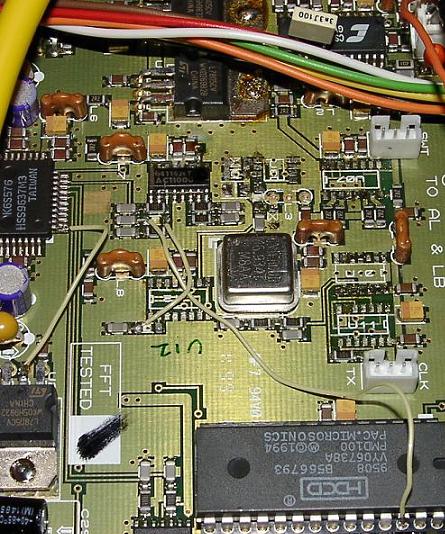

Hi John,
Thanks for the offer of the replacement Discmagic board - it may help with some of the more recent issues I've been having (and that I hope Jonathan won't encounter!). The new transport sounds interesting, but I already have a very nice one for myself... uses a DVD-ROM mechanism and asynchronous reading... and double precision floating point DSP for oversampling... 🙂
What I've done to the Isomagic is disconnected 1A,1B,2A,2B from 3Y, and connected them to ground. I've then lifted 1Y and 2Y, and connected the two 2R2 resistors in parallel directly to the switch output.
This now means the clock comes on and stays on when the switch is flicked downwards, regardless of whether there is S/PDIF lock, and stops the vicious cycle of intermittent locking.
I now have working clock locking, it appears. I'm measuring pretty stable clocks at R26 in the Discmagic - slightly different frequency when clock locking is enabled...
16.934045MHz for clock locked
16.933255MHz for no clock lock
So it *seems* to be working.
Unfortunately, somewhere along the line, I appear to have done something bad to the Discmagic... there's a kind of distortion over the top of the audio regardless of clock mode unless I touch PCB ground with a finger, when it miraculously disappears... could this be due to the removal of the copper shield, and the ceramic caps on the servo board that were soldered to it?
If I feed from the D500 over the same coax lead, there is no such distortion. Gaaahh!
I'll just have to hope it goes away... really need to get on with the serious Isomagic modification now, otherwise I'll never get started before big life things take priority. I've attached a small picture to show how this Rev.2.1 used to look around the clocking area (before I altered it!).
Tom.

Hi Tom.
Yes its most likely that your issues are due to thr removel of the shield and RF bypass caps - the case is no longer "Grounded" to the servo board, and noise is being directly coupled into the RF sections.
John
