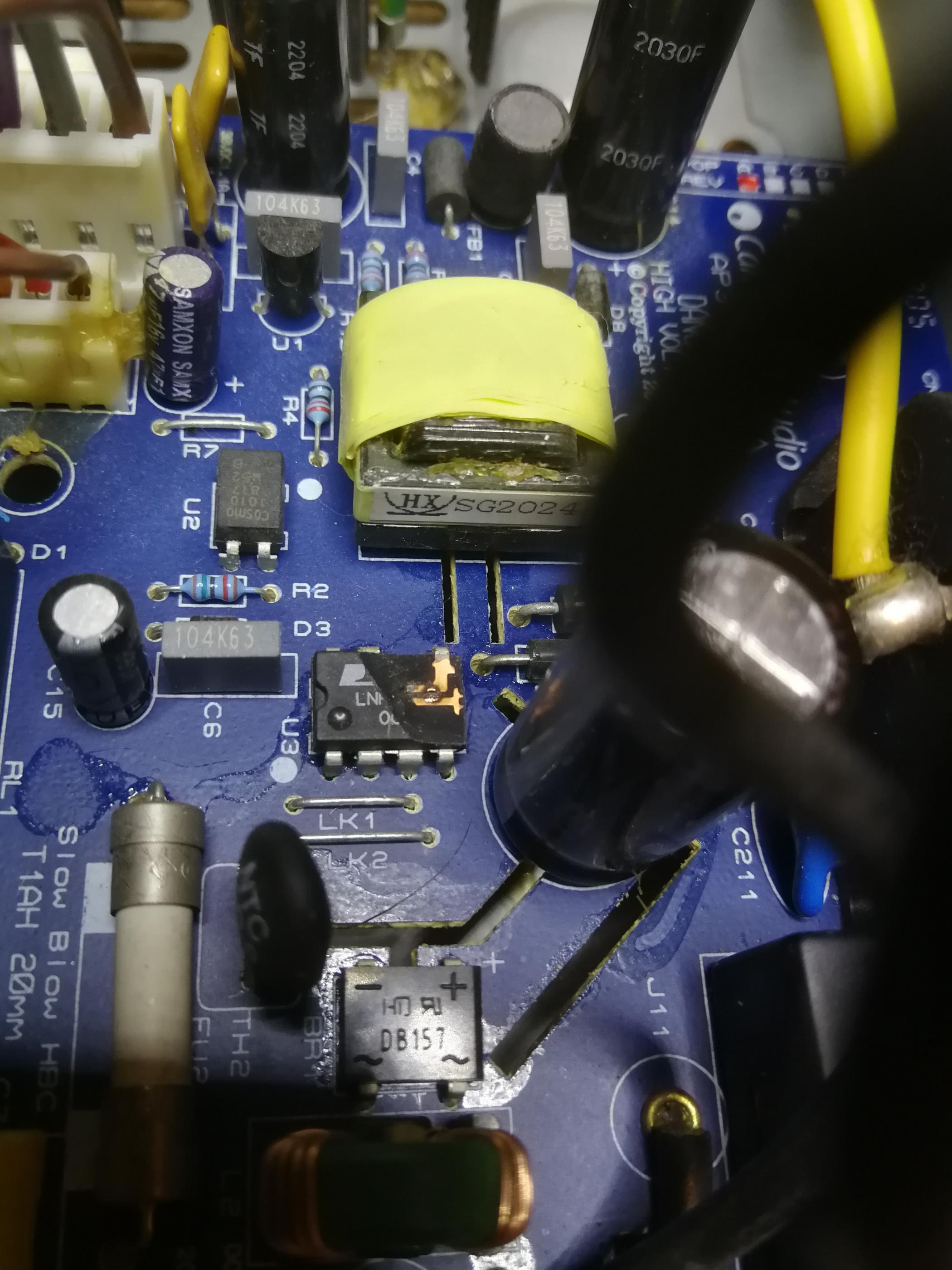

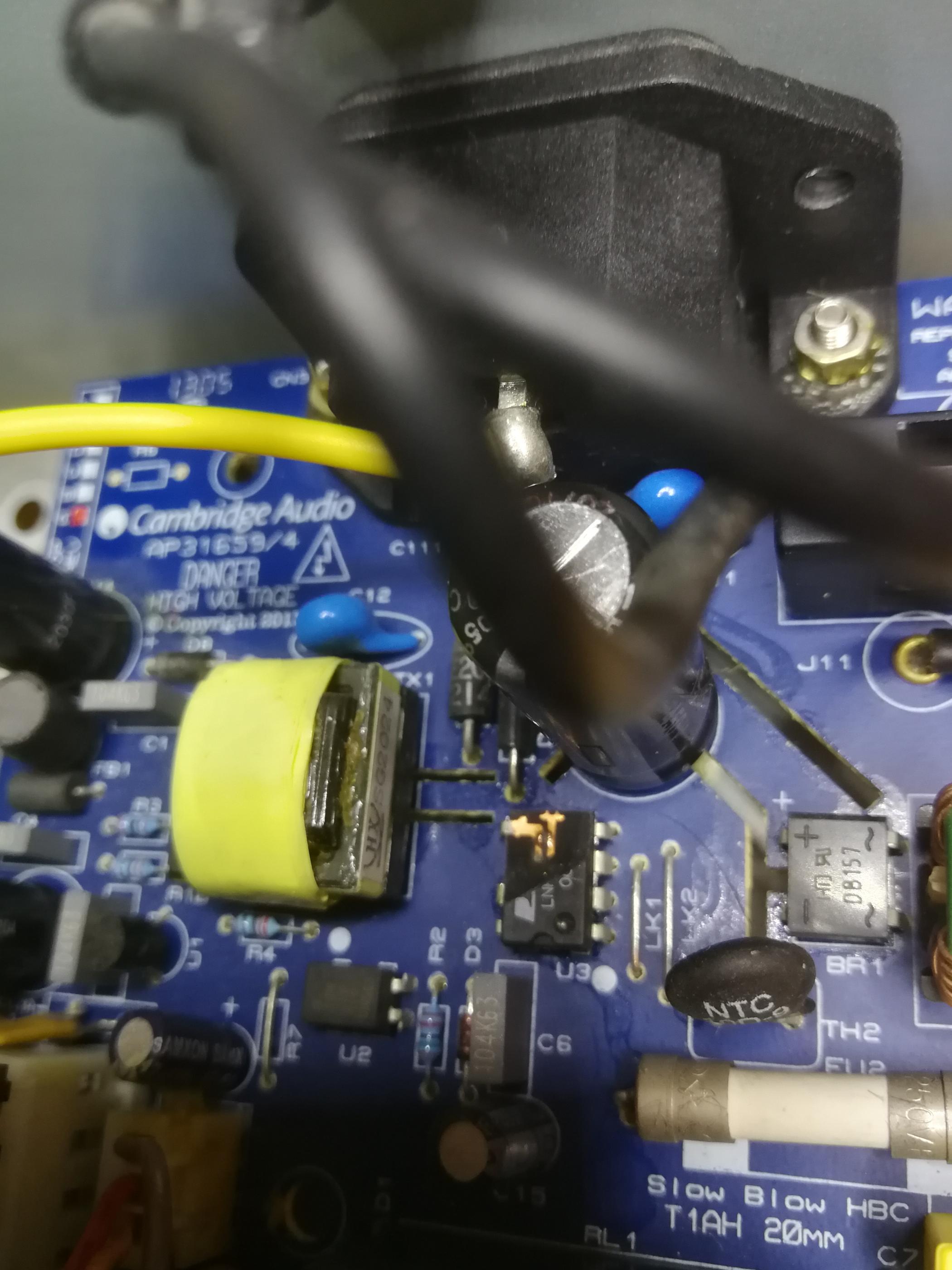

Hello, I have this amplifier that does not turn on anymore, I opened it and I noticed that on the circuit connected to the power supply tray the 8-pin dual line integrated circuit signed U3 has exploded, the only letters I read are LN, it should be l switching power supply for standby, I kindly ask if anyone knows the exact abbreviation of this component, thank you.
There is no free download manual specific to this late model so I would guess it is similar to AZUR 650A. Both models are rated at 75W and probably use the same output power amplifier design, based on Sanken STD-03 Darlington devices. U3 however, is repeated on different PCBs and though it may appear to be the same OPAMP - it may not have the same function.
It would be very unusual for an 8 pin OPAMP to explode - except for one detail - there is more than one U3 and this it may be something else, like an optical coupling or decoding device associated with digital audio (IPOD) inputs and remote control devices. So check the PCB number /description - which PCB is the damaged U3 located on?
I am attaching a photo of U3 which, as I have already said, is a switching power supply IC of the LNK family

I would find out how many windings are on the small transformer. Two windings, it's LNK362-364. Three windings, it's LNK562-564. Id imagine the one with the most output power (the 364 or the 564) would be suitable in any case. I suspect as there is an optocoupler, this is going to be an LN36x
I expect you will want to check the small bridge rectifier, the 400V capacitor nearby, and possibly that optocoupler too
