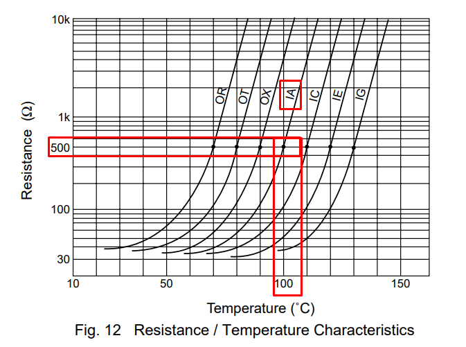

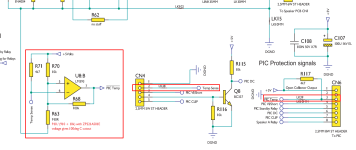

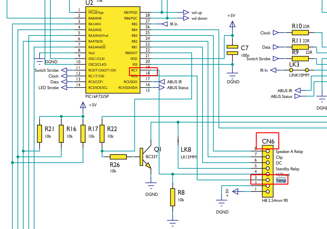

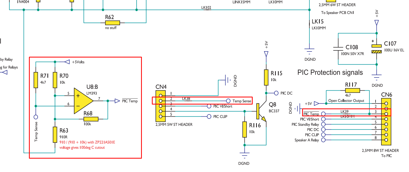

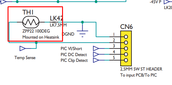

I checked the Service Manual for you for 640A v2.0:
- the thermal protection activates when the PIC gets the info on its leg 18
(if its OK, it should be on 5V, and if overheated, then on GND 0V) - this line comes from connector CN6 pin 3
- and that signal comes from the opamp U8/B forming a voltage comparator
- here the reference threshold voltage comes from the R70/R63 voltage divider and is ~417mV
- and the monitored value comes from the R71/TH1 voltage divider
(the "TH1" is temperature sensor mounted on the heatsink comes from CN4 pin 1-2) - when this R71/TH1 gets above this "417mV" the comparator "fires" and pulls it's output (the "PIC Temp" line) to GND
- this voltage is reached when TH1 gets above ~427 ohm while it gets hot
(and it is below 100 ohm when cold, as the datasheet says for ZPP221A501E as attached)
