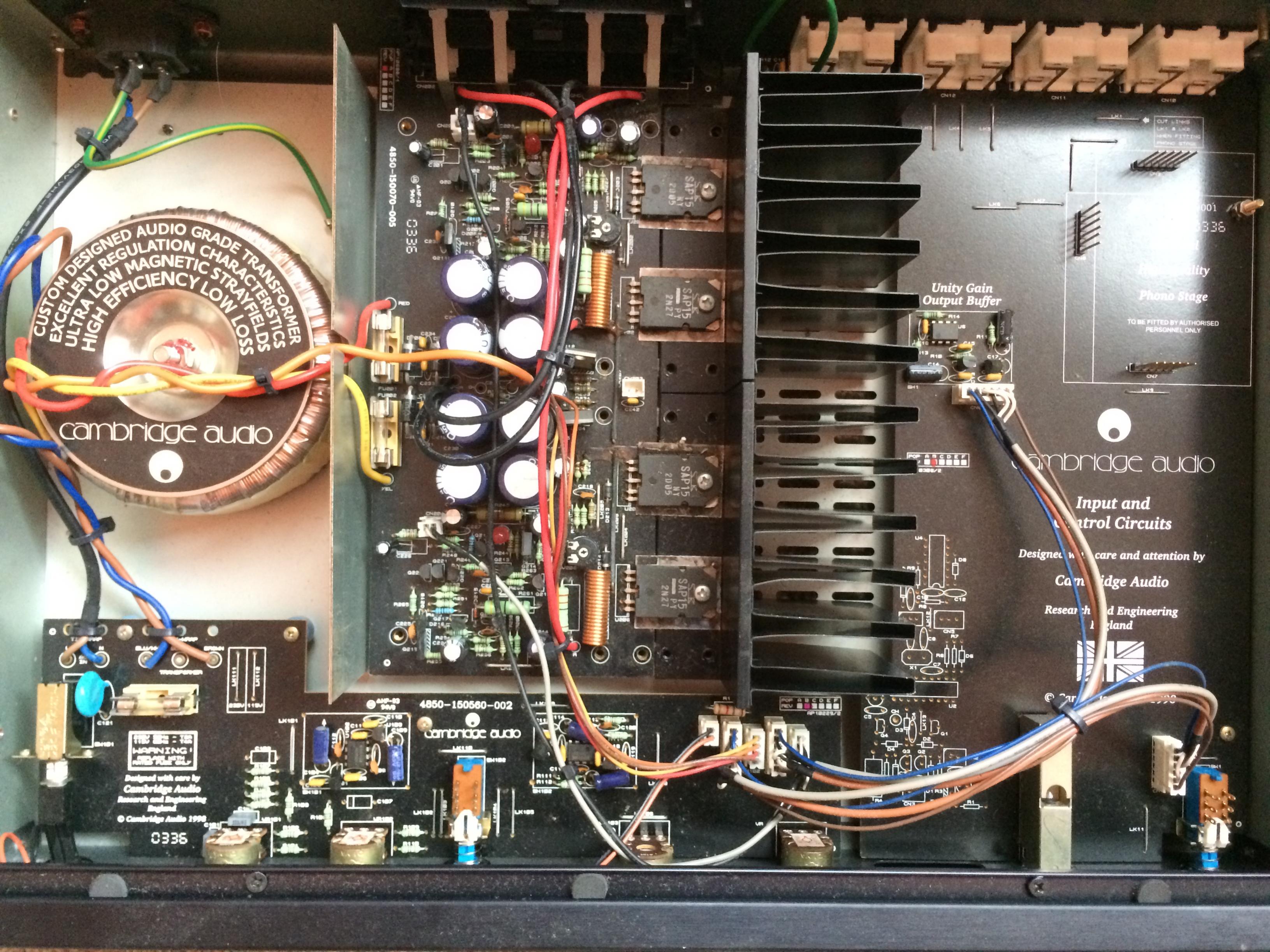

Hi all,
I have been given a Cambridge audio A5 amplifier that is faulty.
Reported Failure:
Apparently it blew during a party. Probably due to the poor heat sink.
Failure:
Blows both T4A fuses blow on each channel on power up. The T2A power supply fuse remains intact.
Observations:
-Has leaked 2200uF 50v capacitors. But no bulging or disfigurement.
-No other signs of burning or damaged components but that is only a visual inspection.
-Although there is one resistor that looks more brown, however it is exactly the same on both channels.
-No burn marks on the Pcb
-No obvious burns in other components
Questions:
It has sap15 ny and py transistors. Is it worth unsoldering them and check the resistance through the diode both ways? Or any other pins? It had 5 pins.
Also, could it be possible the thermal fuse has blown in the transformer? And is there an easy way to check this?
Is there easy way of checking components when they are in circuit?
Parts:
I've bought some replacement 2200uF 50v 105 Deg capacitors so slightly upgraded from the 85deg ones in it.
And T4A fuses
Any help or suggestions are welcome. I have a DMM and no other testing equipment. Physics degree but not a lot of electronics knowledge

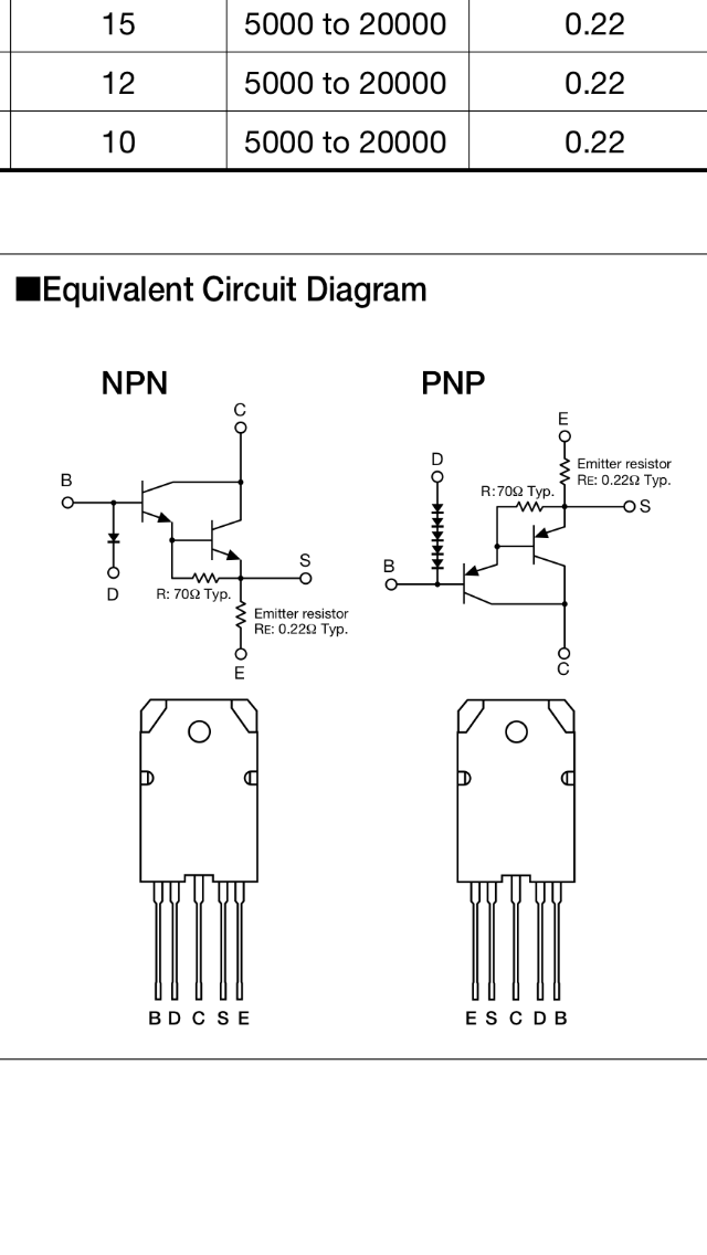

If someone could tell me a good way of testing these SAP15 transistors that will be a great help. I've attached a circuit diagram of the SAP15's.
Say if I test between pins B and D both ways. E.g for NY type: B-D should be low resistance and D-B should be high/inf.. Am I right in thinking that?
Then I could test B-E? The resistance should be 70.22Ohms? But that depends if the switches are open right?
Does anyone have a good method of testing these with a DMM?
Also, I have bought the same but higher T capacitors.. should I have upped the capacitance or voltage? Or is it good that I left them with the original values?
Cheers
Failure mode of the output transistors will almost always be a reading of either a short or a very low resistance between C and S.
For the NPN devices you should get a reading of 'infinity' between C and S when your red meter lead is on C. For PNP device the black lead should be on C.
Say... a current (e-) travelling from C to S (NY type) and you measure using a DMM... it should read inf due to the switches being open? If it reads low resistance / short it means the switches are permanently closed and so not functioning correctly.
Is that the right thinking?
Yes.
The basic test is using a meter on ohms or diode range. If the device is short circuit (or nearly so) then it will show as such while testing in circuit.
For an NPN device and with a positive test voltage on the collector then no current should flow between C and E. That is what this basic test proves.
If the reading is low then the device has failed.

Can you post a close up of the amp PCB? Maybe daylighting might help with focusing.

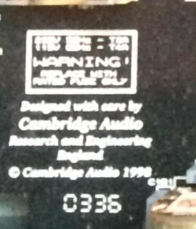

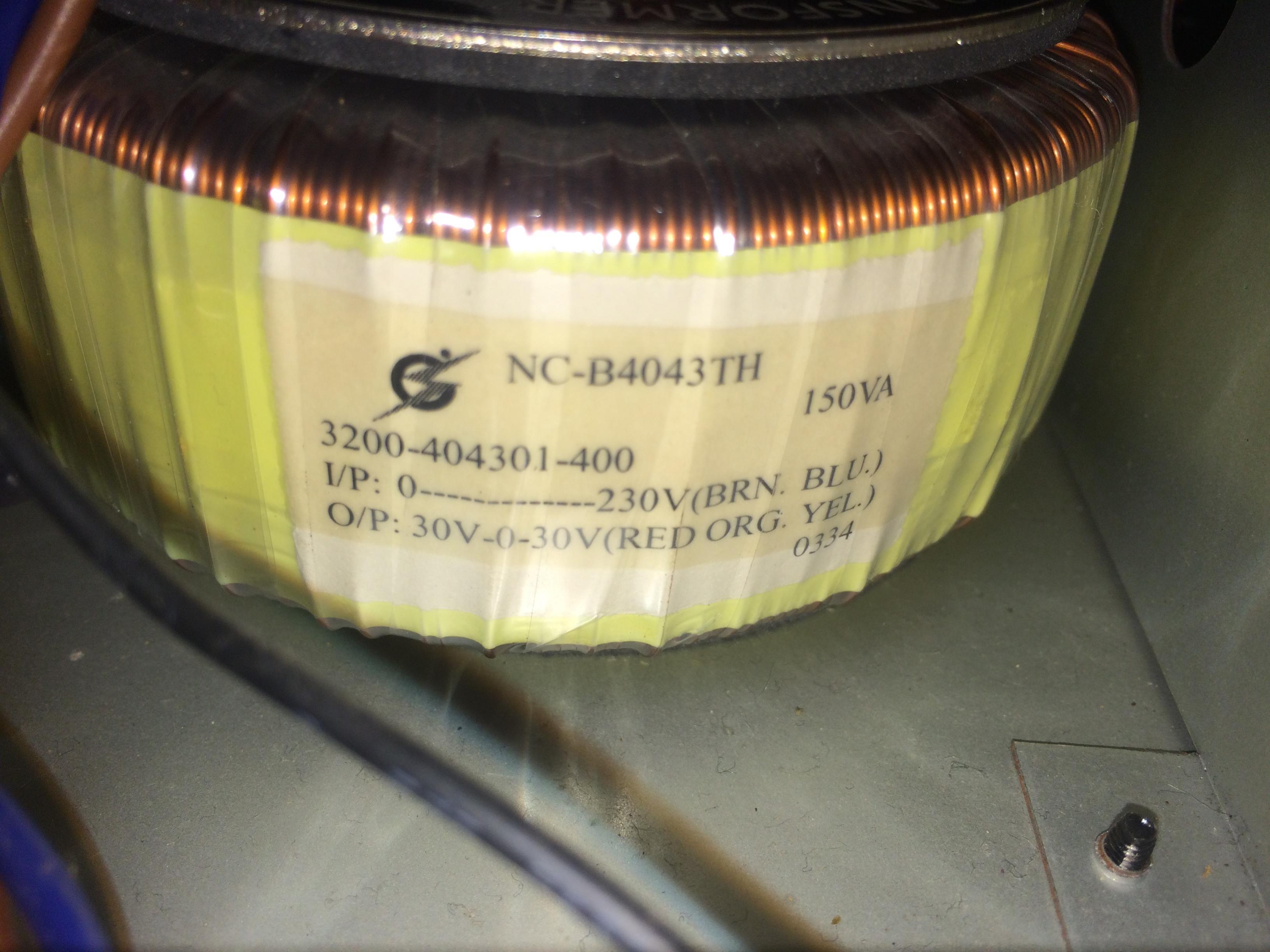

Oh, I remember you said the secondary fuses both blew and that the Mains fuse did not blow.
Secondaries were T4A?
What fuse is fitted in the primary? (bottom left corner) and pull the mains plug before you touch it !!!!
Without a soft start it cannot be close rated and will probably be either T1.6A or 2A
Does the external labeling give any clues?
If it hasn't already been mentioned then its worth checking the bridge rectifier for shorts.
I can make out 115v 4T in the first picture, can't deciper the one above but imagine its 2T.
the fuses are connected before the PSU.
You need to measure the DC at the PSU rather than at the fuses.
I suspect there are points where you can probe safely. Remember the black is already semi-permaently connected to one speaker Return terminal. You only have to be VERY carefull in placing the red probe to get a voltage reading.
Ok thanks Andrew. Are there any safe bets when probing a psu? Or any particular component to target?
It says 230v 50Hz T4A
115v 60Hz T2A
The primary is T2A
