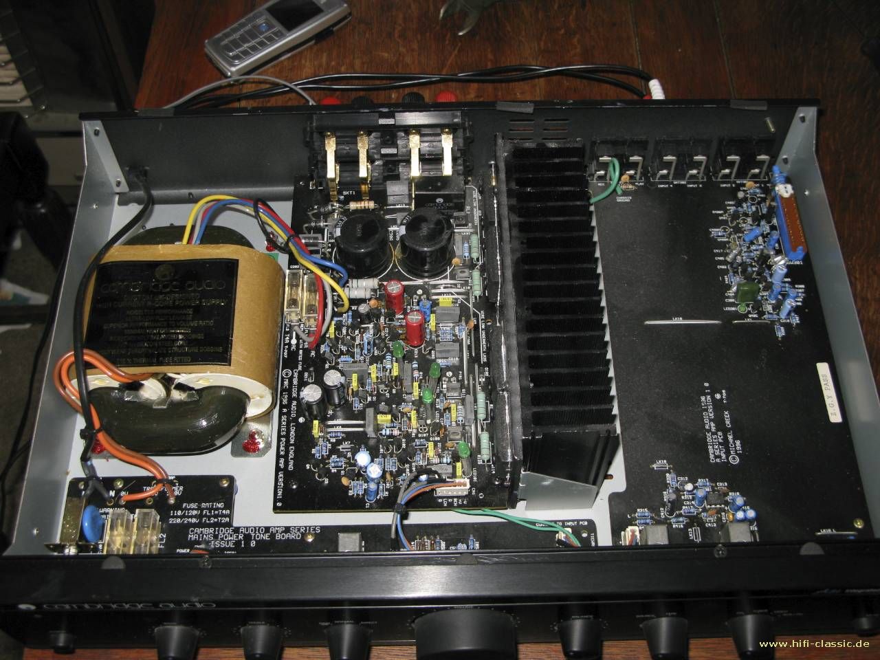

Back for a update...
Amplifier up and running
But one question, is it normal for the Q8/118 and Q10/110 to get hot (very hot) they are now about 15mm from the board.
It is running fine for the last 3 hours but I will keep my fingers crossed.
By the way the problem were the LEDs.
They were brand new but for some reason they would not alow the amp to work (they lit up) replaced them with other ones and it worked first time.

It is normal that they run hot. The reason is because Alex designed the amp for a lower voltage than was used by Cambridge Audio, so the BC639/640 transistors are running "on the edge" of their power handling.
If you can get and fit some TO-92 heatsinks to them, I think that might be worthwhile. Something like this

Hi everyone,
I bought a A3i in earlier this week, in very very good condition and no worries technical report, not unhappy!
Do not touch!
I come to you guys to know what is the value of the bias and from which component it should be taken.

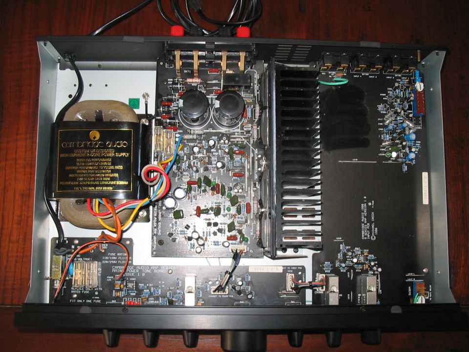

Hi All,
I got an old trusty A3i and would like to upgrade it as what Alex has suggested. I have received the schematics from Alex but on some of the recomendation, he did not specifically indicate the rectifier diodes that need to be change. SO I am not sure which of the diodes should I changed. Here is the list of parts to buy based on his recomendation. Any feedback and recomendation would be appreciated before I order these parts online. If I have listed the wrong parts, please correct me ( for the resistor change, is the one with 5% tolerence good enough for Audio? 1% tolerence are hard to come by:
For both performance and reliability:
1) All 4 LEDs replaced with a high temperature type green or yellow colour, lifted at least 15 mm from the PCB.
( LED Standard – 3mm/5V – Green = 4 unit )
2) Q10 (BC639) replaced with MJE243.
3) Q8 (BC640) replaced with MJE253.
4) Q11 (BD139) replaced with MJE243, mounted on top of Q13 (under one of its screws).
5) Q12 (BD140) replaced with MJE253, mounted on top of Q14 (under one of its screws).
Q11 and Q12 connected to the PCB by wires (either twisted or a bit of a "computer" flat cable)
( MJE243 = 2 units / MJE253 = 2 units)
6) D210 and D211 replaced with 10 Ohm 1W resistors
( 10 Ohm 1W Tol: 5% = 2 units : 5% tolenence is ok?)
7) The idle current is set for 85-90 mA (approx. 40 mV between emitters of Q13 and Q14) after a warm-up.

How do replace the Thermal Fuse within the Mains Transformer? Which Brand?
I have receive a death A3i. The reason therefore is a break thermal fuse (unfortunately not reversible version), fitted resp. mounted within the two coil bodies and the outer cladding for both coils of the R-core transformer. I short this fuse and introduce a new thermal fuse from Farnell close by the core:

A heating of the transformer with the new ones can not be determined, even after more than 2 days non stop operating. Thus the reason for failured thermal fuse must be that fuse itself (unknown, why, but perhaps too weak for the associated inrush current - datasheet neither from the transformer nor from this genuine thermal fuse available by Cambridge Audio)
Now the Questions:
1) Which model/type is the genuine thermal fuse
2) How I remove the genuine thermal fuse?
3) From what brand, series and type number is this transformer (this transformer type isn't custom made version - only the inscription from the the outer cladding so as the wanted secondary voltage is custom made) ??
4) Where I can order a complete mains transformer device as replacement part?

tiefbassuebertr ,
I have the transformer you are looking for in stock.
It is a dual primary for 120V/240V.

Dear tiefbassuebertr,
Bad news, I have been given the wrong information by my tech and the primary is 120V.
Really sorry for the false hope.
Is your transformer burned or is it only the thermal protection that is open?
I was looking at my transformer and it does not appear to be very difficult to replace, is it?

My transformer isn't burned as I already mentioned about post #152
I don't know, how difficult it is to replace the faulty thermal fuse (replace of completly transformer is very easy).
Therefore I want to introduce a second termal fuse inside of the transformer close by the secondary windings.
I have 3 Cambridge Audio A3i and none of them have the thermal fuse in the tranformer and never had any problems.
As far I know you can run the amp without them as long you don't overdrive it.

On the insulating label from transformer version of my A3i device I read at the end
"115 °C THERMAL FUSE FITTED"
- go to the first picture by post #152
What is to read by your devices?
