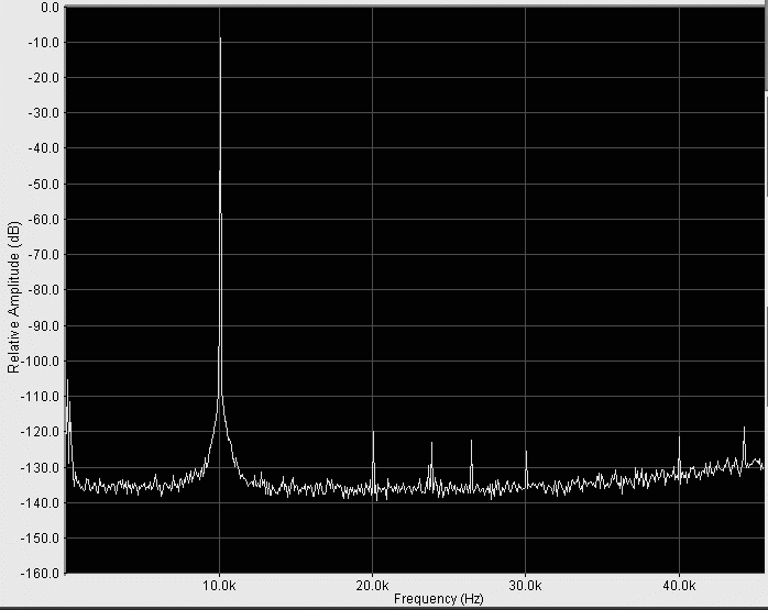

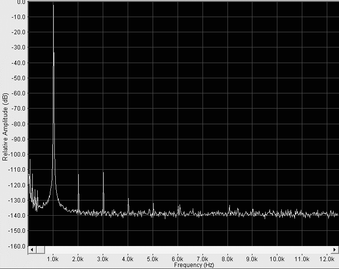

Another update.
After playing in LTSpice with A3i circuit I found an alternative way to compensate it, resulting in a substantial increase of OLG at high frequencies and better THD figures. Here are the results after I've tried the simulated network on a real A3i:
THD+N measured by Amber 3501 in 300 kHz measuring BW for full 50W into 8 Ohm are 0.006% for 10 kHz and for 0.008% for 20 kHz - . At lower frequencies or levels distortion are on the limit of my measuring equipment. Attached picture shows the spectrum of 10 kHz 10V RMS into 8 Ohm - in 48kHz bandwidth THD is 0.0004% .
Alex
Alex
