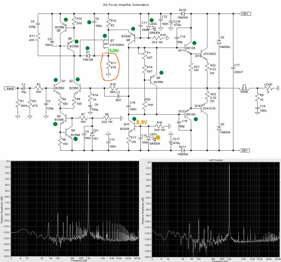

LED101 was dark. I have replaced it and its still dark.
Should I proceed by changing Q110 (BC639)?
well, Q110 got replaced, still no luck (light) ..
A PCB pic of the A3I

I got an A3I about a month ago, with a funny fault, of course, Q8 was dead, also Q7, Q1 and 2, their 100 Ohm resistors were gone
All replaced. LEDs too. All this on the RIGHT channel.
Left channel OK.
Now, what happens is that R11 gets hot in 2-3 secs after POWER on, 28,5 Volts
on it, and normally it is 4,99 - 5,01 V
All semiconductors checked, replaced. LED 1 and LED 2 checked.
Replaced.
On the same channel, RIGHT, LED 2 illuminates normally, LED 1 is somewhat dimmed, not bright enough.
Does somebody have a good clean copy or pic of the PCB, solder side, as I am beginning to suspect a wrong, broken, or shorted PCB trace on the RIGHT channel?

Just discovered this thread after my 18-yo A3i (literally) went pop and died on both channels. No fuses blown and LEDs still glowing.
Read through thread carefully and traced as best I could and appeared to have same problem as others. Replaced components as suggested by x-pro in #93 and it's now been working fine for 3-4 hours and sounding as good as it ever did.
There's a definite heat problem though - my PCB had a 50mm diameter darkened area around the trouble spot. Under one of the LEDs the track had lifted too so not sure how many more years this amp will keep going, but for £15 of components (sourced from Farnell/element14) it's far cheaper than shelling out for a new amp right now!
