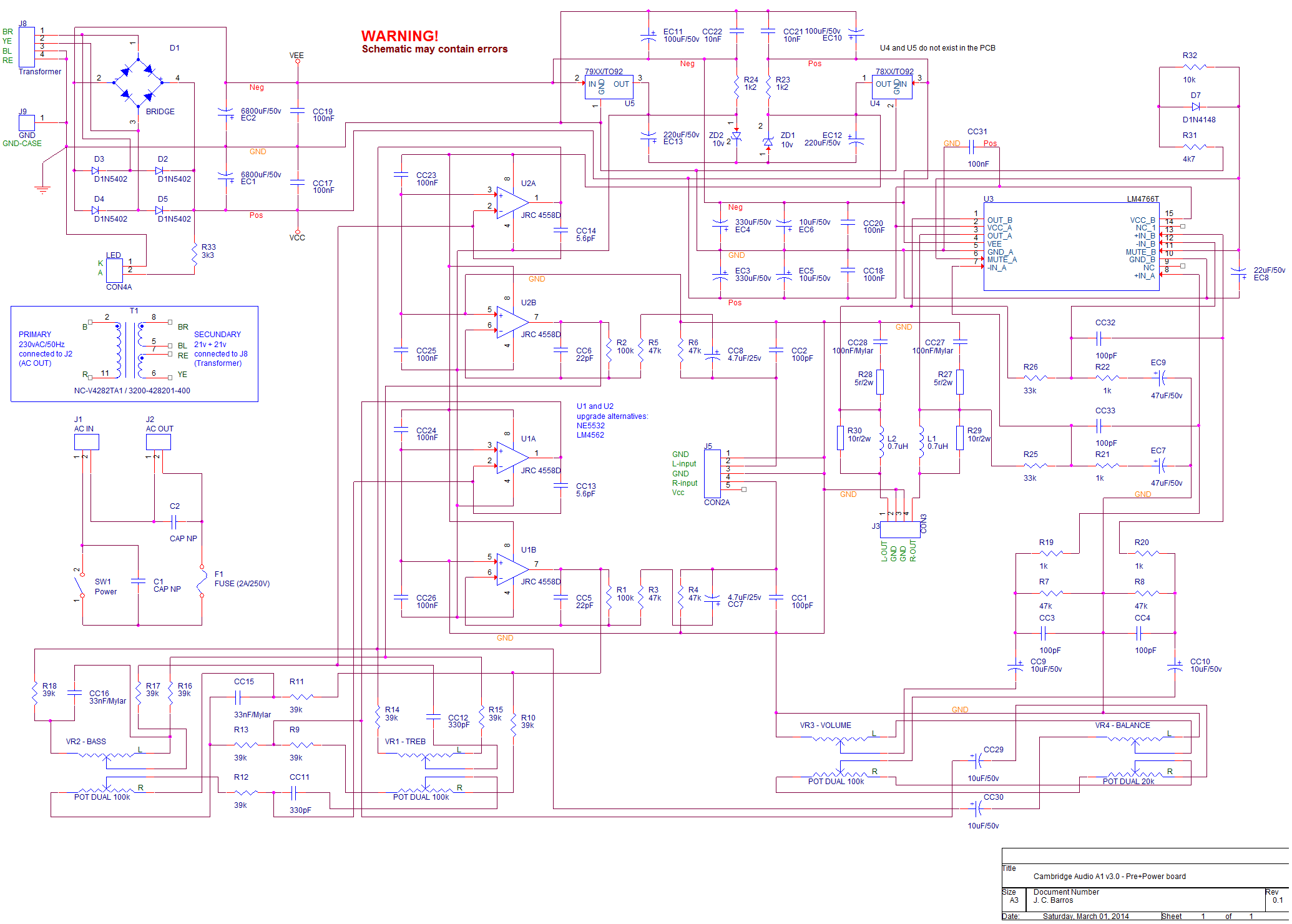

I bought a few months ago a Cambridge Audio A1 v3.0, the one with a single LM4766.
I've been modifying it... not always for better, because in the process some supposed improvements had to be undone.
When I started this, search the web for the schematic and always ended up in web pages were everybody else was looking for the same as me, and at most, found the schematic for other versions of the CA A1. So I've been drawing the schematic myself and I want to share it with you guys, in retribution for a lot I've learned by reading some posts in this forum.
The schematic is not error free, and is for now a 1st version of only the pre+amp PCB. I haven't removed the input board yet (the one with the RCAs and input selector), and I don't have the phono board.
You can find pictures of my CA A1 in my Flickr album
If anyone find errors, please be so kind to point them for me, so I can correct them. Anyone can share this in any way, but I assume no responsibility whatsoever for what you do with my shared knowledge, mistakes or ignorance 😛

Some guys will be very thankful for you efforts there, Montymore. Nice Going.

Sorry KatieandDad, but it's not.
The schematics there is for the versions "A1 - A1v2 - A1mk3 se - A2", as stated by Ian Finch, that have the two TDA1514, and not for the A1 v3.0 with a single LM4766.
Attached goes now my BOM, so far.
Some corrections done to the schematic so it goes to rev 0.2
I intend to redo the schematic with a component layout more friendly to understand the circuitry.
The present layout is as is because it was drawn mostly following the components location on the real PCB.
