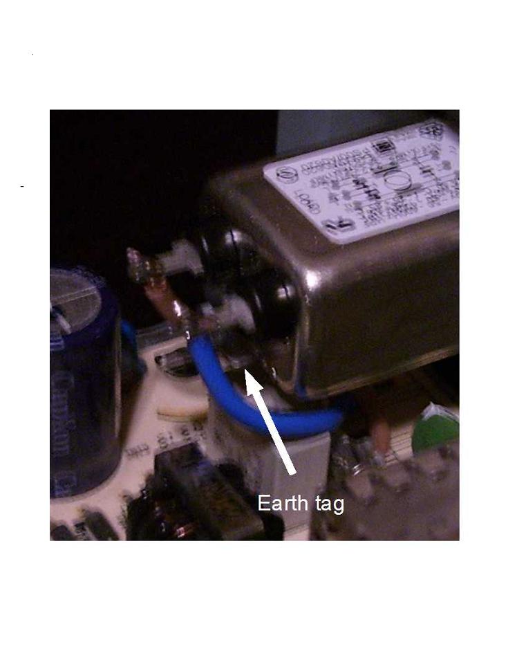

If the filter contains a coil, then it's best left out of the cd player.I also have some IEC's with built in filter, is this a good idea for a CD player?

Don't use any filters on the IEC (unless they are passive). Coils reduce the dynamics of the audio (more so on amps).

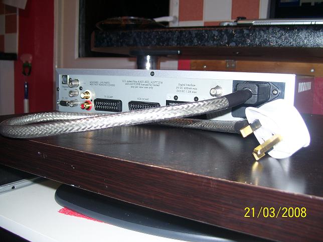

I fitted one to my sky box with a DIY mains cable made from Lapp CY and silver plated plugs. It improved the picture and when I listen to Planet Rock on Sky it does sound cleaner with less distortion.

Heres a piccy of my Lapp mains cable. It has a silver plated IEC plug from 'Mark Grant Cables'. At the time I took the pic I had a standard plug fitted, Ive since changed it to a Silver plated one from 'The Missing Link' it came with a silver plated Bussman fuse, nice.
I also made up 2 more cables for my CDP and Amp, and I rewired a decent quality extension block with the CY. All plugs are silver plated. Whole lot cost me about £75, bargain!
