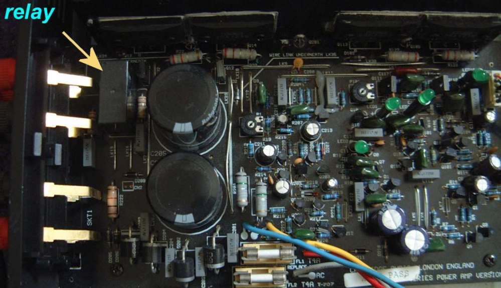

I got a CAMBRIDGE A3i from the car booty last week for £10. [I also got 2x 6metres of LINN K20 cable with LINN banana plugs for £3!!!]
…I didn’t really expect the amp to work but it was worth the gamble. As soon as I switched it on with nothing connected, it started clicking. I hooked up some mission 731’s & a cd player and it just kept cutting on & off from the outset, I got about 3 second bursts of music which sounded fine.
I put this down to the relay behind the big pots, I feel the pots may be the culprits, has anybody else had this problem? Any input would be gratefully accepted.

It's not a relay problem. The protection circuits are finding a fault. Don't bypass until you've found why the protection circuit's cutting!
Does the relay click in and out with the speakers disconnected? If so, remove the speakers and start measuring voltages with a VOM. First suspect is DC offset. Trace to the amplifier outputs BEFORE the relay and see if there's any DC voltage above 0.5V on any channel.

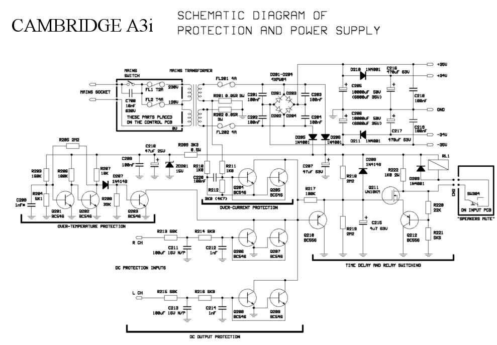

edit: check R201 and R202 if any are open or off-spec. It would cause the relay to chatter on and off, as the protection circuit would 'think' that the amplifiers are taking in too much power...

Also check C207 (?), 47uF. It may be failing.
Clem is right though. Never bypass a protection circuit. The relay is being turned on and off in this case.
Do you have the audio section schematic?

Dc Offset?
thanks for that guys,
yes it occurs when the speakers are disconnected too.
i read somewhere that replacing all the caps is a good idea anyway.
thats the only schematic i could find online.
now i'll try to do some swatting to understand dc offset

Can you check if one or more green LED's on the main amp PCB are blinking or going out when the relay clicks?

the 4 green leds on the main pcb & the one on the phono pcb are lit up constantly. i noticed the relay clicking when i pushed the mute switch,
Are they just used as resistors? do you have an A3i yourself?

any chance of a quckie tutorial on how to check dc offset etc. on the A3i? i only have basic elec. knowledge or even a full schematic so my friend can have a go

I've designed it.
I've sent you an email through the forum - and will send you the schematics tomorrow if you reply on this mail.

Measure from ground to each emitter resistor. If you get the wrong point you will only be a few mV off. The correct point is the junction of the two R22 resistors.

Come to think of it, if the relay stays on long enough, it may be possible to read any DC offset by simply sticking the VOM probes into the speaker output lines - do this for each channel...

The green LED's are the references for current sources. LED2 seems to be variable, so I could see it going out depending on the polarity of DC offset. Q7 will vary the voltage drop in R12 and thus the current through Q8.
I'm lazy and don't like to watch the meter. Stick a pair of meters to the junctions of the R22 resistors on each channel, ref to ground. When the relay clicks, have a look at the meters. Lazier still or for extreme intermittents. Solder a 10R 1/4W resistor to each junction as above to ground and let it sit. When DC offset occurs the resistor will burn out identifying the faulty channel. You could use two each with diodes in series opposite ways, thus giving you the polarity as well. I have done this from time to time on very intermittent units. It allows you to focus more in the area you need to look in. One burned both "polarity" resistors. Int. RF oscillation.

Sometimes an intermittent contact in one of the LED's results in a DC offset on the output, usually the LED goes off as well. It was a common problem on some early A3i's because LED's were soldered too close to the PCB. On the photo here these are on the right distance from the board thought.
2 Eggzy:
First thing would be to understand what part of the protection circuit switches off the relay. It could be a real fault or it could be that the protection circuit is in itself broken...
