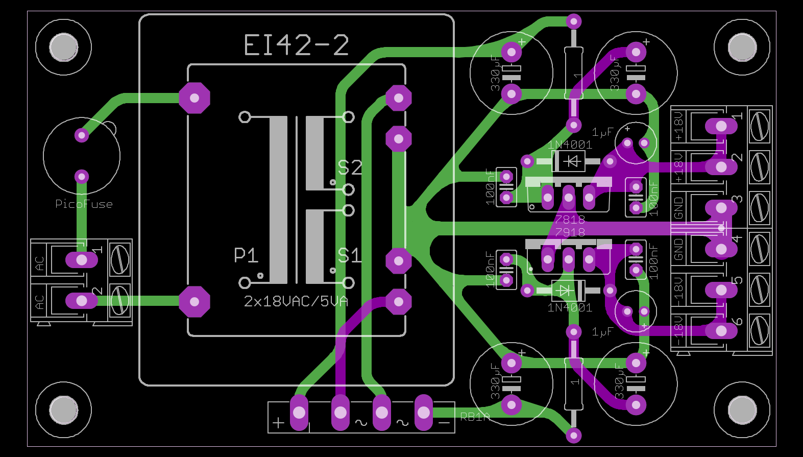

Almost 🙂 just a tiny bit more space between HV and LV (it is free 🙂)
P.s. drawing PCB using 'paint' is not as easy as it looks 😀

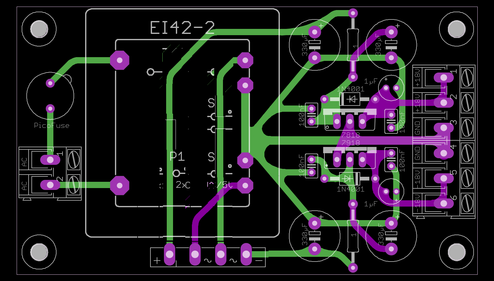

Gentlemen, thank you very much for all the advices it needed to do a "good" PSU for the CALVIN-buffer.
I have done some very slight, "cosmetic" modifications on my layout this morning:
- rotated the 7918 to be able to mount a small heatsink on the regulators
- adapted the bridge-rectifier to the one that my distributor has on stock
- used another output connector
I have already ordered 10 of these PCBs (size: 88x53mm, double-sided, 1.6mm FR4, 70µm copper). Two of them are reserved for my own, four of them for my best German DIY-friends, two for FdW
(if he still wants to have) - so there are 2 PCBs left. Does anybody of you want to have?

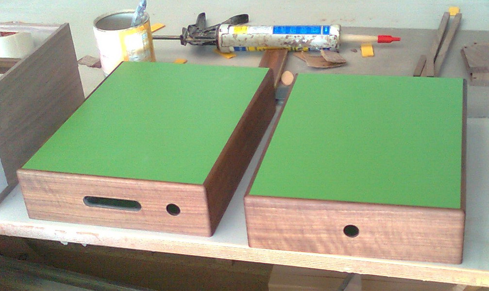

Hesener: I do not want to spoil your thread, and I want to tell you that I have the time now to go on with the build of a wooden case (thanks to Gerhard - the left case on the attached image),
housing your buffer, my buffer-PSU, my VCPre and Jean-Paul's DAC.
The case on the right is for a digital amplifier 🙂eek: : L15D) that sounds very, very beautifully!!
