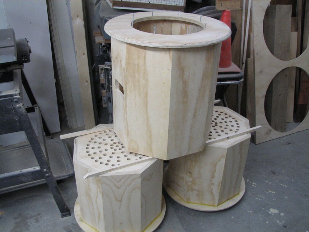

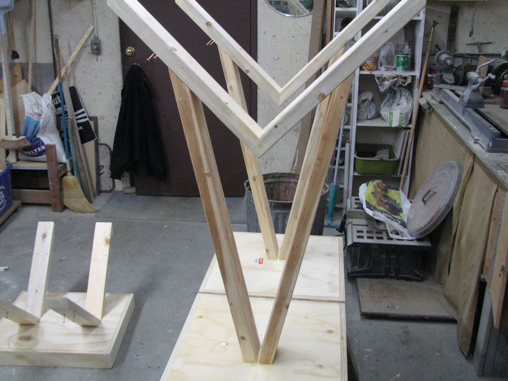

Oh well as they, you move on. I have a bigger and badder project to worry about. I am going to assemble these soon:
