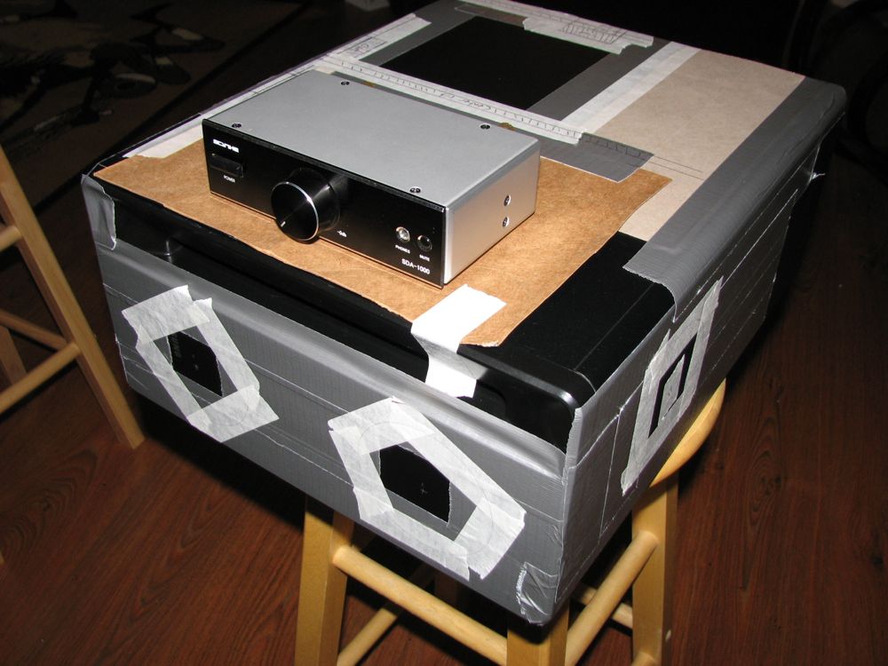

The first pic is the box all taped to protect from the saw. The little amp will be running four Jordan 6T's, two on the front and two on the sides.

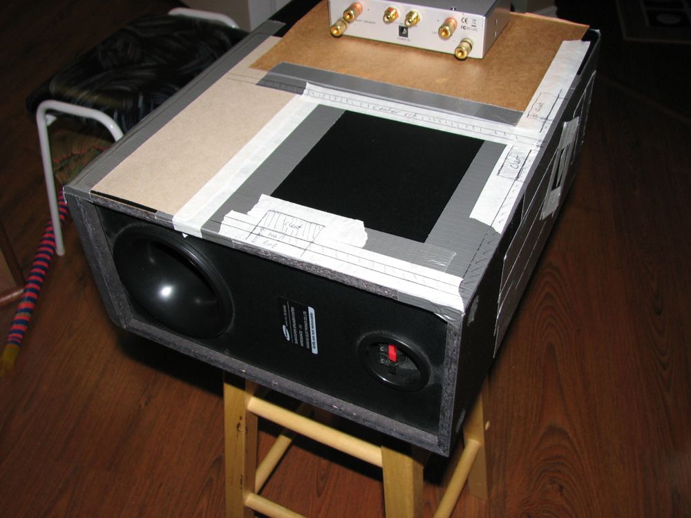

Second pic is from the back where the port and now unused speaker connectors along with the place on top where the small Dayton 25W plate amp will go. (on order)

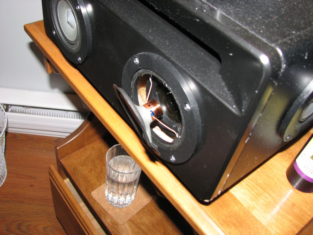

Third is the bottom mount for the woofer along with the drivers. I will be adding feet to the bottom to raise it an inch or so.

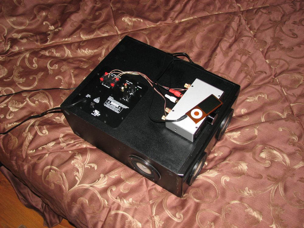

I learned a lot here and it was fun. Went from a DVD player to an iPod for source. It just seemed to make sense from the "spirit of the project" point of view.

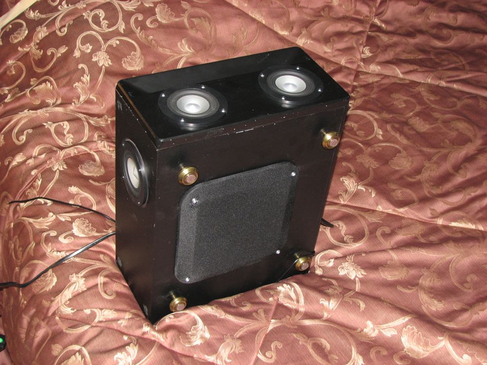

And in usual Cal style, the little thing cranks. I used the high level inputs on the plate amp as there are no line level on the little Kama Bay amp. The plate amp does not have a high pass so I tapped into the back of it and added 100ufd caps on the Jordan's. Although the Jordan's are not very sensitive, they still are loud enough to pi$$ off the neighbours. The 25 watt plate amp is more than enough. It goes boom boom real nice. :smash:
Still some clean-up to do but I've spent a couple days on this and I wanted to post as once again I'm a happy pappy.
