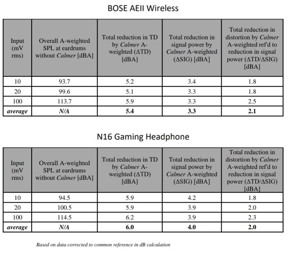

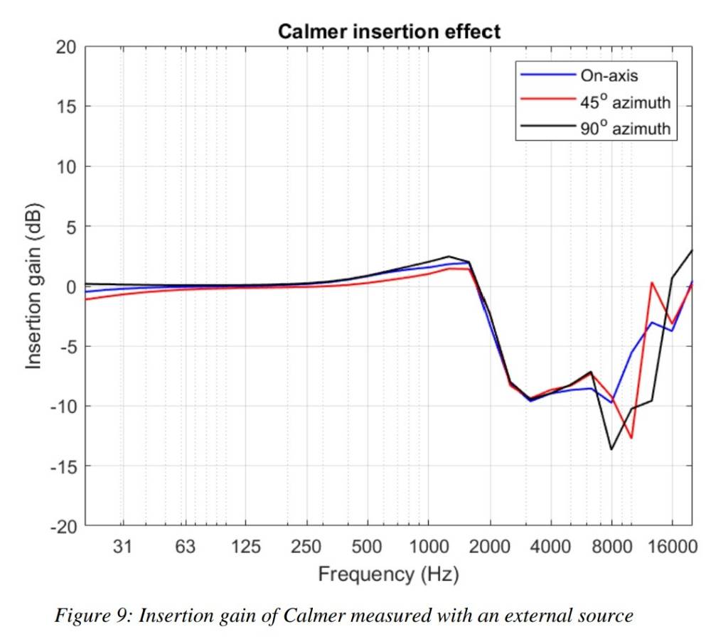

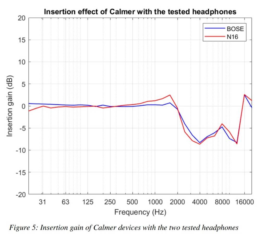

I see. 2dB less distortion. But they do seem to do a good job at reducing overall levels in the range of 2-8kHz, and at higher levels this may also contribute to perceived distortion.
Based on the results in this document, I think these might be worth trying after all... View attachment 860791 View attachment 860792 View attachment 860793
If you are happy to have the frequency response skewed beyond recognition, then it's 20 quid well spent, but would you buy an amplifier/CD player/speakers with a published 10dB dip in response which includes part of the critical midband? Do you have any particular need (medical or otherwise) to attenuate these frequencies or are you simply swayed by the marketing hype, and would you be able to hear a 2dB reduction in distortion at 100dB spl?
I have smellt (and complained about) a lot of marketing hype in the audio industry over the decades, and Flare Audio positively stink in my opinion...
