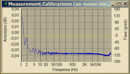

After trying for many days now to get Speakerworkshop to work I still don’t get much more out of it then bad calibration data.
I use Claudio’s tutorial http://www.claudionegro.com/ , gave up on Wallins jig and just soldered some cables exactly like Claudio has done.
I’m stuck on the channel difference calibration procedure and this is how his and my graph compare.
Soundcard is SBLive which should be able to handle the job.
Any help highly appreciated.
/Hugo

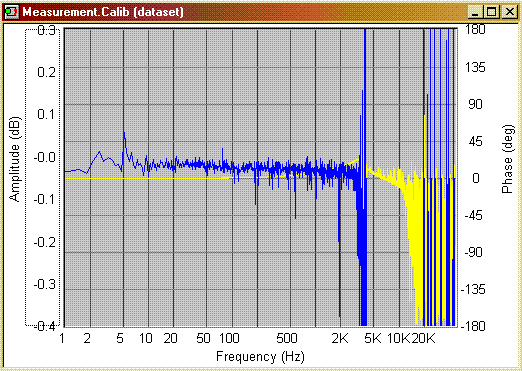

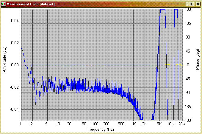

Sample rate is 48khz. Sample size is 256k.
I have set the recording level to 100% and the Master volume at about 60% which gives me about 15.2k in the VU meter. Sine wave looks fine.
Without touching anything, I try calibrating the channel difference and the graph now looks like the picture and VU meter is at 28k.
I managed to get a flat phase line with the Interchannel time delay settings...as a starter. 🙂
/Hugo

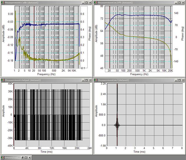

Here's another set of graphs that might shed some light.
I'm worried about the ‘measurement output’. I still need to familiarize myself with SW so I don't know how to interpret it but it sure looks distorted.
/Hugo
I haven't used SW for some time. The first thing we normally do is to use RMAA to test the card just to make sure it's okay. If you can get RMAA to test right, then your chances are better.
When you generate the fft, do you use "entire range"? or do you use a specific range.
What have you not muted in the Windosws master recording volume?
I've attached some stuff from my last calibration.
If you are planning to do acoustic testing, you know you will need to adjust the levels acordingly.
Thanks, I did the step by step procedure as described by Claudio.
Meanwhile, I reached the next steps like impedance calibration but they all show weird values like negative ohmic measurements.
I'll give it a rest for a while as I'm not able to get consistent results; a must for accurate measurements.
/Hugo
