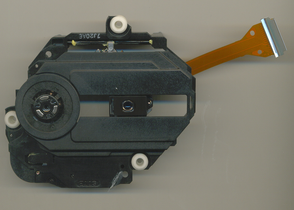

Do anyone know what is the part number of the laser in the California Audio Labs CD player model CL-15? It stopped working and need to change it. Thanks
according the image about
http://foto.audiohard.com/var/album...dio-Labs-CL-15-CD-player/520.jpg?m=1319311081
it is the CR2-Loader from Matsushita (maybe with RAE0113Z, mechanism+pickup).

Correct, it's a Matsushita RAE0113Z. Hard to find, but doable
A link to a sub # http://www.tesa.co.nz/cgi-bin/cgimain.exe?FORMNAME=PRODCAT&CODE=CDL263TD don't know if it's the same, looks OK
