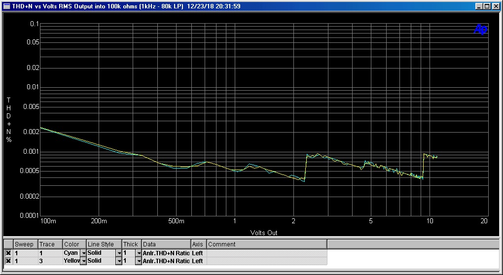

I have been using the System one for several weeks now and its been working great but has been giving me about 3 - 5 dB difference in THD measurements between channels. I figured a cal was probably in order. It took me several hours to figure out how to get the S1 cals operating in a DOS window. I needed to add that /i1 to the command line, or s1.exe /i1. I'm using Duke's APIB-LPT translator with a Win98SE laptop in case you were wondering. The cal's are fairly straight forward, easier than many pieces of equipment I've calibrated in the past. About the only anomaly I saw was that CMRR for the A input is about -92dB and the B input was able to get to about -104dB. Both are well below spec, but it would be nice to have both of them closer.

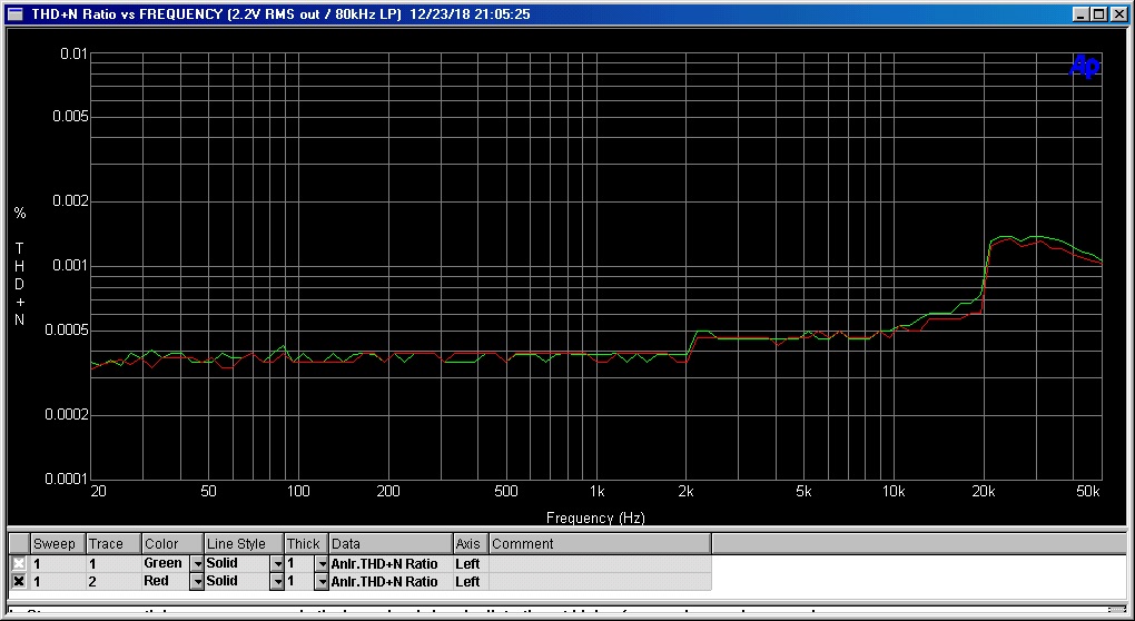

The performance that this old analyzer can achieve exceeded my expectations for sure. I had expected it to go to -102 to -103db based on what I had read online but I wasn't how much more was possible. I attached a chart of THD vs Freq of my unit in GenMon mode (loopback essentially) and a chart of THD vs Volts. Both are with the 80kHz LP active. These two tests had about 3 - 5 dB of difference at various points in the curves between the two channels before the calibration. They're reasonably consistent with each other after the cal. Needless to say I'm happy with the results. This unit is an early 90's model and appears to be 100% original. I'll probably recap the power supply eventually and I need to do something with that noisy fan (does anyone have any suggestions for a quiet replacement fan?), but other than that I'm not going to mess with it. :D

The CMRR is the match of the 1uf input caps and the light bulbs @ 20Hz. This is GOOD as it meets spec.
The THD vs Freq indicates that there may be a slight problem in the GEN or ANALYZER in the #4 band (22kHz to 204kHz) as the distortion is >0.001%

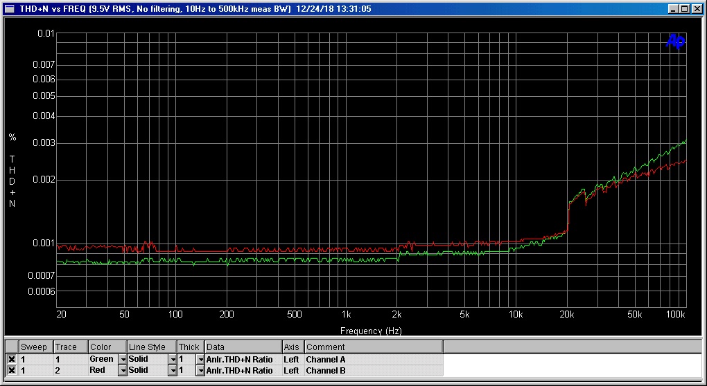

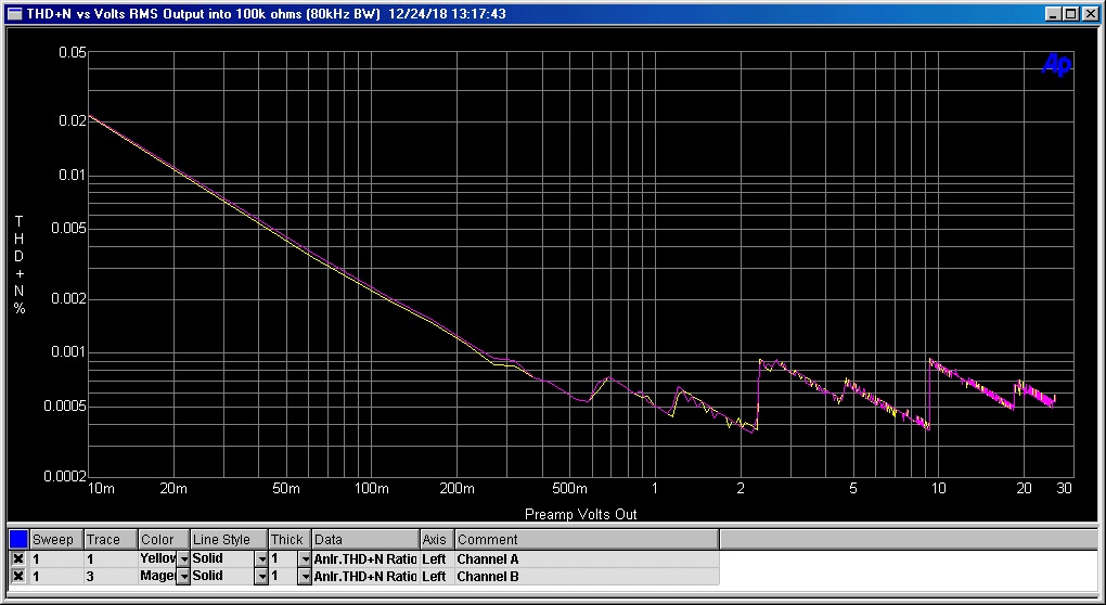

I had thought the the sudden distortion rise at 20kHz was abnormal, but the system check routine shows the high freq distortion to be well below the pass/fail red line so I thought it must be normal. I ran another pair of tests using 500 sample points this time. For this THD vs Freq test I disabled the bandwidth filtering, prior it was 22Hz - 80kHz, so these are 10Hz - 500kHz now and up to 100kHz signal. The THD vs Volts Out test is with a 1kHz signal.

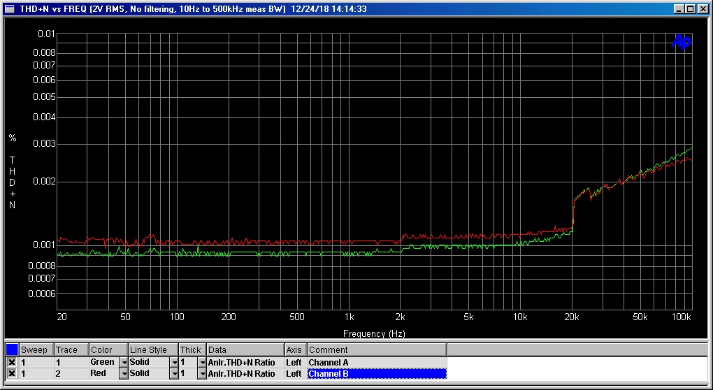

Run the FREQ vs THD @ 2 volts. Is it the same as 9.5 volts?
Duke
Hi Duke,
I attached the revised chart at 2V out. Its similar, distortion #'s are slightly higher and high freq dist at >80kHz is a bit closer between channels.
I performed a couple of the tests we spoke of over the phone. My 2nd analyzer reading the distortion of the AP generator and the AP analyzer measuring the distortion of the generator output from my 2nd analyzer's generator.
Observations,
The AP shows little difference when measuring the signal output of my 2nd generator. I varied the output of the 2nd generator sweeping from 19kHz to 23kHz back and forth and the distortion is fairly constant at -96.5dB +/-0.5dB when measured by the AP analyzer.
My 2nd analyzer shows a step in noise output from the AP generator when transitioning from 20k to 21kHz. That step is about 4 - 5dB with the 80kHz BW filter active and about 2 - 3dB with the system set for full bandwidth measurement.
So it appears that the large change in step noise at that frequency is coming from the AP generator.

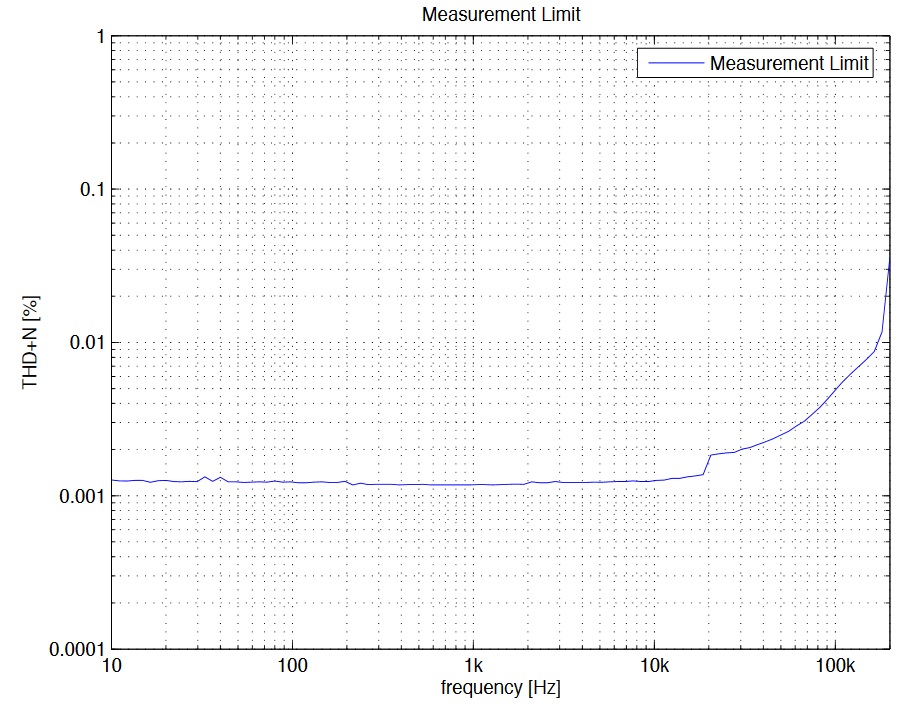

As is typically the case. I was looking at something totally unrelated and stumbled across a baseline of an AP System One. The attached image is taken from the OP AMP distortion article here which was written by Samuel Groner. He baselined his S1 for the testing and chronicled the results. This is a 500kHz BW measurement at 20dBu output from his S1.
This is not to imply this test is good ..... or bad for that matter. I'm just adding to the data.
