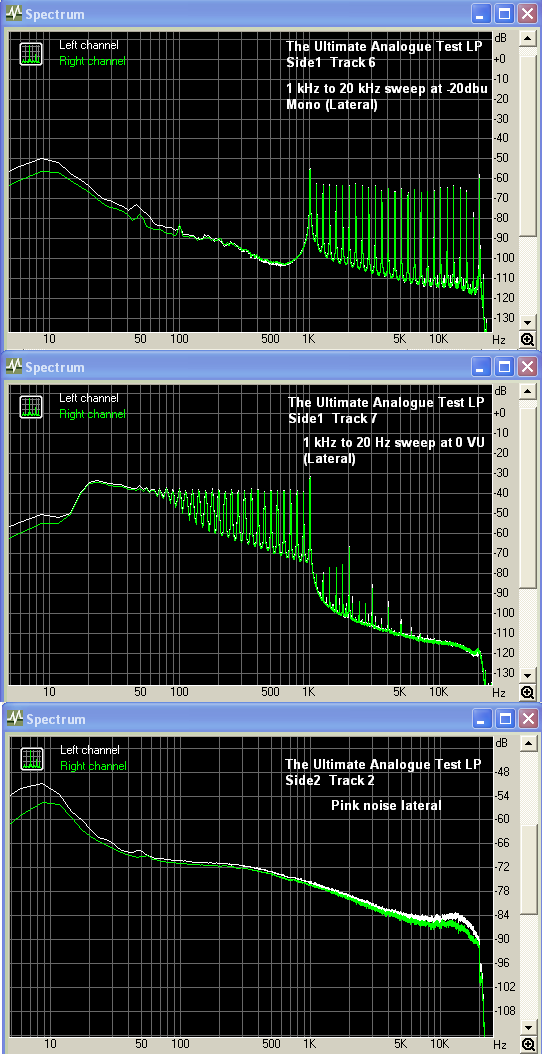

Side 1 Track 6 is the HF sweep
Track 6 1000Hz to 20000Hz sweep at -20dbu, Mono (Lateral)
Side 1 Track 7 is the LF sweep
Track 7 1000Hz to 20 Hz sweep at 0 VU (Lateral)
The FFTs are from this test LP using my TD160 MKII / SME3009 Improved / Denon DL-103, all modified)
George
For the cost of that record having a 20dB difference between LF and HF seems a bit of a drag. your attachments don't zoom up very much but is there 6dB level difference between 1Khz and he rest of the sweep?
Also the pink noise doesn't look pink, do you know what that is?
Bill
I thought you would have understood it. I only show what the tracks are for your convenience.
I am not promoting that LP
Track 6 and track 7 are two different tracks with different signal levels for a reason.
But each track has the 1KHz tone as it’s local level reference.
When using a voltmeter or an oscilloscope at the output of a RIAA preamplifier, the 1KHz on each track reads the same amplitude as it’s neighbor frequencies, but the length of the 1KHz recording is longer (for giving time to set the metering device), therefore due to this longer time, the 1KHz FFT peak is higher than the rest of the frequencies.
For the same reason, on track 6 the 20KHz FFT peak is higher than the rest of the HF peaks.
The content of all test LPs were not meant to be monitored through an FFT but either through ear, voltmeter or an oscilloscope (and for resonance test tracks through naked eye).

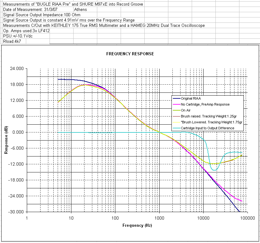

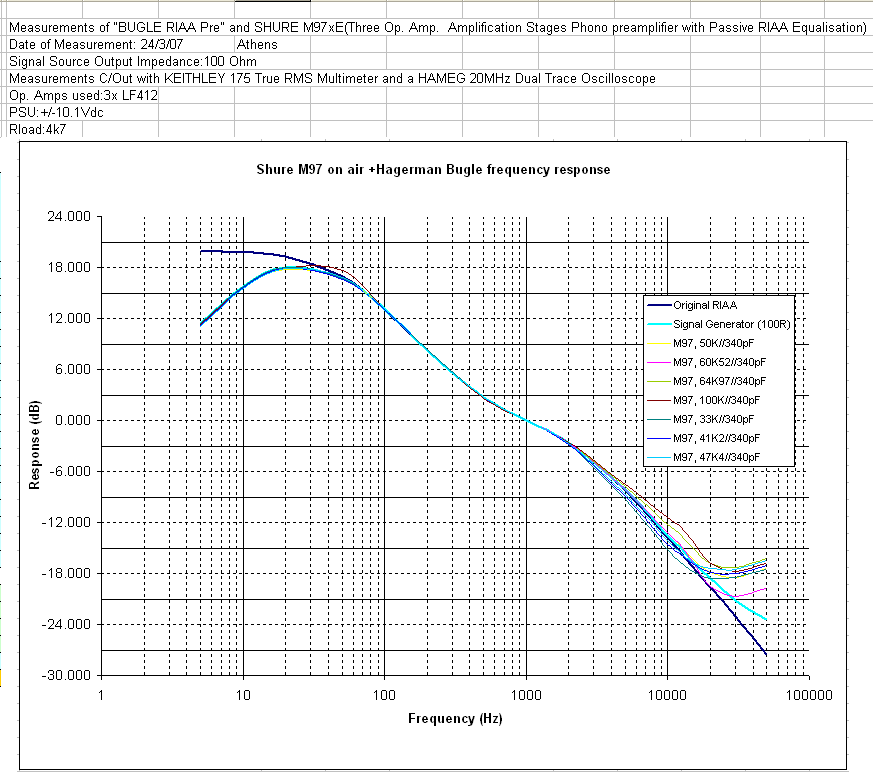

If your needs are only for accurate frequency response testing, the purchase of a test record is not the only (nor the best IMO) choise
By wiring in series to the RIAA preamplifier the cartridge and a signal generator of low Ro (*) and of mV output, you can have freq response measurements far more precise that you can achieve with the best test LP.
Of course you don’t test the effects of the mechanical parts of the cartridge (tip, cantilever), only the generator.
Effect of interconnects, R, C cartridge loading, RIAA eq accuracy, preamplifier overload behavior, you can test all these.
You can even study the electrical resonance of the cartridge by measuring the voltage drop across the coil.
(*) If you make a low Ro buffer, you can use your soundcard with an applicable SW on the PC as the generator and do all kind of checks (spot freq checks, sinusoidal log sweeps, pink, white noise excitation ect).

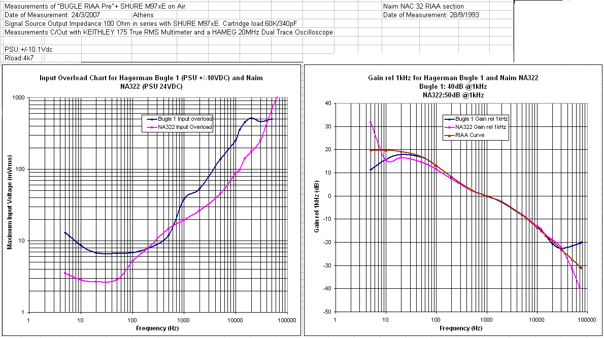

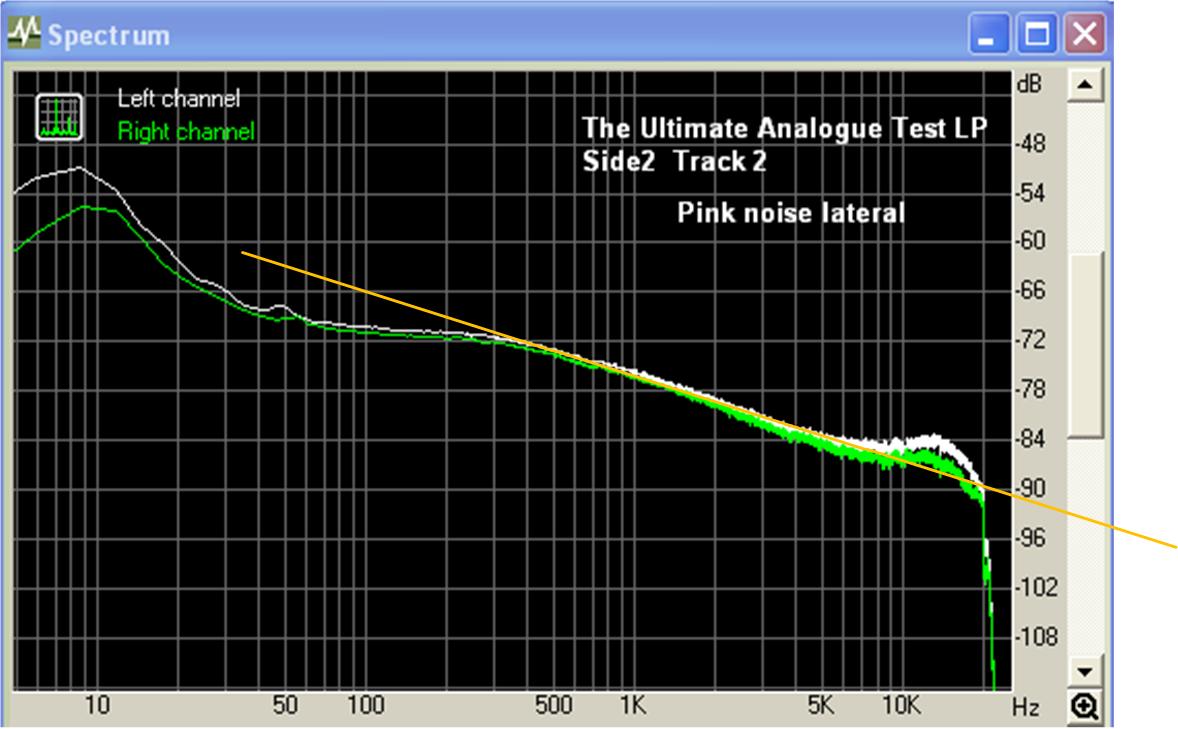

I had a look at George's pink noise plot again and put a 1/f line over the top. The HF part seems to track the sweep FFT nicely, but not sure what is happening between 100 and 300 Hz. Is this real or just a function of the maths?
