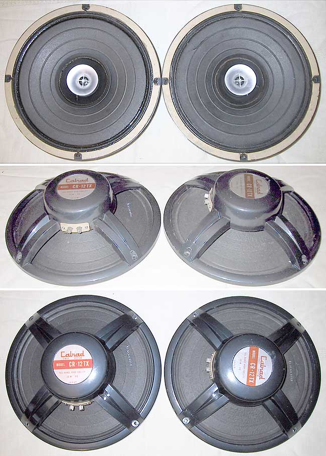

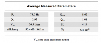

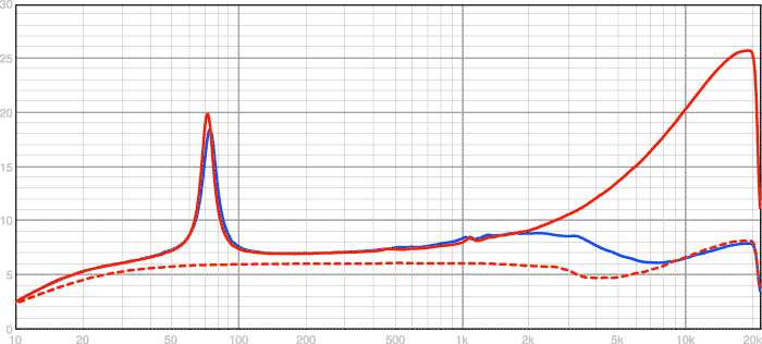

I did a little digging. mine were CR12TX, looking very similar but with a coaxial tweeter as well as a whizzer.
From the dates on the puter i may have T/S, have to go to my other computer to check that.
dave
