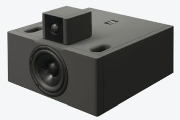

I'm sure the Strauss speakers might be pretty decent, but their website is just full of marketing BS. What they write about passive / active is especially stupid and largely made up to make their products seem the only reasonable ones.
Lots of other variables, but little to do with the simplistic ways the surely very serious Jürgen Strauss has his marketing people try to convince us of.

I've already tried vituix, that software gave me the length for about 50cm for 2 vents of 19.1cm2 each, one Driver: 15W8531, fB=39Hz, SBB4,VB=15L (about), Where can I find k for the vents for different geometry (correction factor or how you call it)? Already the baffle diffraction seem to be very primitive.

If anyone want to know what I understand under "professional speaker development" then read the white paper LS50 (link markbakk Page 1 on this thread).
Quite novel; it's like a class A amplifier had sex with a horizontal ATX case and a woofer 🤣
I'd stop listening to your friend and build one of the DXT-Mon variants

What is your result for the length of the vents for the given parameter? You can also calc it here, it's the same result as in vituix: http://www.mh-audio.nl/Calculators/WVC.html#infoMaybe read the manual first and see what kind of tool you are using before sounding off. And yeah, surely everyone's going to read some white paper just in order to understand your thinking 😏

Possible, hardly. The concept of any 5”-1” has its limitations. How good the modified (…) 15W may be, it still suffers from surround resonances. The motor system is quite good, but if you allow this driver to make big excursions to bring enough SPL, the midrange IS compromised. I wonder if the directivity of this design is that well controlled and I know that if you put a tweeter in a box like that, it ruins your sound power vs sound pressure level balance, because of steep directivity changes. Been there done that. The length of the vents: I really don’t care. A passive radiator would have been a far wiser choice because of port resonances (see the LS50 paper). I can think of a few other aspects (driver decoupling and other measures to keep the cabinet resonances down for instance). So all I think I see is a flawed design.
[Edit] Threw the 15W in a sim (Basta!). A good alignment would be a 13l enclosure with a vent 50mm diameter and 200mm long. Giving you a nice port resonance at 850Hz...
