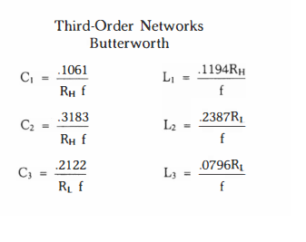

You can get the textbook 3rd order Butterworth formulas from any decent text on filter design. From LDC 7 (Vance Dickason) attached.

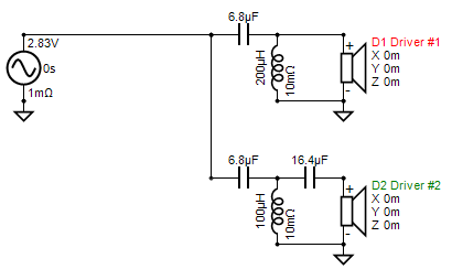

Here is the schematic of example.
Thank you for the textbook's formulas. What was in the question is the electrical response of the filter, to my understanding. Those formulas you provided are useful when designing the filter. However, the objective of my question was about the inversion of the formulas.
For instance, regarding the schematics:
Second-order filter
Crossover frequency: f = 1/(2 x pi x sqrt(0.2 x 6.8)) = 4,316 Hz
Q value: Q = sqrt(6.8 x 3.2^2/0.2) = 0.59
Third-order filter
Crossover frequency: f = ?
Q value: Q = ?

In the Laplace domain, an ideal inductor with inductance L has an impedance sL and an ideal capacitor with capacitance C has an impedance 1/(sC), where s is the Laplace variable. (Depending on the kind of calculation you want to do, you can also interpret it as j omega or as the Heaviside differentiation-to-time operator.)
Knowing this, you can use the equations for series and parallel connections and for voltage dividers to calculate the transfer function of the filter. For your high-pass, it will be some constant times s3 in the numerator and a third-order polynomial in s in the denominator.
You can now equate the denominator to zero and solve s to calculate the poles of the filter. That boils down to solving a cubic equation, how that can be done is explained on Wikipedia.
You will probably find a negative real pole and a complex pole pair with a negative real part, although you might also find three negative real poles. By definition, the natural frequency of the complex pole pair is
fn = √((Re(s))2 + (Im(s))2)/(2π)
and its quality factor is
Q = -√((Re(s))2 + (Im(s))2)/(2 Re(s))
That and the position of the real pole define the response shape.

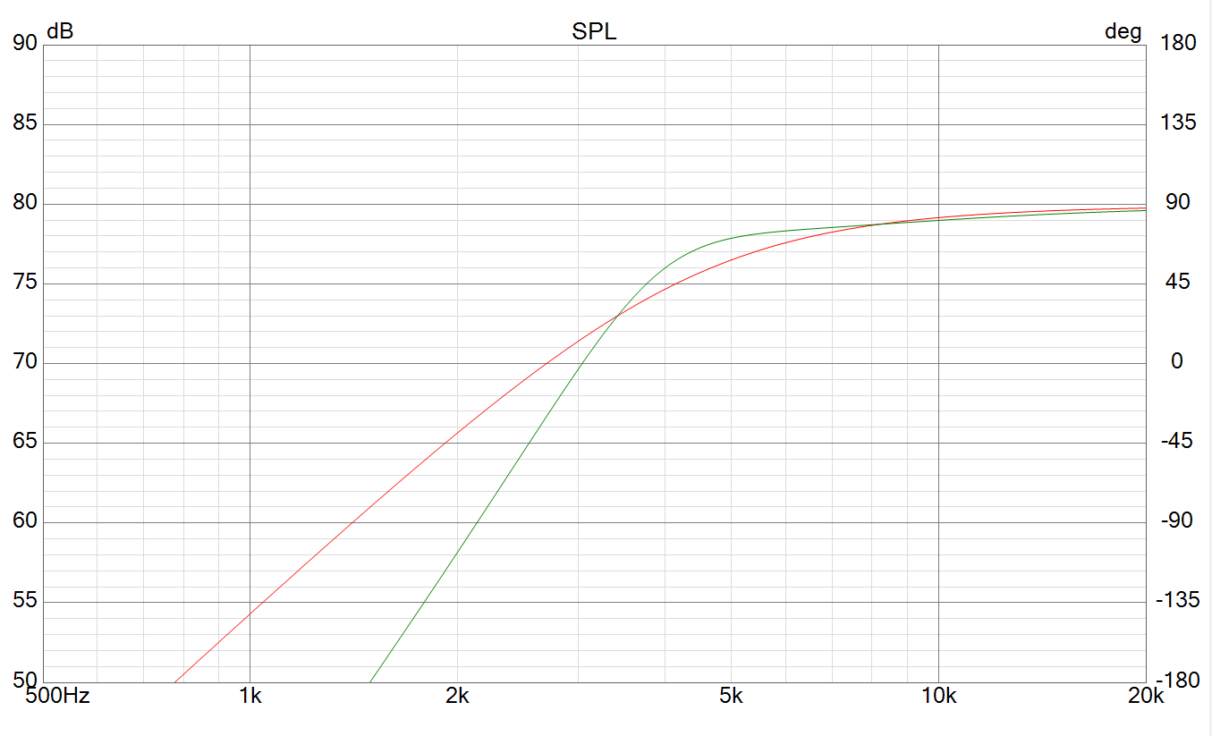

Furthermore, if we consider the graph of amplitude we obtain from measurements, how can we recognize the type/ characteristics of the slope so as to indicating the crossover point?
For example, consider the green curve on post #3, the third-order response, which type of slope; CC, BW, BS, or LR, to indicate the crossover point?
For Chebyshev, the cut-off frequency is often taken to be the frequency where the response starts to deviate more than allowed by the ripple specification. For example, where the response starts to deviate more than 0.1 dB for a 0.1 dB Chebyshev filter.
Regarding recognizing filter responses: pretty much in the same way as bird watchers recognize the species of bird they are watching: look at the filter magnitude and group delay responses very carefully and compare them with theoretical filter responses in a filter synthesis handbook. For example, a Chebyshev filter has passband ripple, so when your filter has a monotonic response, it cannot be a Chebyshev filter. Linkwitz-Riley filters are only defined for even order, so an odd-order filter cannot be Linkwitz-Riley. If the magnitude reponse is monotonic and quite flat, it could well be an optimally flat magnitude filter, a.k.a. Butterworth filter. The only problem is that there are infinitely many responses that don't quite fit with any of the ideal responses.
