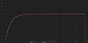

I tried several values of R1 keeping R2 as 1k. I used a 4.7k and then a 6.65k in series with a 5k pot for the R1 in the divider and made several measurements from ~12k from R1 max to 4.7 as R1 min. All of those measured the same within a small fraction of a dB so here is the result. Light green trace was with the 8 ohm/1 ohm divider and the pink trace was with 6.65k and 1k:
All of the measurements had around .12dB of rolloff at 20k. Also noticed that the low end below 20Hz had slightly more rolloff than the 8ohm/1ohm divider.
I went with a higher value R1 than 5k because I tested the AVR with a dummy load and a scope and got clean peak voltages of 46V into 8 ohms so I was afraid to rely on a 1/4W 5k pot for that. It turned out that I didn't need to load the power amp on the AVR with a 100 ohm 10W resistor. Distortion numbers were under .1% at normal listening levels. Everything is hooked up and works fine.

You appeared to be complaining that we had not offered information which you had not asked for (frequency response), and for which we had not been given sufficient context (long cables) which would alert us to the fact that you actually did need this information. We were not complaining about your experiments, but the comment accompanying your experiments.
It is the classic problem of the expert talking to the non-expert: if you tell him something he already knows you are accused of being patronising or treating him like an idiot; if you don't tell him something he doesn't know then he complains "how was I supposed to know that?".
The formula you need is f = 1/( 2 pi C R), where R is the output resistance and C is the cable capacitance. This gives the -3dB corner frequency of the low pass filter.
