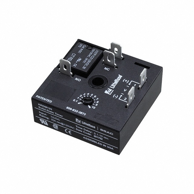

There are also time delay relays that can be used on mains voltage without the need for an additional power supply.so i guess i could inrush current limited the transformer and use 5V from a secondary to power on the relay,
https://www.mouser.com/c/electromec...-relays-accessories/time-delay-timing-relays/

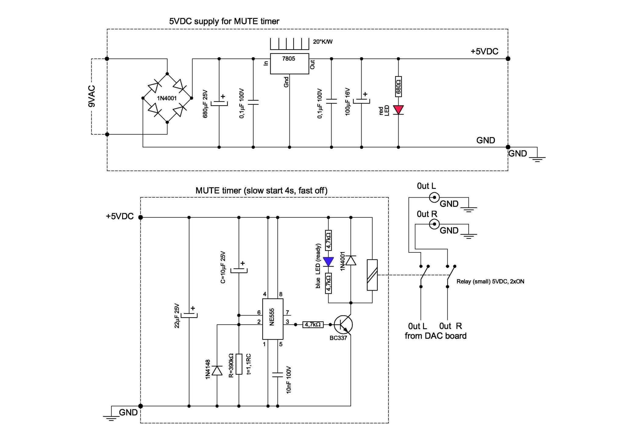

A few that I know use this circuit. The retention time is about 2s. You can extend that time if you put larger electrolytes than 2x470uF, say 2x1000uF or 2x1500uF. I would also add another 10ohm resistor, to make them 5x10ohm and reduce the starting current a little more. One company that makes transformers in our country also sells this type of assembly. I don't really like that little relay there and thin leads on the PCB . A resistor should be added to the line with the relay coil in order to set the voltage on coil to be close to 24VDC.

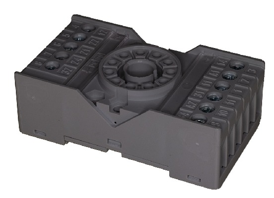

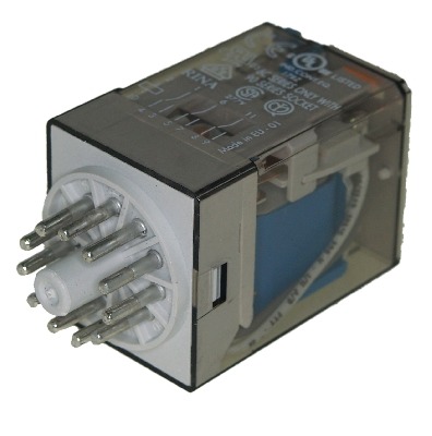

ah never saw these but i guess its industry style stuffAnd the relay is like this (oktal socket, I had a few pieces of that 😏 ).

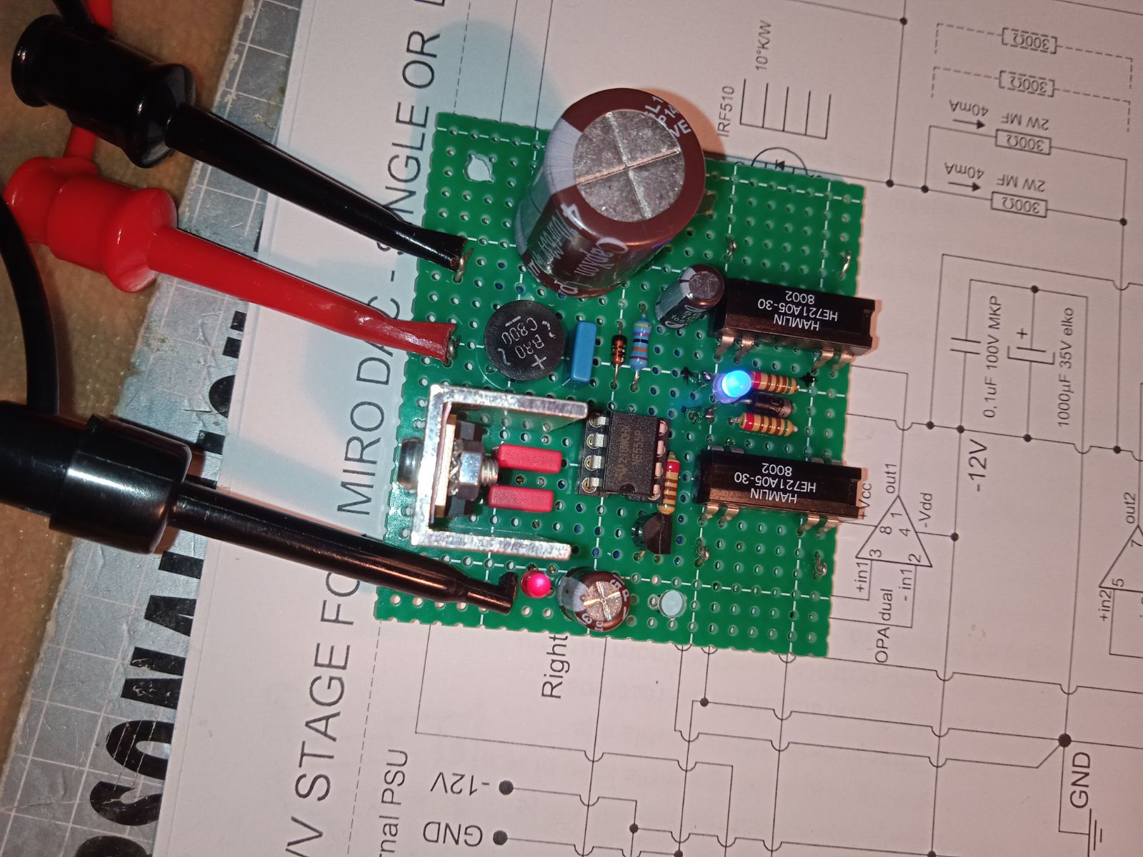

3 seconds is enough, during that time the transient phenomenon is over. The voltage on the relay coil and time depends on the resistance of the coil, that's why I don't like that schematic. Put a bigger relay with lower coil resistance and the voltage will be too low. It can be adjusted with elements in front of the diode bridge, but I say it is not flexible at all.
The real thing is a small print transformer 5VA /13-15VAC, 7812, NE555 and strong relay 12VDC.
ah nice, thank you yea that would do the trick too, i might play around with a microcontroller to blink the power button led while the delay is running or something along the lines, i have to see what i can come up with 😀
