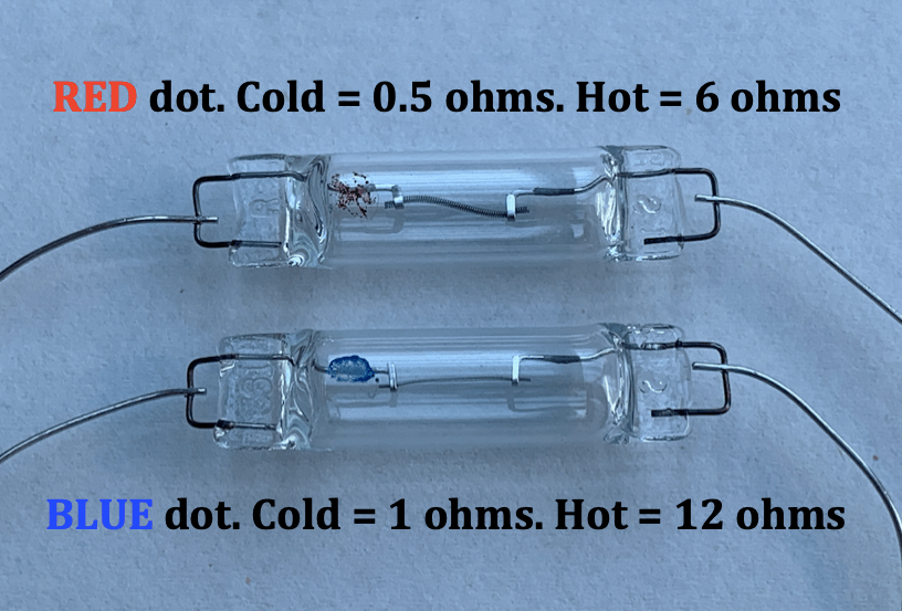

Current speakers (PA and domestic) use 'SK3 type' protection lamps rated at 12.8 V.
Most use RED dot lamps.
However, a BLUE dot gives more protection as explained in this ebay listing:

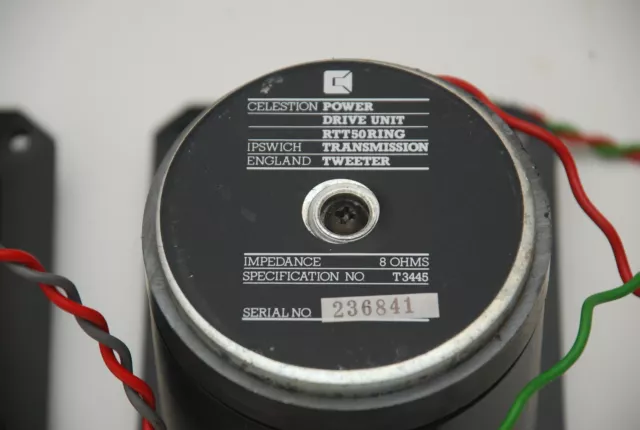

The speakers appear to be self-built. They contain a CRAAFT 12/250 SD 8 Ohm chassis and a Celestion RTT50 Reing Tweeter 8 Ohm. A light bulb is connected in series in front of the tweeter.

Now that we know that a single lamp is used for tweeter protection, I'd go with the BLUE dot protection lamp illustrated in post #2.

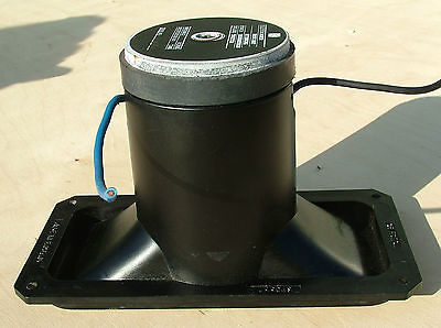

Just because I can, I'm illustrating the Celestion RTT50 Ring Transmission tweeter, 8 ohm.
This would appear to be a decades old driver that Celestion rated at 25 watts RMS.
I wonder if its high pass crossover is in good condition?
Perhaps there is an out of spec bipolar electrolytic capacitor that could do with replacing?

The blue lamp draws would provide about -8dB attenuation when hot, the red around -5dB, only half the attenuation.Now that we know that a single lamp is used for tweeter protection, I'd go with the BLUE dot protection lamp illustrated in post #2.
The blue would burn up (fuse) at half the power of the red, somewhere above 14 volts. The red would probably not fuse before a tweeter rated for 25 watts RMS would.
I've had a single burst of feedback burn the fuse out in EV S-40 speakers.
The blue fuse/lamp is cheaper than tweeter diaphragms, though never blew any of the S40 tweeters after we bypassed them.
