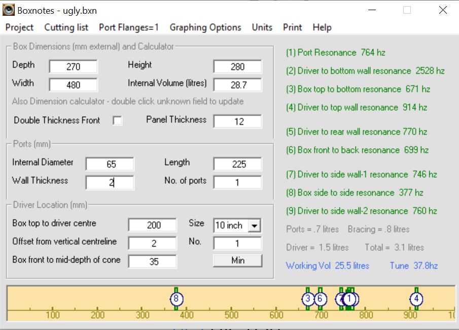

To answer the second part of your question: I use Boxnotes to reverse engineer the cabinets I break. It contains standard deductions for calculating internal volumes, taking into account: drivers & ports. Note the resonant frequencies the damping material is attempting to combat.
