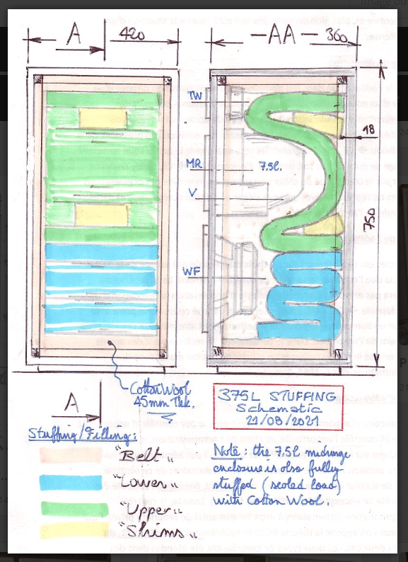

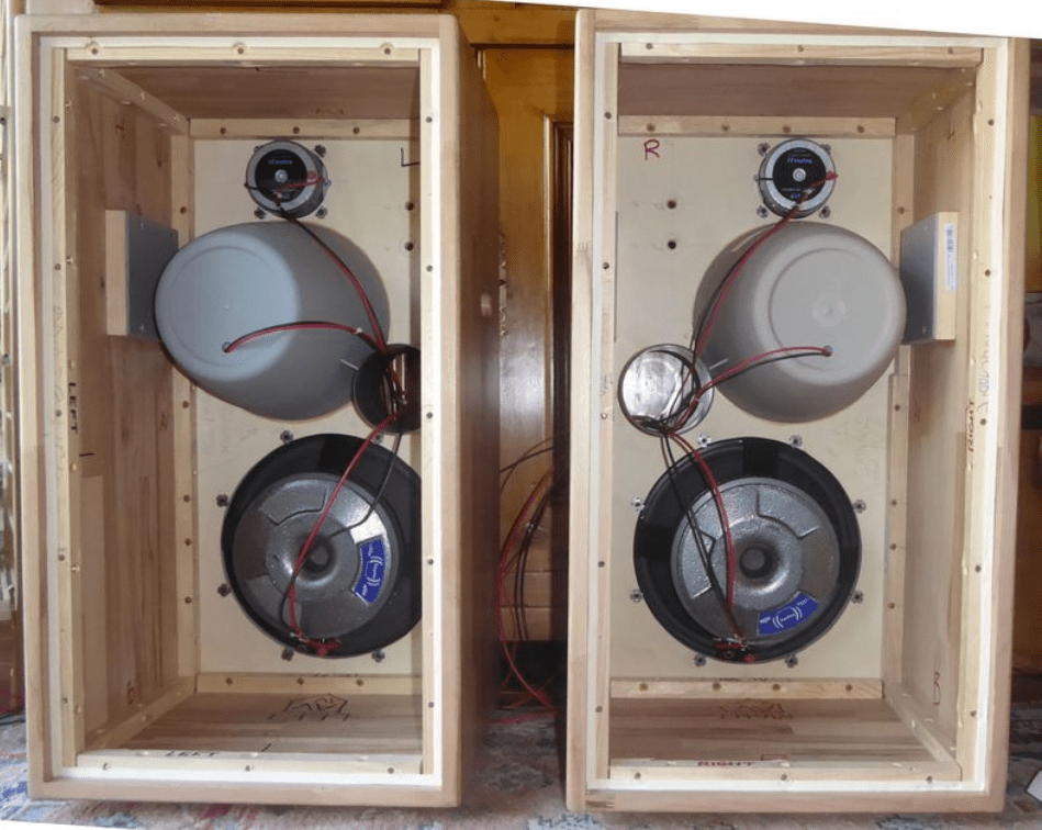

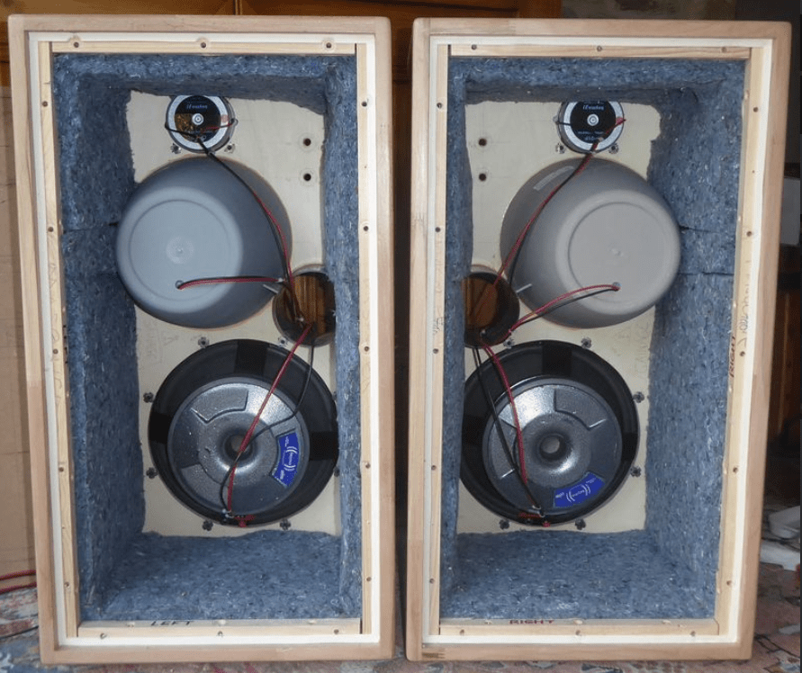

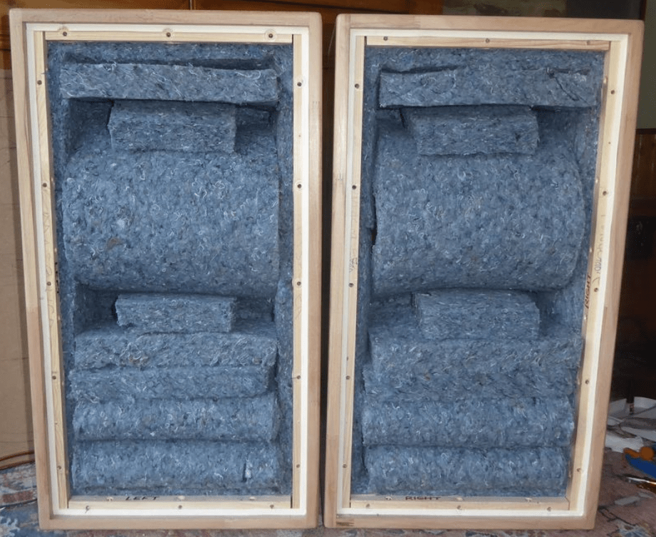

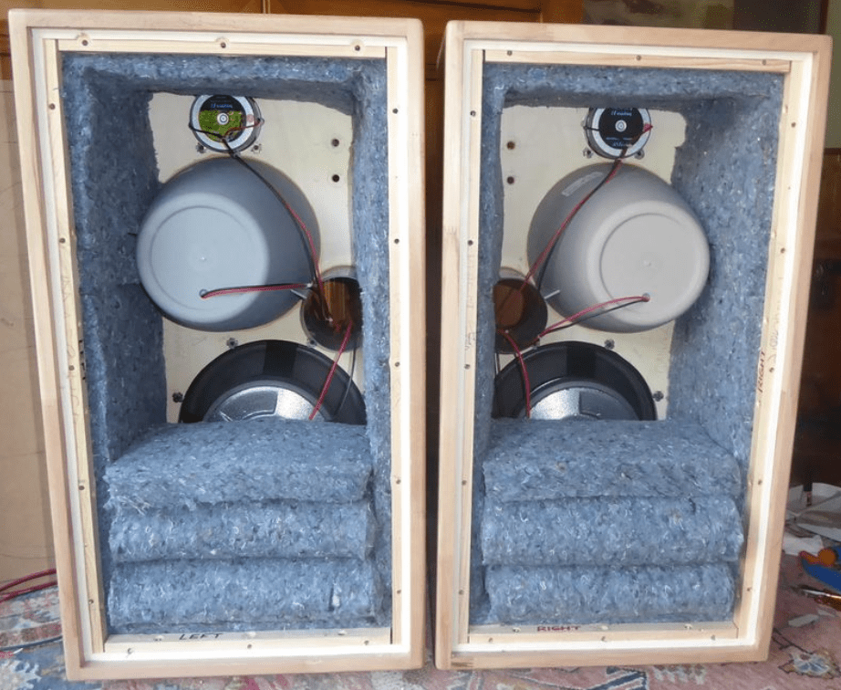

Here's what I did in my HERESY I for a 100% filling with Cotton Wool - some will say Sacrilège, I know, but the tone improvement in the midrange / bass-midrange is obvious...
But it's me, OK ? 🙂 😉

Actually the level of acoustic internal material and packing style you use reminds me of how my Focal Electra speakers are assembled. I think Focal may subscribe to a similar viewpoint as you. Thanks again for the very nicely detailed replies.Here's what I did in my HERESY I for a 100% filling with Cotton Wool - some will say Sacrilège, I know, but the tone improvement in the midrange / bass-midrange is obvious...
